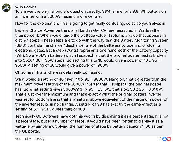

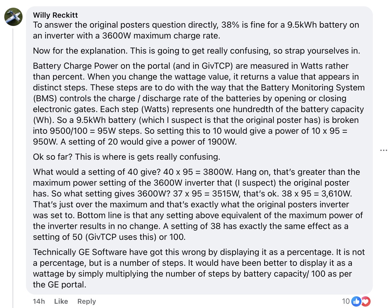

Hi guys, for some reason the % charge and discharge power to and from my battery keeps resetting to 38%….anyone seen this before
Hi Willy, thanks for this. I have the larger c.14kw battery.
Tbh with the new app and the ability to see the ‘direct control’ settings/menu. This is where i can see the 38%. So from your response 38% charge and discharge power is the max setting in terms of power even tho in the ‘invertor setting’ i have set 6000kw battery discharge and charge?
Yes. Read it as “38 Steps” rather than 38% and it makes more sense.
Setting it to 50, should give you maximum power regardless of inverter type, but it will revert to whatever your maximum steps is (38) next time you look. Trying to set a figure above 50 does not work because the inverter can only accept 0 to 50.
