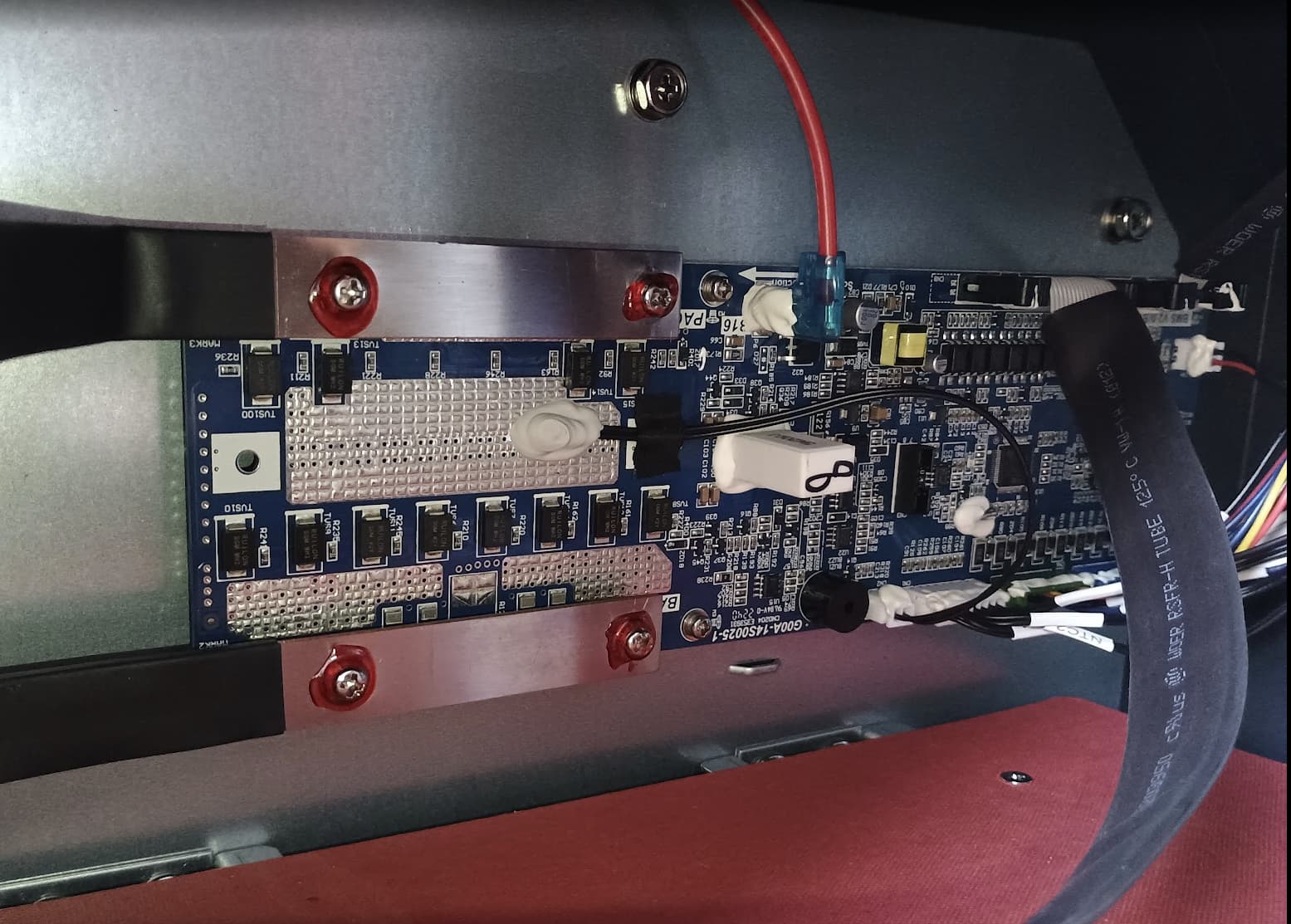

opening the front of the battery you will see the board loacted at the top on the rear inside of the battey. there is a red cable supplying power to this board which is connected via a spade crimp, i pulled this off the board and let it power down for 10 minutes. plugged the power cord back in and the battery fired up fine, lets hope this has fixed the issue but time will tell ifthe issue returns.
Pic here:
hi, yes thats the one, thank you for uploading that.
mine was instaeed at a 180 degree to yours so my cable must of been end of cable drum !!!
Mine has just locked up the same. Green lights all on - battery not talking, power switch does nothing. So I’ll be pulling the red connector too. Crazy they only have a soft reset button and not an external power cycle reboot switch.
