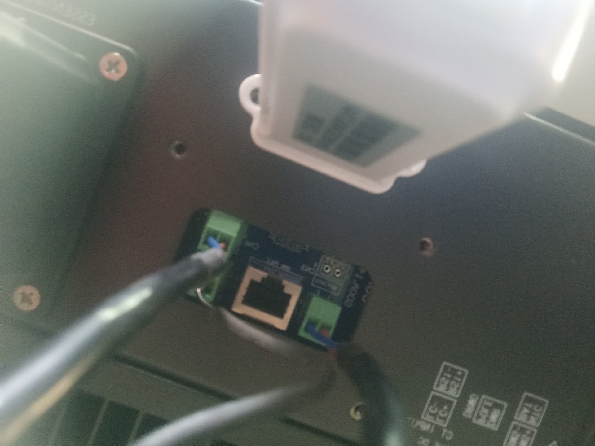

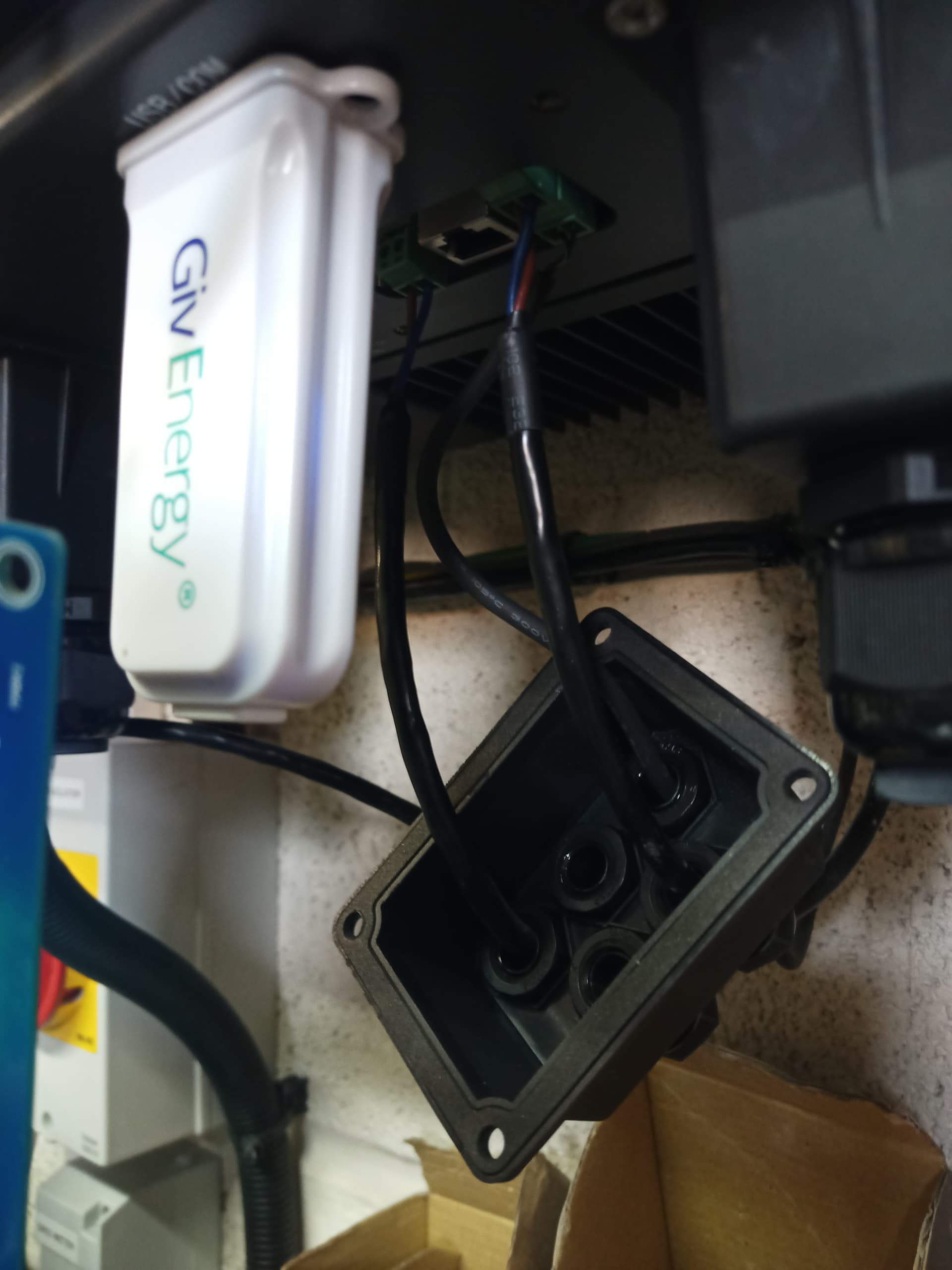

Can you please confirm where these twisted pairs are located in the inverter?
Took cover off and nothing stands out,ribbon cable,mains cables to battery and 2 core cables .

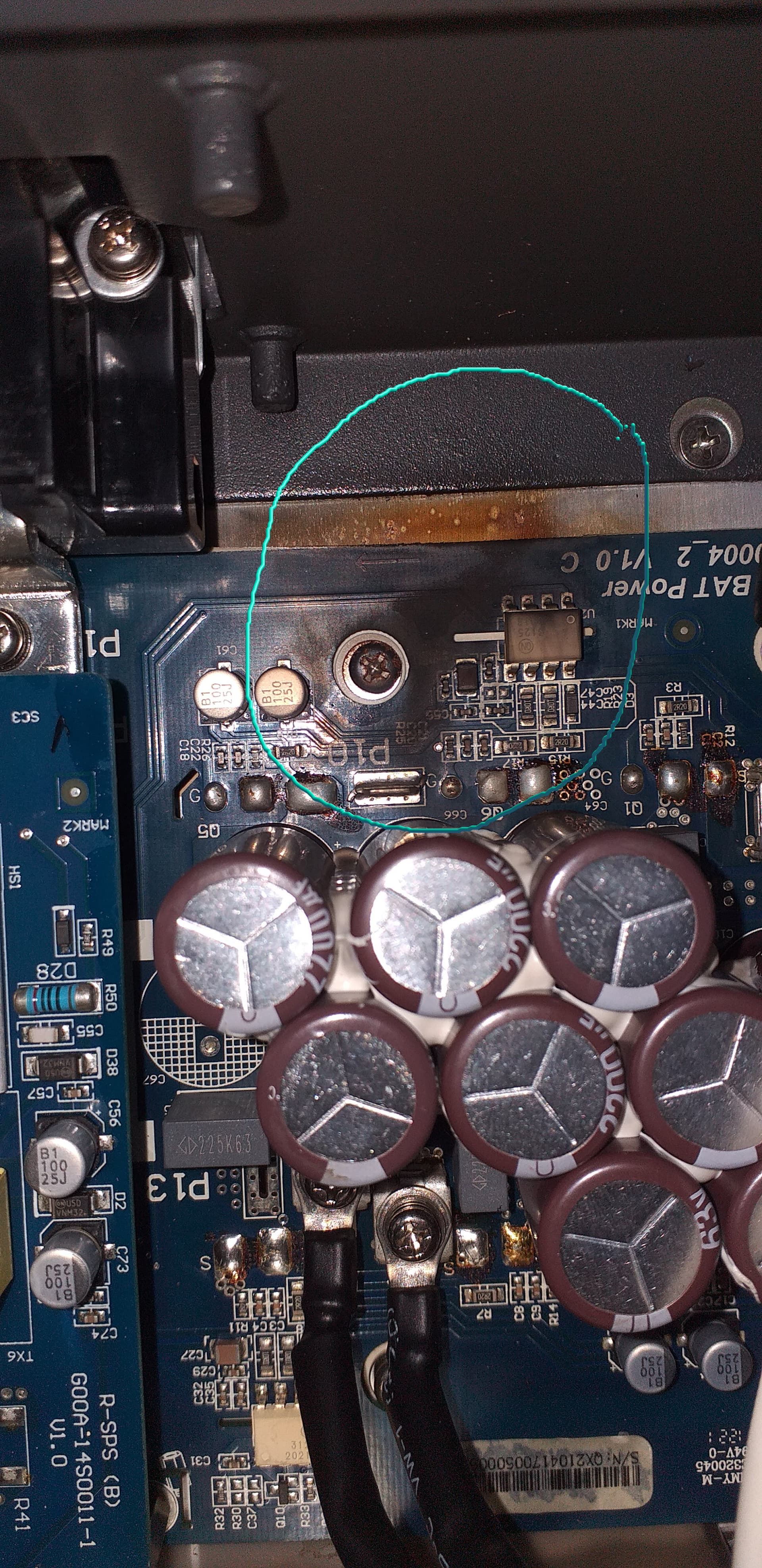

Hi, I had the same problem. Working fine for 4 years. I could see the battery’s 2 x 8kw 1 x 5kw on the app. But would not charge or discharge them . I been talking to Givenergy till they went into administration. So then i had to go to the installer. Luckily they had an inverter and sent a technician engineer out to replace it. Its now working fine. The problem was the circuit board on the inverter.
handystraps2, thanks for the suggestion,when I saw you picture I was hoping mine would be the same🤣
Unfortunately, the board “looks” to be in good order.
It does though appear that that is the area I should be looking at and maybe see if I can get hold of a replacement board?
