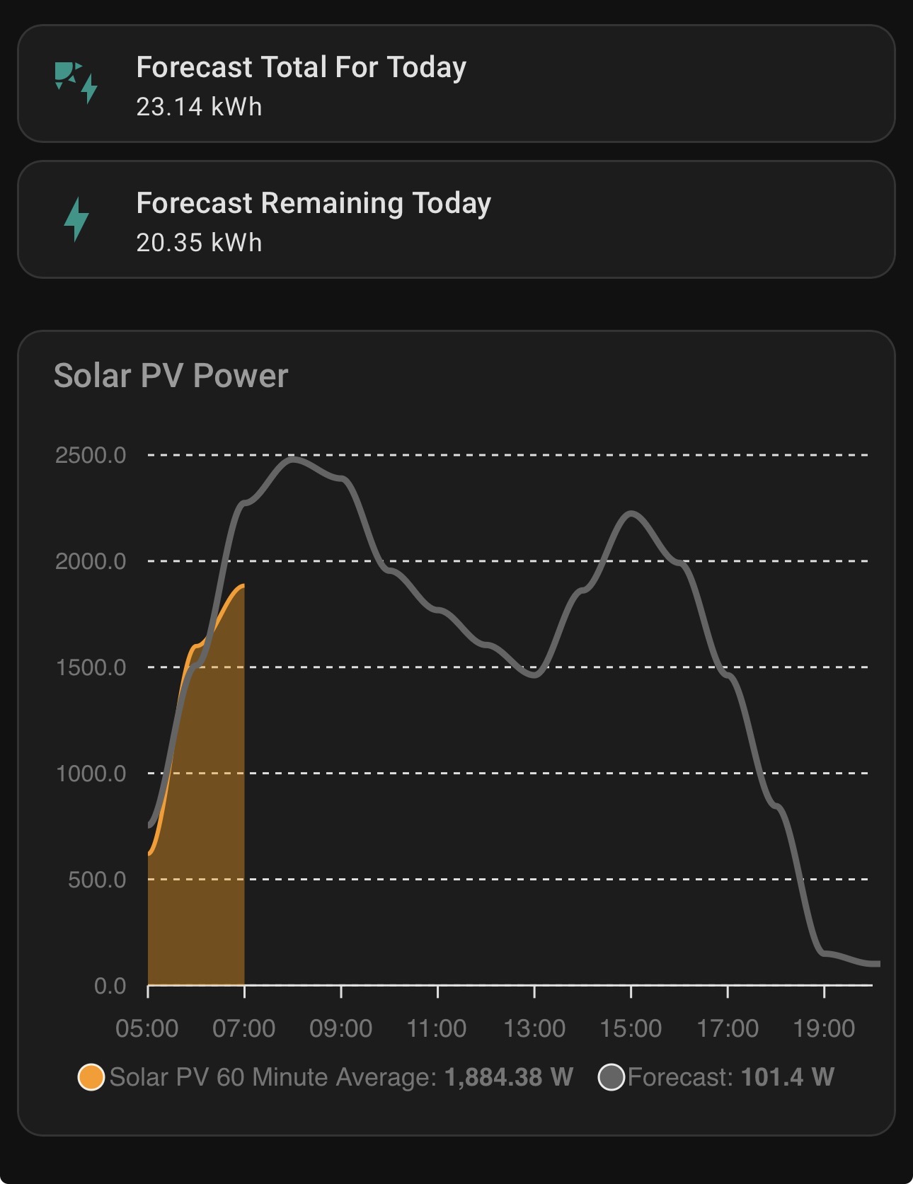

Here is the YouTube link to the channel for Speak to the Geek and his excellent video explaining how to regain local also remote control of a GivEnergy system. I setup my system using these instructions and I still have complete control of it both locally and remotely. I have also added an Automation to control charging of my battery overnight depending on the solar forecast. Anyway, here is the link:

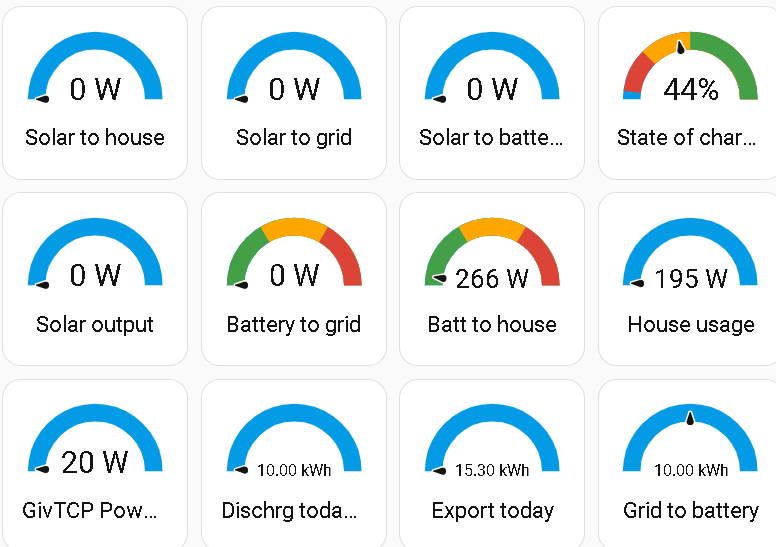

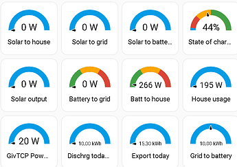

I managed to set it all up to be able to do what I could on the portal cloud. Plus, GivTCP has a calibrate button that I couldn’t find on the portal cloud. It took a while to get all the gauges on one screen, on the “layout” option I swiped it sideways to make it 3 instead of 12. And I pretty much gave up trying to get the red/amber and green bits, left most of them blue. Changed the names of the gauges to what made more sense to me.

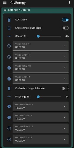

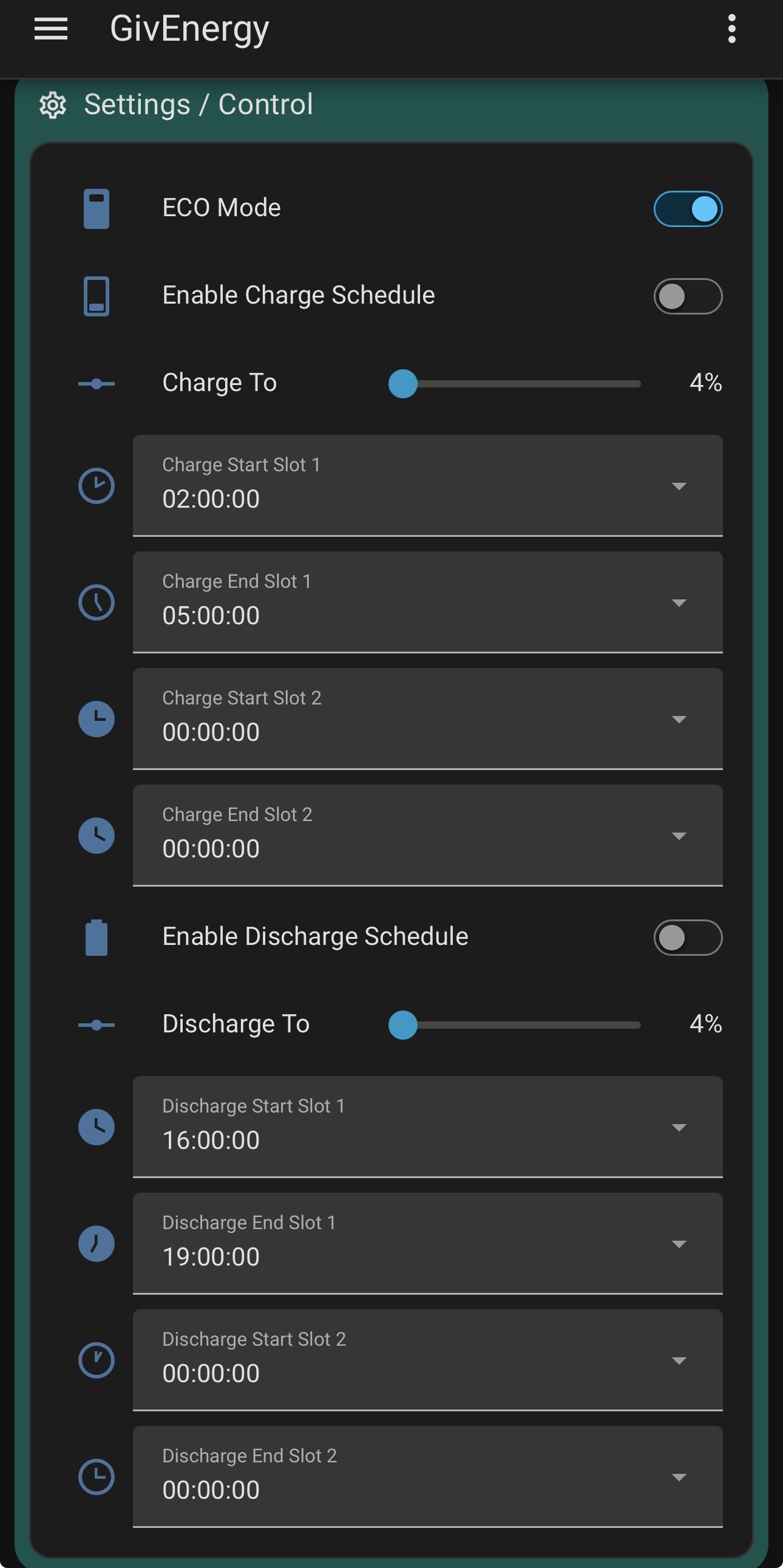

Set up a different dashboard for timeslots and settings.
I found it was easier to set up that page and do the gauges when I had a bit of time. Most important bit is setting the charge rates, toggling the eco mode on and adding the time slots. I haven’t bothered with remote access as expect I’d need a phone and not got around to doing the “flowchart” think STTG calls it.

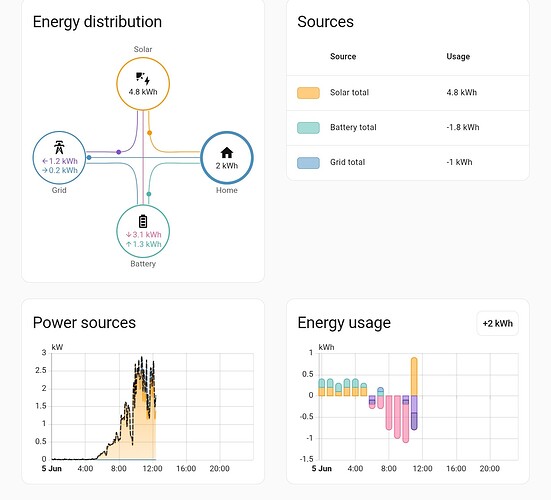

This is what I have setup for my installation using Home Assistant running 24/7 on a Raspberry Pi 5 with 4Gb of RAM, installed in Argon ONE V3 M.2 NVME case and a 1Gb M.2 RAM chip (SD cards are not suitable for running HA permanently, because they wear out too quickly).
My Solar System consists of One 5kW Gen 3 hybrid inverter, Two 9.5 kWh Gen 3 batteries, 17 solar panels in an East (8 panels) and South (9 panels) configuration.
Following the excellent STTG YouTube tutorial will give you basic control back without a subscription. However, you will have to purchase a few items in order to set this up, but this is a one-off cost.

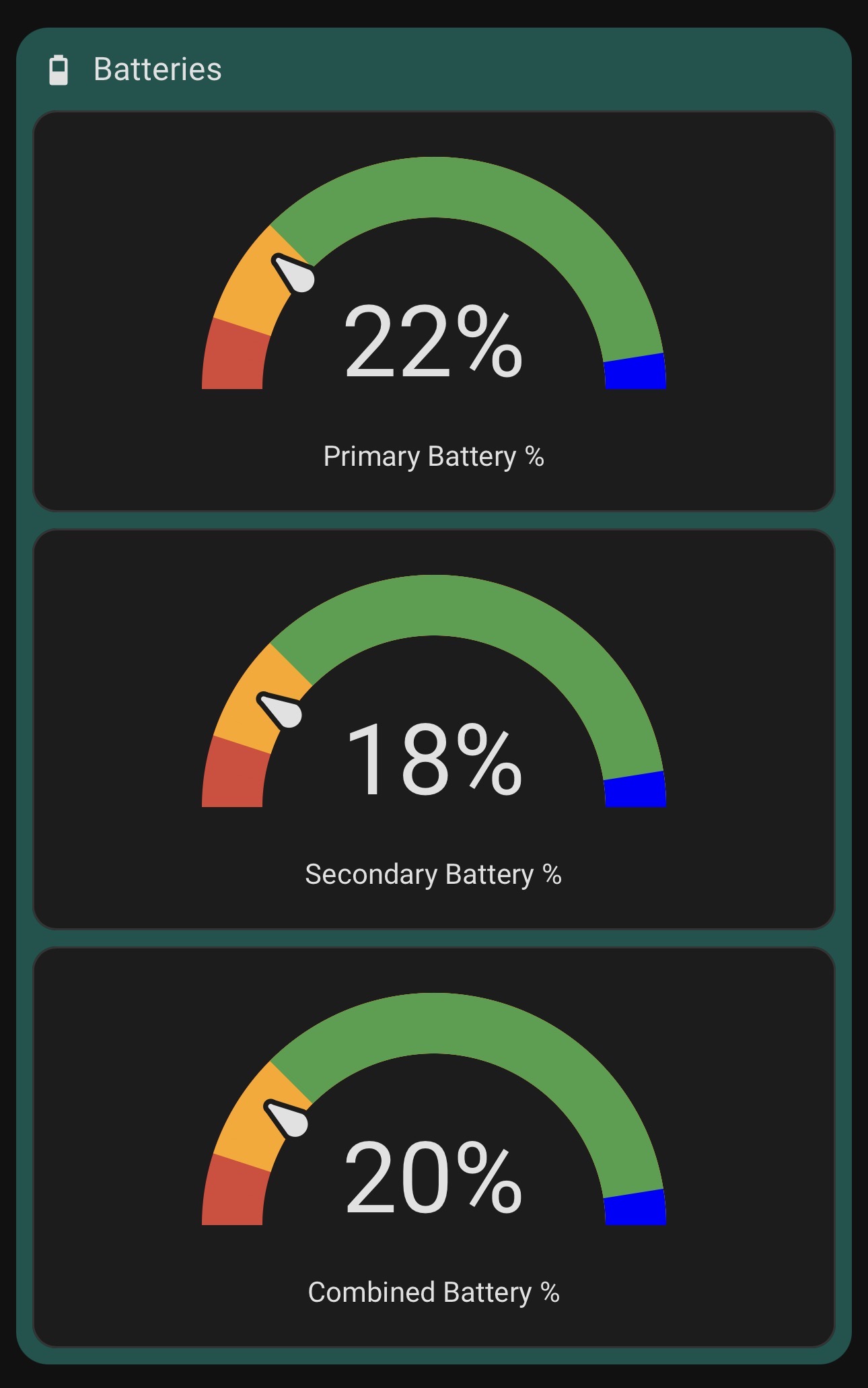

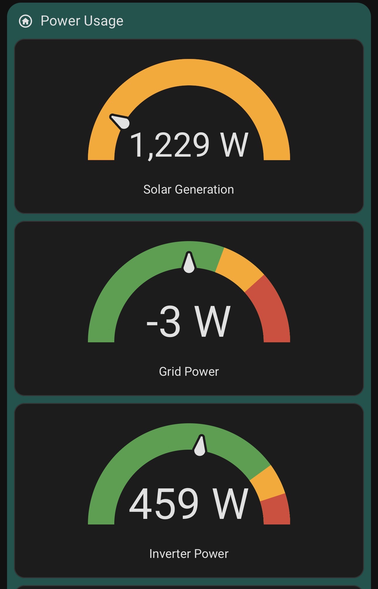

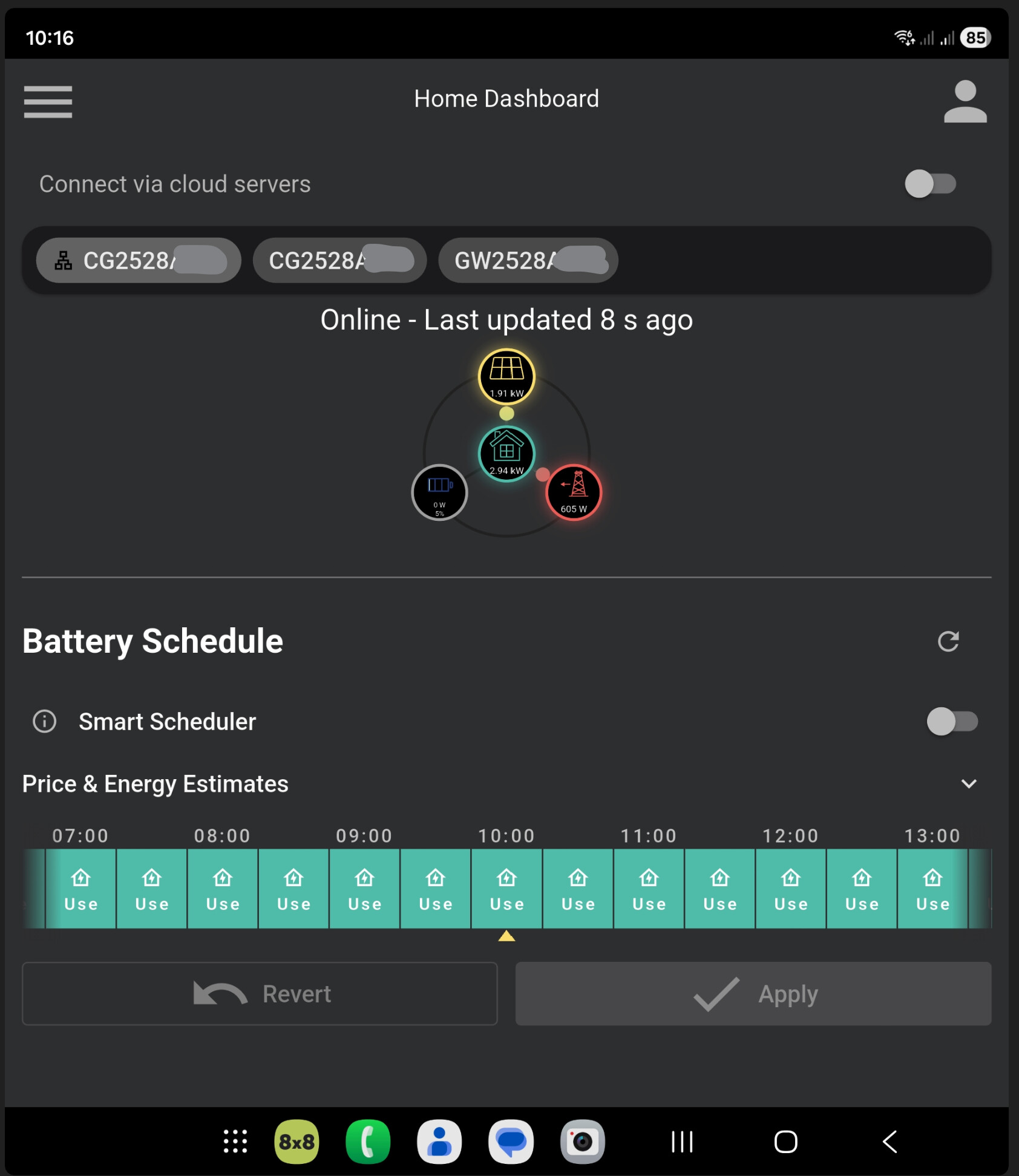

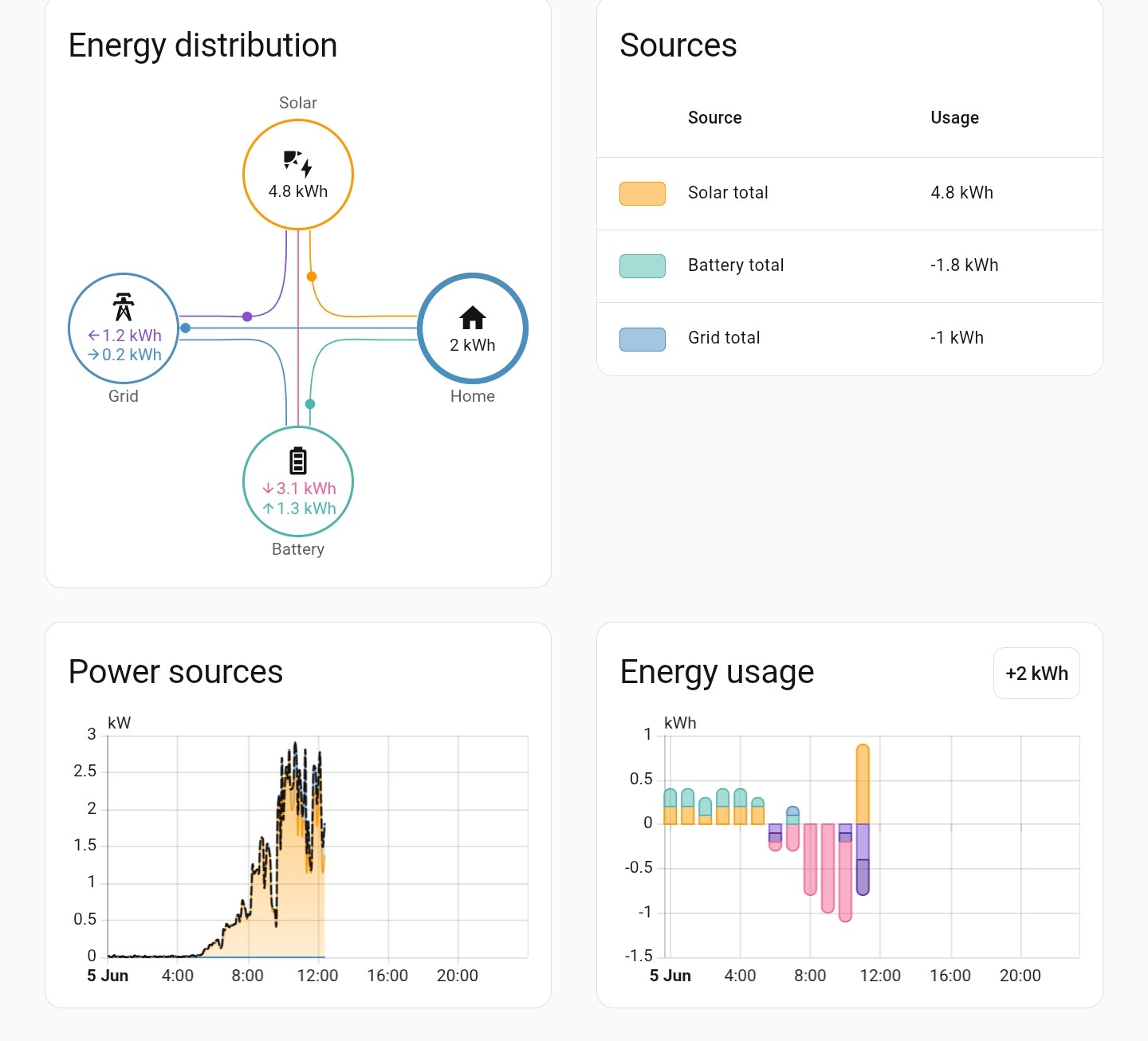

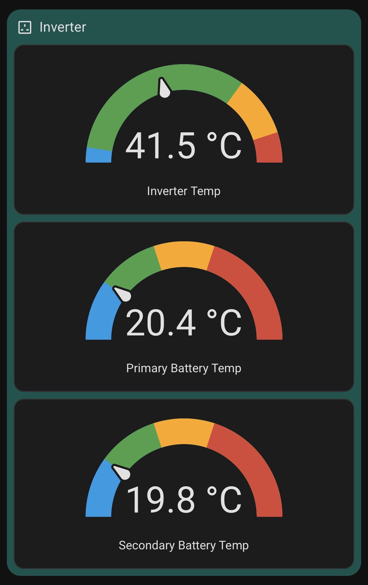

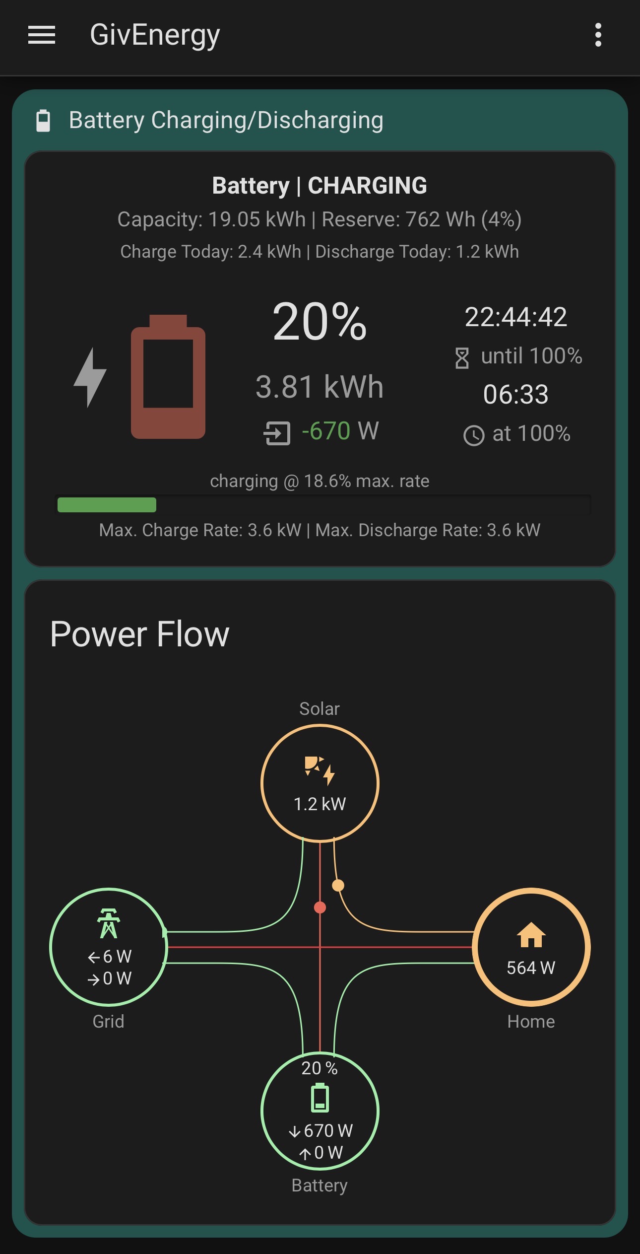

Here are some screenshots of what I have setup.
I got it working on a Synolgy NAS as that’s already ON 24/7. Not as easy as a stand-alone computer of any flavour, as a little more work instead of all done for you. I now have two web pages, for current and all-time energy, plus another which is the inbuilt Energy page and shows the flows between all items.
