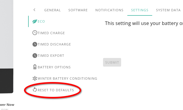

And, have you tried resetting everything to default? (Can work wonders!)
And then, maybe, try reconnecting your battery via the Octopus app.
