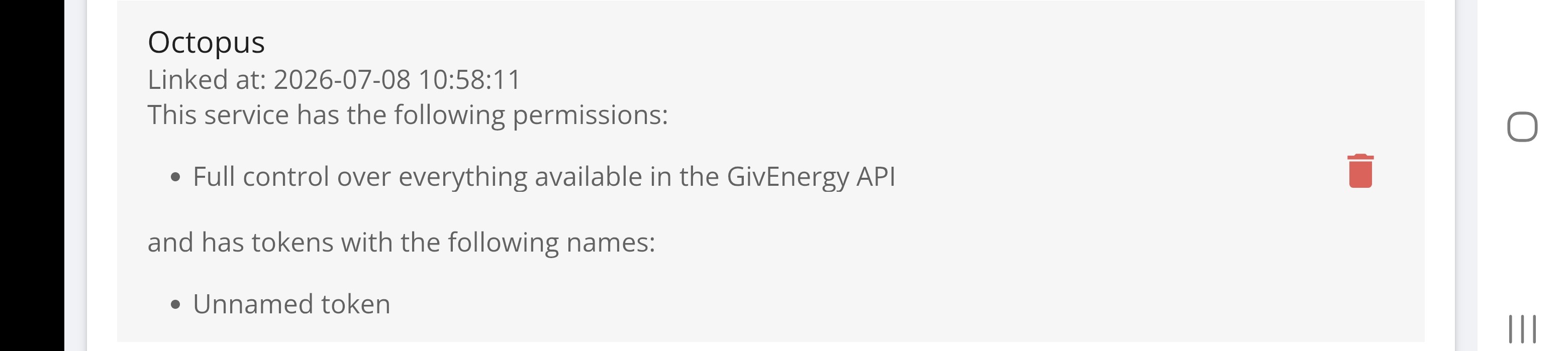

  • GivEnergy Portal: The GivEnergy portal confirms that Octopus Energy has full API account control permissions, but I am no longer receiving dispatch instructions (Kraken schedule).

Screenshots attached showing GivEnergy Portal permission

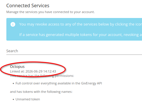

The original comms problem seemed to start shortly after my account upgraded to PREMIUM in early June - and that date has changed again, for some reason:
