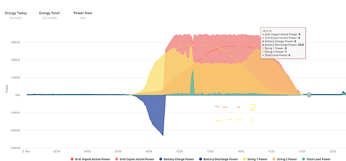

My 3 phase inverter and 20.4 kw of batteries and 11kw of solar went live mid January. We have now got our export MPAN so I have been looking at our production over the last few sunny days. It looks to me that the is a maximum production of 3.5kw whether the sun is full or hazy. To illustrate this I attach a graph for 2 February which was particularly sunny with only the odd cloud mid morning. You will see that although production rises rapidly until 10am it is then totally flat until 4pm when it drops rapidly. I have added a couple of lines which illustrate how I would have expected string 1 and 2 to have performed. It may be a coincidence but I have eventually managed to set a timed export and that was limited to 3.5kw too!.

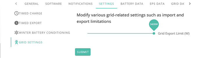

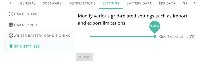

Just looked at settings on the Inverter page of the cloud. This appears to suggest that there is a grid export limit of 3.4v kw!

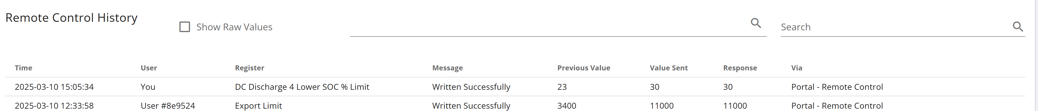

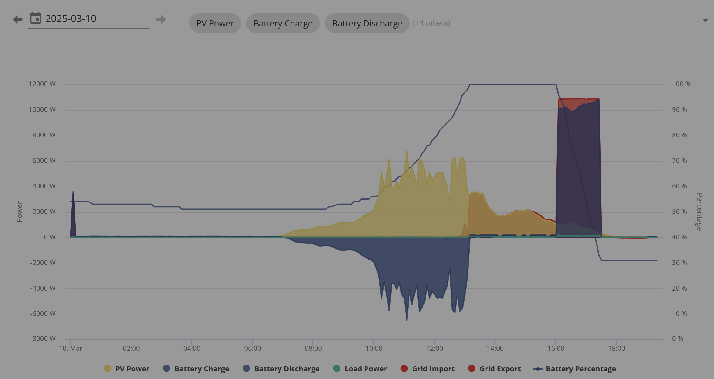

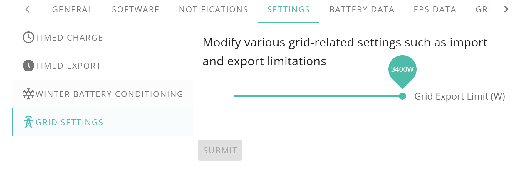

The Installer has amended the maximum to grid to 11kw. at 12.30pm . I can see from the remote access log that the change was made at 12.33 but from the graph it looks like as soon as the battery was full (13.15) it was choked back to 3.4KW. Though it may have just been a coincidence that the clouds came in !

I’m also not sure that the change of grid export limit was effective, as 3.4kw is still shown as the grid export limit maxima on the grid settings shown on the Givenergy cloud.
It may be that your installer has changed one setting but not everything that needs to be changed?
If you click on remote control - the little cog symbol - that gives you a list of all the configuration settings you can change. Some are installer hidden though, but check that list that nothing is set to 3400.

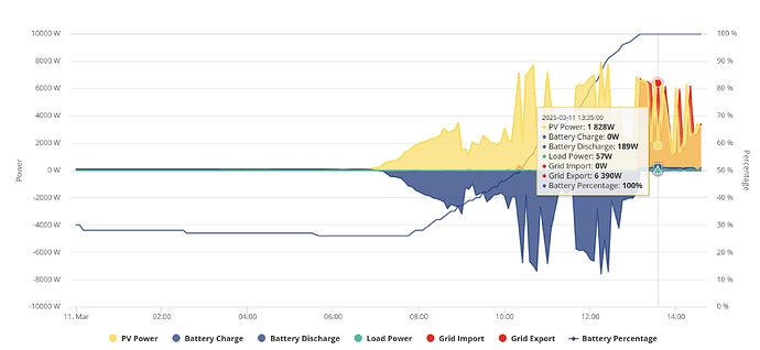

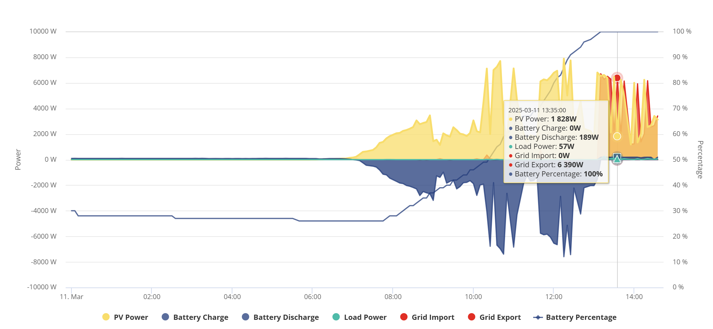

It looks like the apparent clipping yesterday was just a coincidence that the clouds had thickened at the same time as the batteries were fully filled, today, once the batteries were full we have been exporting to the grid at over 6kw
