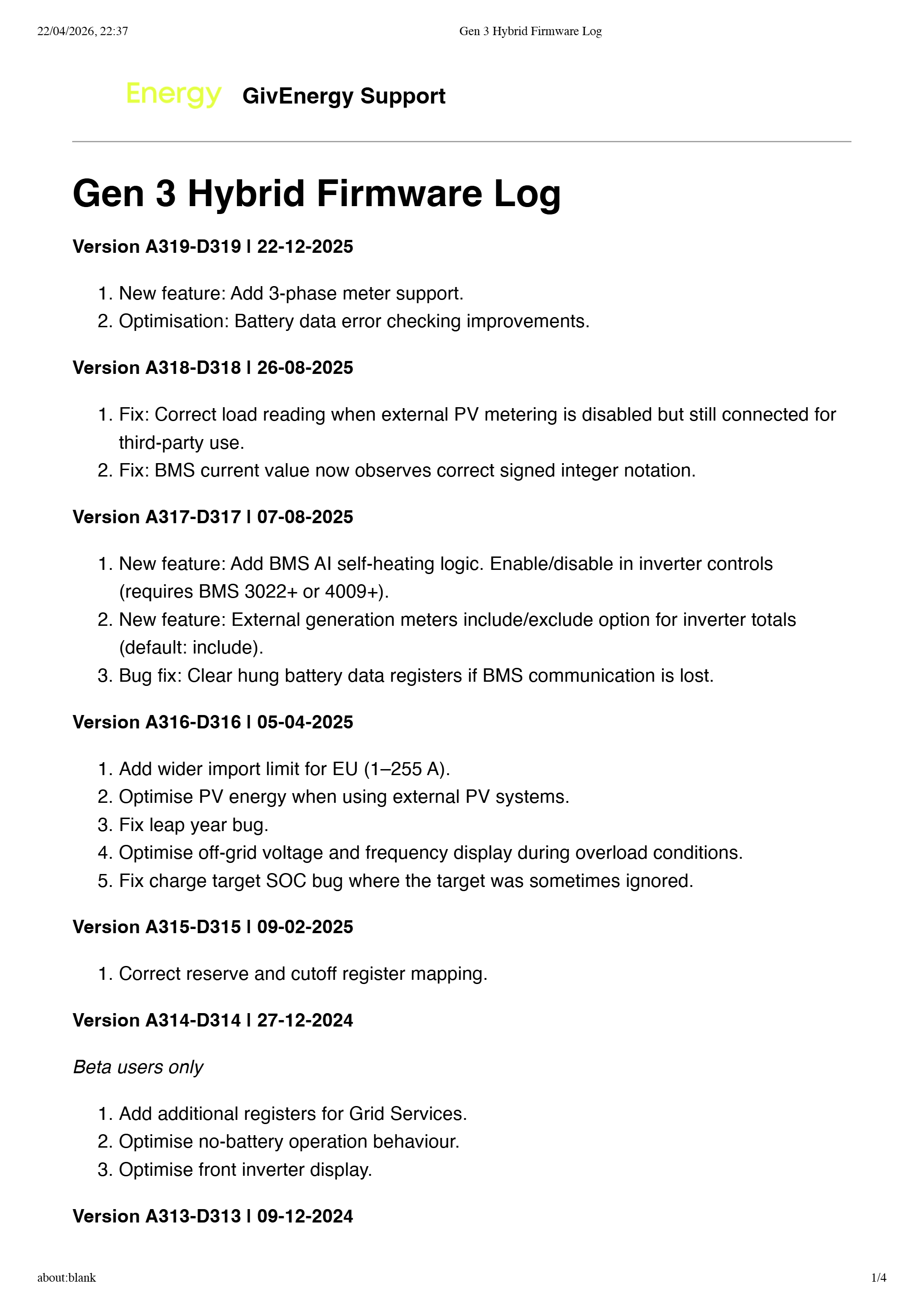

Hi, I am on 318 also. I have found it to be very reliable. I believe it is the lastest official release. If I remember correctly 319 is a pre-release version, so not released to everybody for installation.
This is an extract of the changelog.
