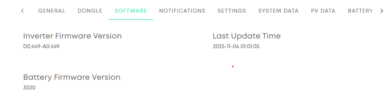

Update time 2025-11-06 01:09:53
Inverter Firmware Version
D0.449-A0.449
Battery Firmware Version
3020
this is an OLD firmware version, the latest published Gen 1 firmware is D0.450-A0.451 G1 Hybrid firmware revisions | GivEnergy although there are later beta software versions (I’m running one). I had 450/451 on my inverter when I first got it, 3 years ago.
Not clear why your inverter should actually downgrade itself.
In the givenergy portal, do you have the option to upgrade the firmware back to 450/451?
That’s interesting. It did seem to update automatically, so possible it may have reverted it from it’s own memory cache somehow. Also, I’m quite sure the last time I did a firmware update I told it to install manually through the portal, though this was years ago.

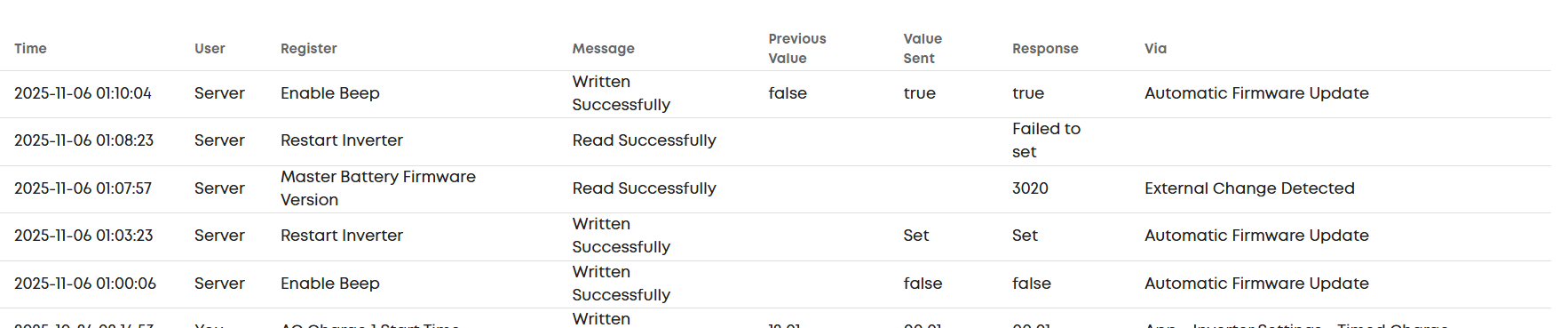

Anyway, I’ve had another look. The battery version is 3020. This is the update log on the remote control - logged as an Automatic Firmware update. I haven’t heard from my installer in years, and there’s been no need for them to intervene in this sense.
