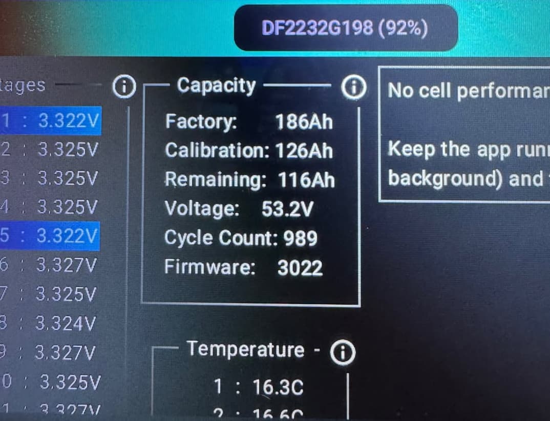

After updating, one of the batteries started reporting its ‘Calibration Capacity’ as 126Ah, down from ~180Ah, and well below the original factory capacity of 186Ah! This means it’s ‘lost’ a third of its capacity.

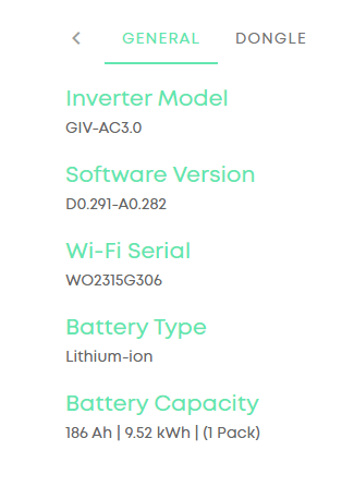

Where exactly were you seeing your reduced capacity, via the Inverter Monitor Android app, as per my screenshot above?
Inverter card on the dashboard
Ah, that does not show the ‘Calibrated Capacity’ value. You can only see this using the Rubikcube Monitor for GivEnergy Inverter app or by querying this value via GivTCP/Home Assistant.

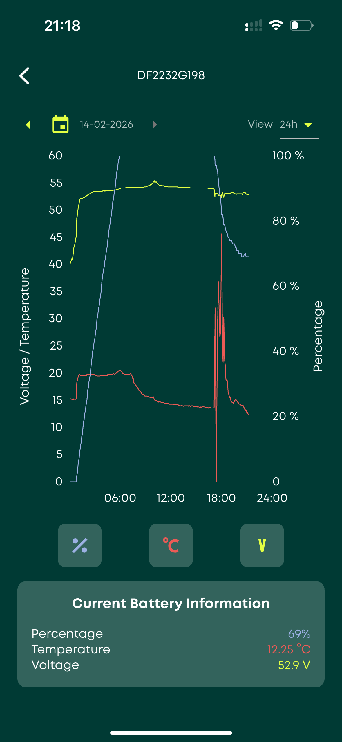

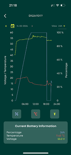

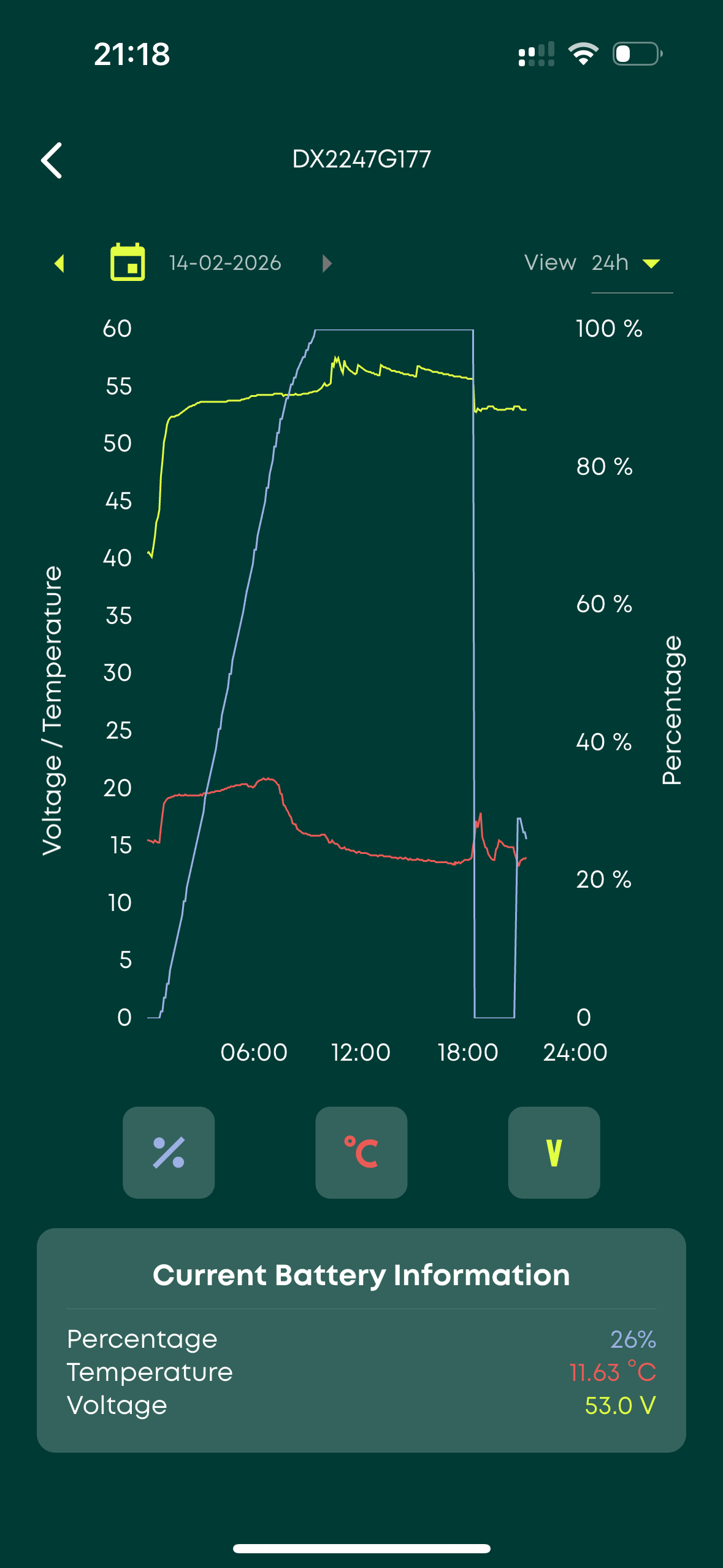

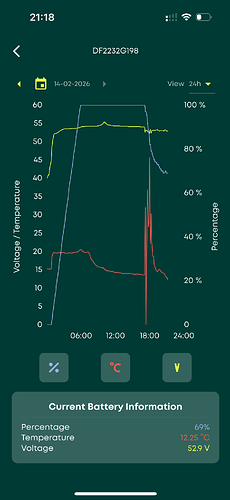

Yep, both at a ‘good’ calibration level, but after calibration finished the primary battery SoC plummeted to 0% immediately, and the secondary was giving crazy temp readings!
I’ve just manually power cycled everything, and the primary is now showing 30%, with secondary at 70%, both at same voltage… so definitely doesn’t appear to be ‘balanced’!

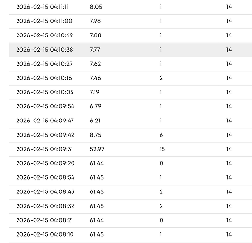

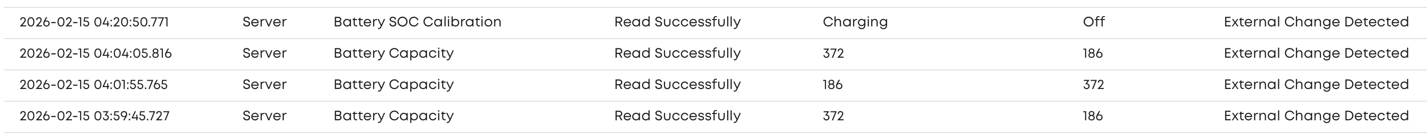

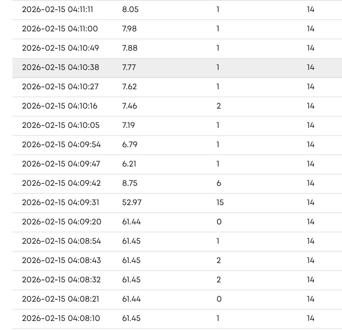

Tried running a ‘top end’ calibration, now the inverter sees a very low battery voltage (8V), and sits idle, refusing to use the batteries… Battery capacity in the portal is also now shown as a single 9.6kWh, this changed twice in the logs…
Batteries not usable currently. Have tried power cycling the inverter via the breakers. Really wish I hadn’t updated the firmware!
