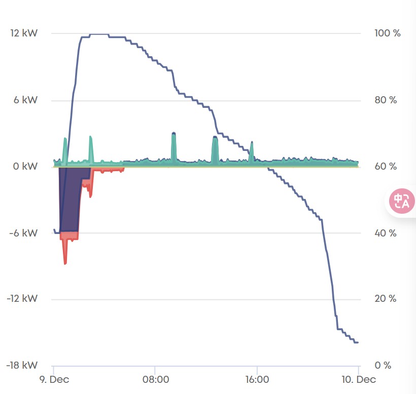

I have an odd problem with my AIO which I have been unable to get GE to respond to, so I raise it here to see if others have experienced it. I have no solar, charge to 100% overnight from the grid and discharge to home during the day, nice and simple.
The attached graph shows my AIO discharging normally down to 44%, then mid-evening plunging down to 6% on very small load.
I see this behaviour every few days, and I suspect the issue is that the AIO wasn’t really fully charged overnight although reporting 100%.

This has been covered lots of times, what you are seeing is SoC crash. The AIO realises it doesn’t have the state of charge it thought it had, and rapidly corrects itself. As you’ve said this occurs without significant house load; and it generally happens in the lower half of the SoC range.
Upgrading to the latest firmware is a good step, what you should do now is to run a battery calibration which will re-teach the inverter what full and empty are. You can initiate this yourself from the portal.
When the calibration is running you can alter the charge and discharge rates and I have heard advice that doing a calibration at a slower rate can lead to a better result.

It makes sense that what I’m seeing is an SoC crash. What puzzles me is that the AIO loses track of SoC every few days, despite charging to full every night, which should make it easy.
I have have calibrated before and not noticed any significant difference. I will try your suggestion of charging at a slower rate.
