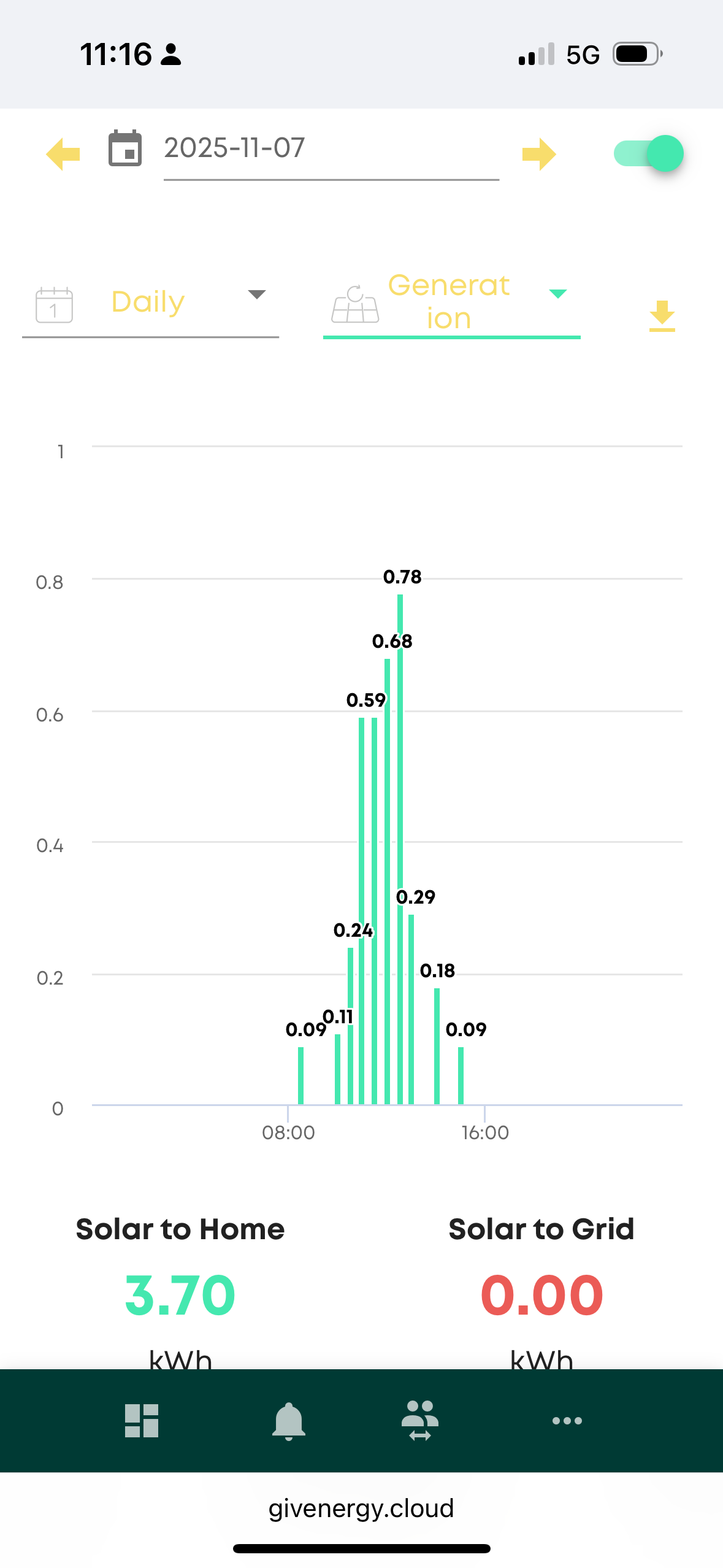

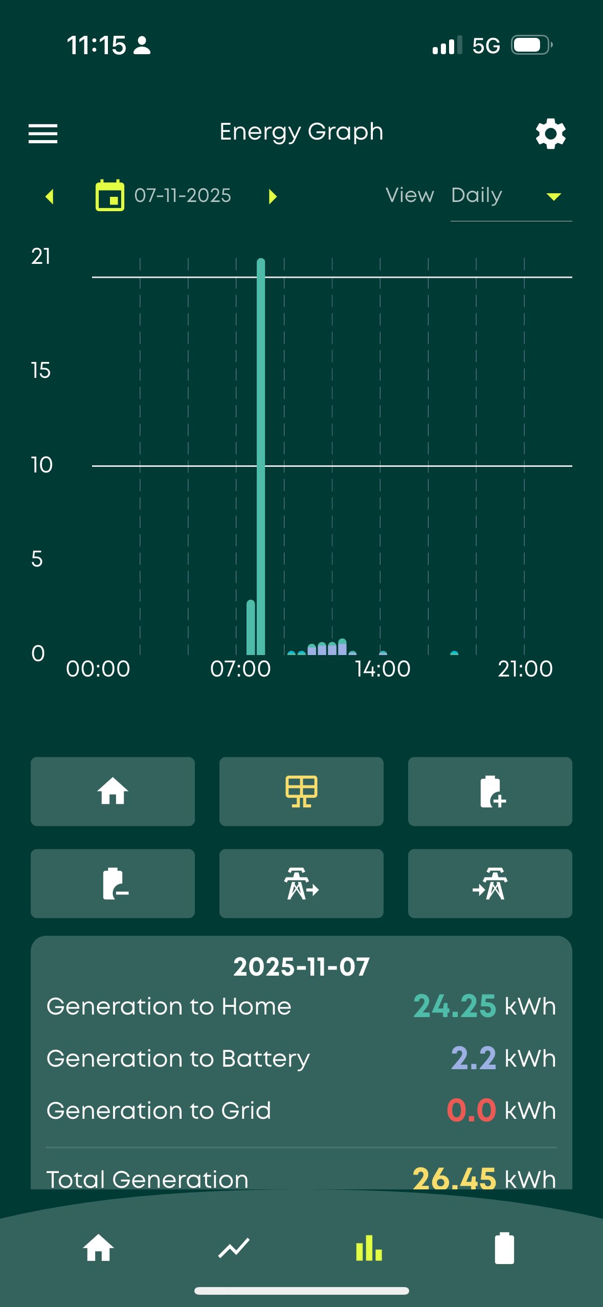

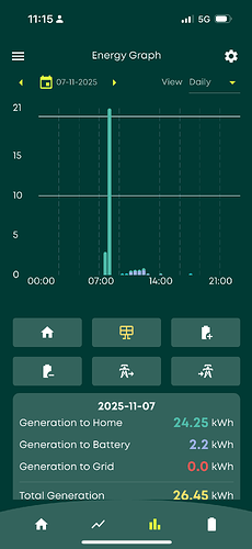

App giving wildy different (and incorrect) measurements to the portal
Have noticed the last week or so the app is reporting that I’m making huge numbers of energy - apparently 33kwh today by 0900 for example. When the portal is reporting the most likely correct number of around 4kwh.
Why is this? What’s going on?
System normally says the same thing - nothing has changed in the install. Anyone any ideas?

The portal data in your case sounds like its correct
iOS. Portal data looks correct.
App is wayyyyy off. And why all ‘generated’ by 0900?

Portal looks correct.
Very odd. It’s been correct today, but from 3 Nov to 7 Nov it was totally out of whack, showing a huge generation at a range of time from 0730 to 0900. Very odd.

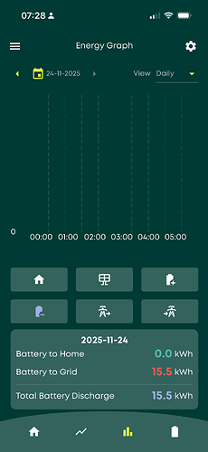

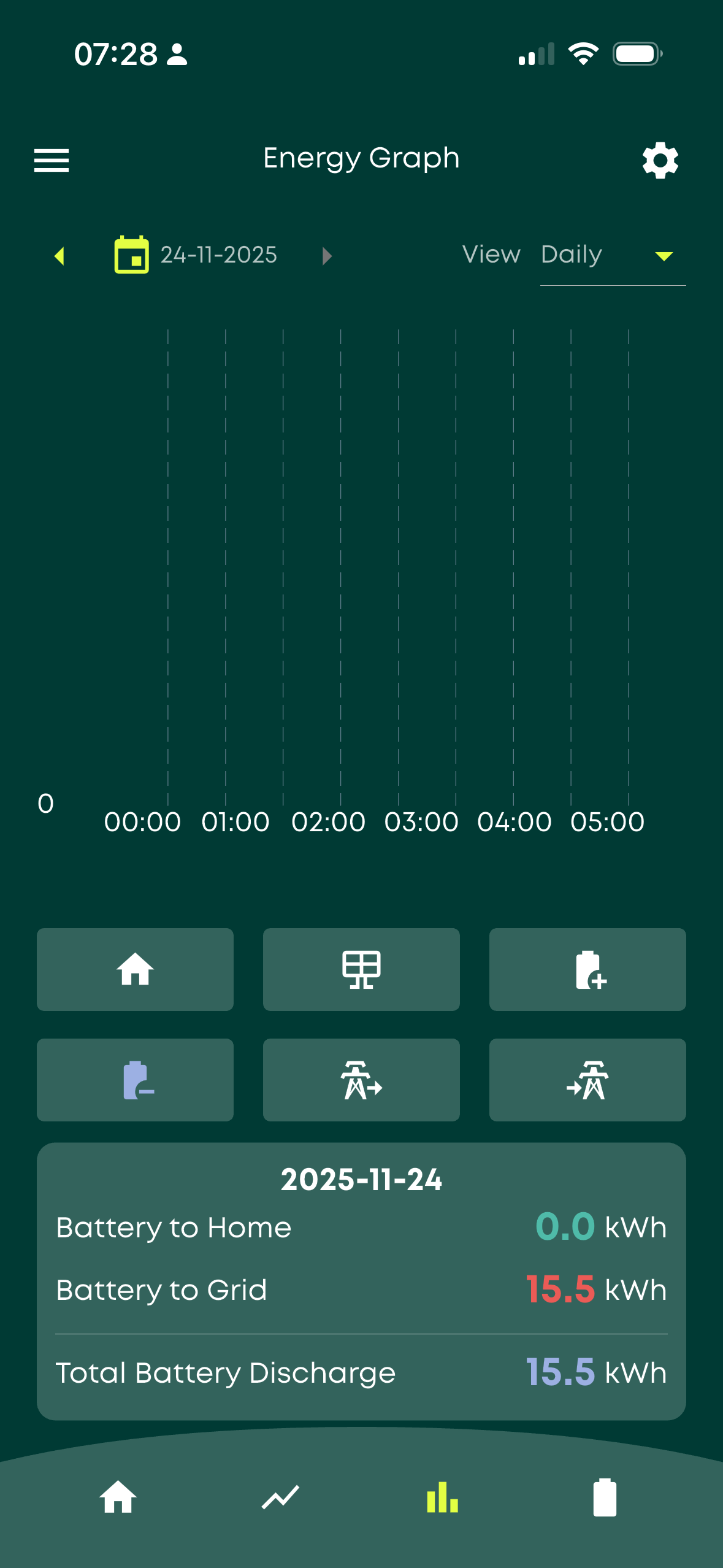

I have the same problem on the App. It all started when the clocks changed. Huge figures in spikes.

I’ve had no update, and it has happened on 6 of the last 7 days for me. It seems to be associated with how they derive what energy source is powering the house - on all the occasions the issue has occurred for me, they show no battery powering the house before the solar spike, even though the power graph shows the battery successfully covering demand for some or all of that period. It then looks like they put in a “catch-up” spike of solar-to-home to cover the gap.
There are other anomalies, like erroneous grid exports being recorded around midnight on the days of the issue as well, so I suspect this is all down to how they reconcile consumption/generation/export with the data they have from meters on the inverter, and perhaps the clock change affected which “day” these were recorded on, and threw out the other calculations.
But we won’t know until they respond!
Good spot. I have the same thing re the battery before the spike. No “energy out” of the battery prior to the spike, despute the house being on battery only from 0530 every morning.
