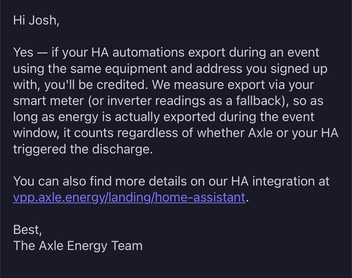

Meanwhile if you don’t subscribe to the premium tier but still do the export at the right time, Axle will still pay you. They have confirmed this as well
This is what Josh has received from Axle, so the facts are you do not need GE?
