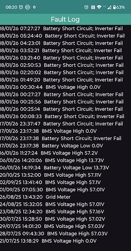

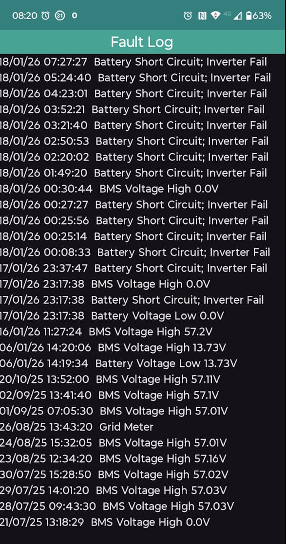

Back on 17th Jan after a brief power cut the battery started clicking and then tripping red.
Battery stays green if you turn off the DCMCB
The inverter app says: Battery short circuit; inverter fail.
indicative of the buck boost circuitry in the inverter failing short circuit (MOSFET?)
Givenergy have just got back to my installers and my installers are now planning to come back round next week to do more diag/fix.
GE’s analysis is my battery is either flat or the BMS is frozen.

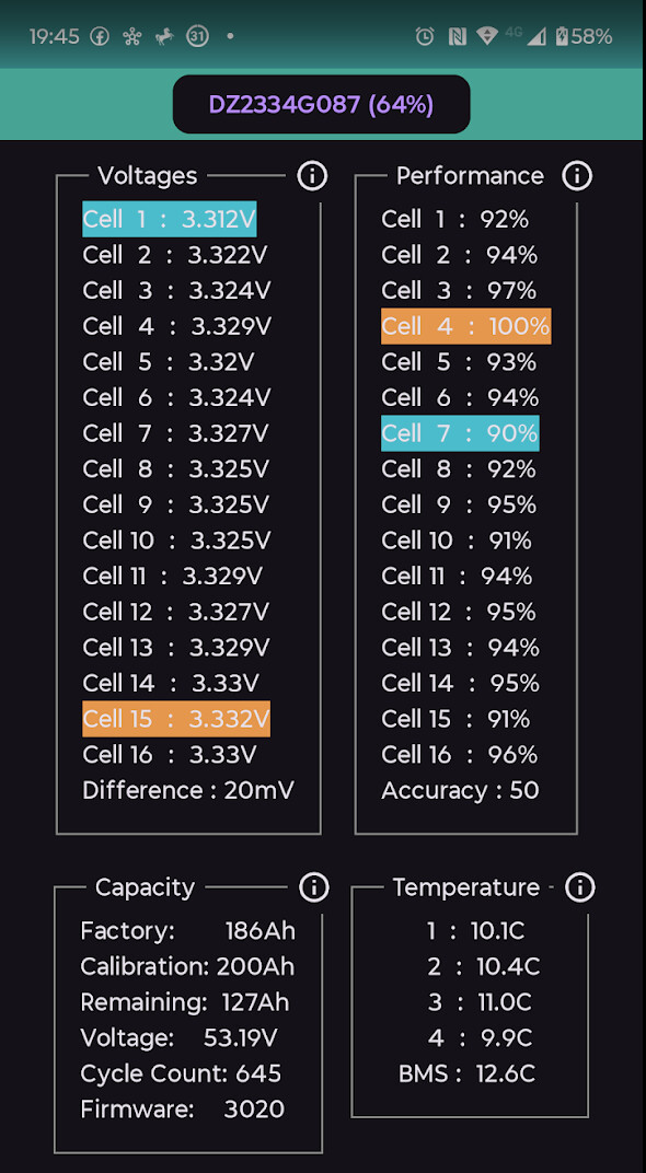

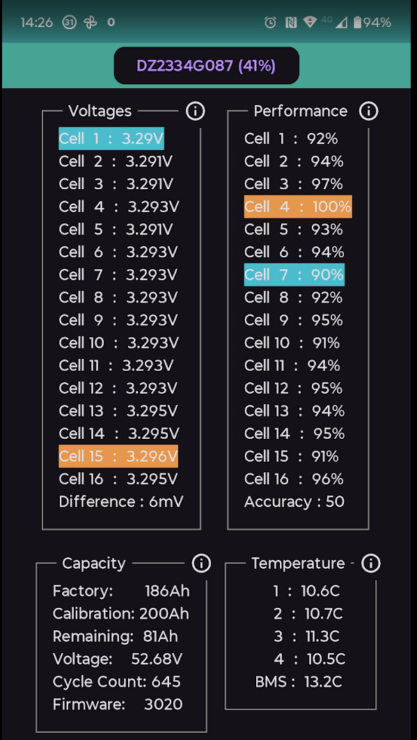

3 weeks ago when the click of death started:
And today
Does that look flat or the BMS frozen, Numbers are changing daily.
Is this associated with clicking heard as the BMS softstart tries to boot up, into a short and shuts off.
Service required
Yes, 10 or 12 clicks then red battery light and ‘short reported’
Only does that with DCMCB on, so likely the short is in the inverter buck boost MOSFET device?
