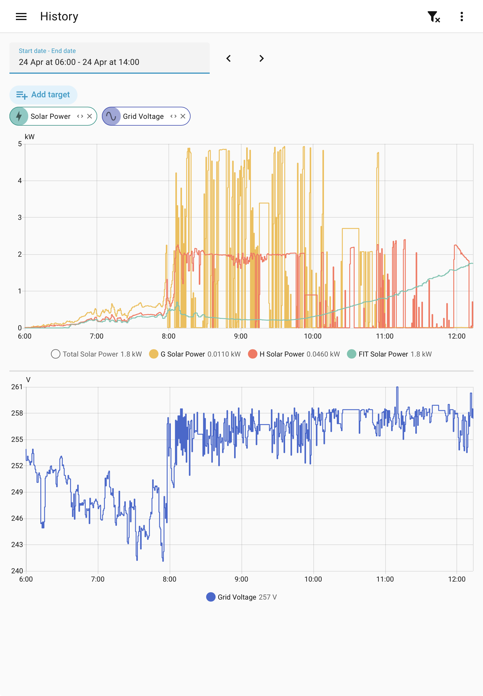

You can see it very graphically here, the solar power cutting out with high grid voltage
248-250V is within grid supply limits, the max voltage is 253V so again the trip switch shouldn’t go.
And even though you and your neighbour are on the same cable you should be on separate grid phases so his and your export won’t directly affect the grid supply.
High grid voltage (above 253V) can be reported to your DNO
