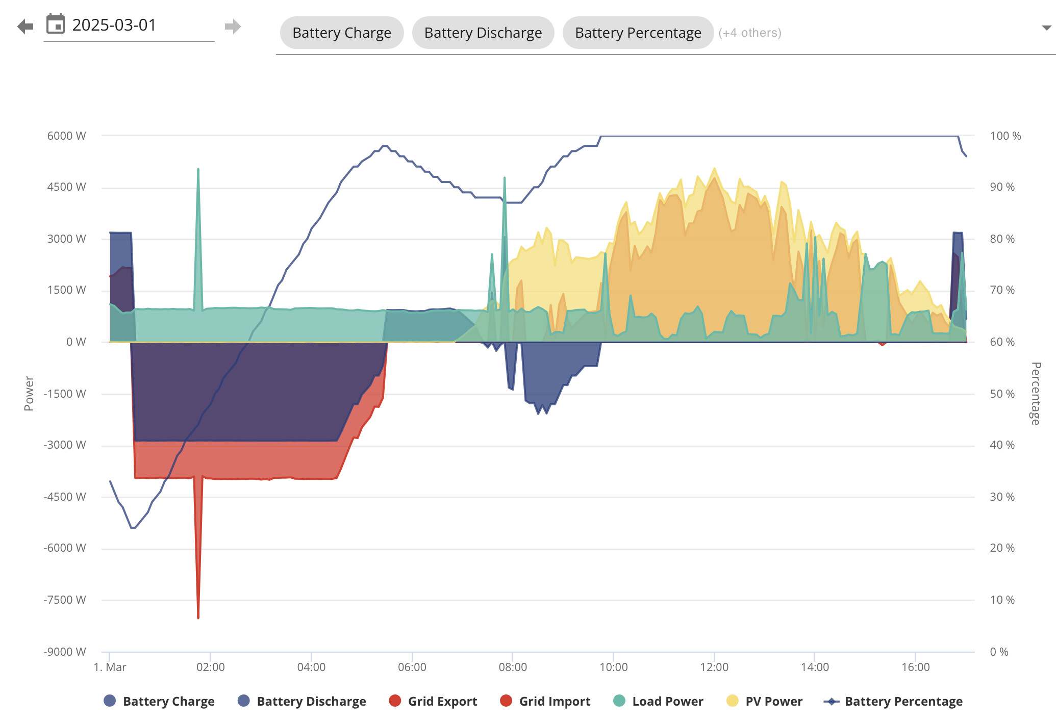

Can you post a screenshot of your portal power chart. This is mine:
The line is battery SOC.

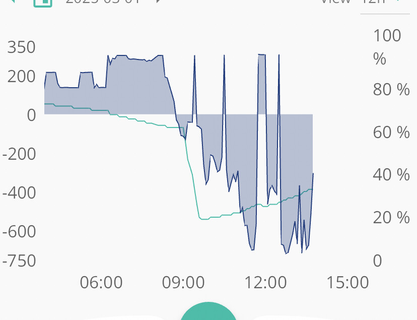

Got the screen shot…
Michael

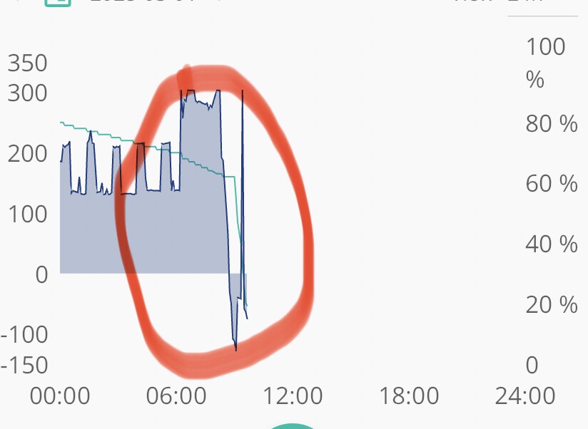

The big drop you highlight looks to be at about 9am, and there’s nothing much happening, some house load (red line below the central line) and some battery discharging to meet it (green above the line), but the battery percent drops dramatically as you said.
This is likely to be a SoC correction whereby the battery realises it doesn’t have as much charge as it thought it had and corrects the figures it presents. Basically the previous SoC it was reporting was erroneous and now its giving more accurate data (its a complex subject but measuring battery % full is not easy, its all done on voltages and they actually move over a very short range).

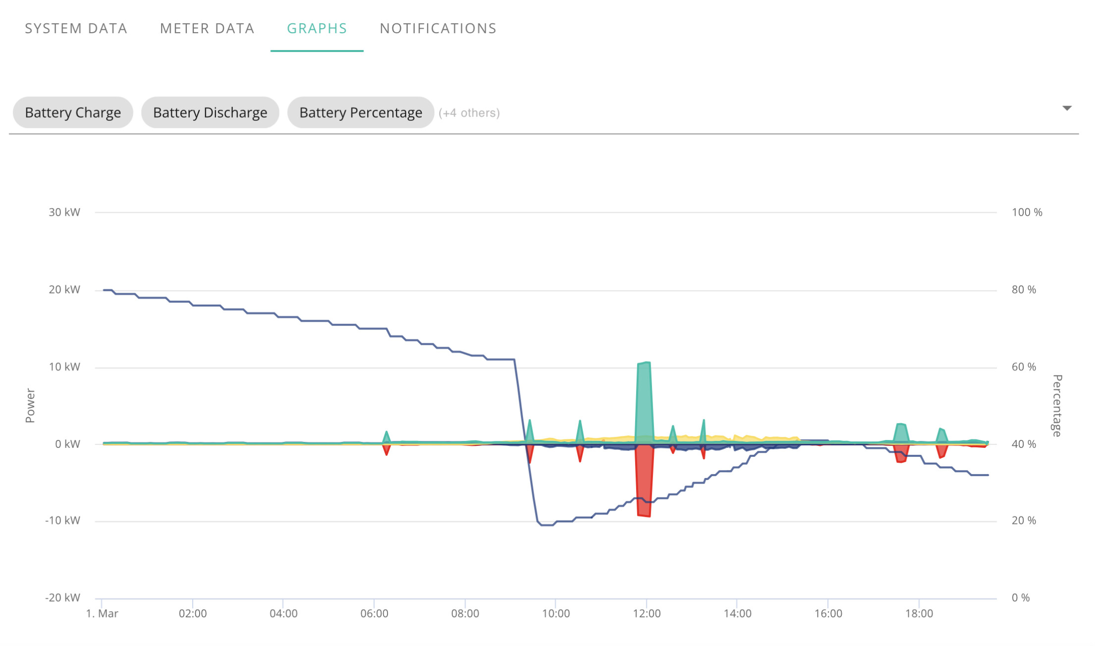

Something very strange happened around 12:00. You have a load of about 10kW (in green) being supplied by the grid.
If you look at my power graph, I don’t have anything near to this power draw.
Were you using something around 12:00 for 30-45 minutes that might have caused this power draw.
If you look at the other colours, the battery (blue) and PV (yellow) are hardly showing up at all in comparison.
How long have you had the system?
And what model inverter do you have? You can get this from Inverter/General on the portal.
See if anything settles down over the next day and them upload another power graph so that we can see if things have settled down.
I saw the same but it was after the SoC drop. An electric shower can easily draw 10kW, ours do so have to train the kids to shower in the power up events
