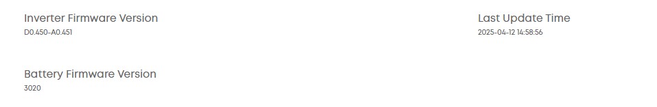

What changes do i need to look for to know it has happened?
that place
its done
i set a reserve of 75% (Current 70%)
it stopped discharge as expected.
Put back to 40 now
Fantastic. Thanks
16:30 has come and gone and battery still holding 40% and grid import is supporting house load.
Looks like the Dragon’s firmware update has fixed things. Brilliant
All working great thanks to the Dragon!
