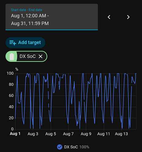

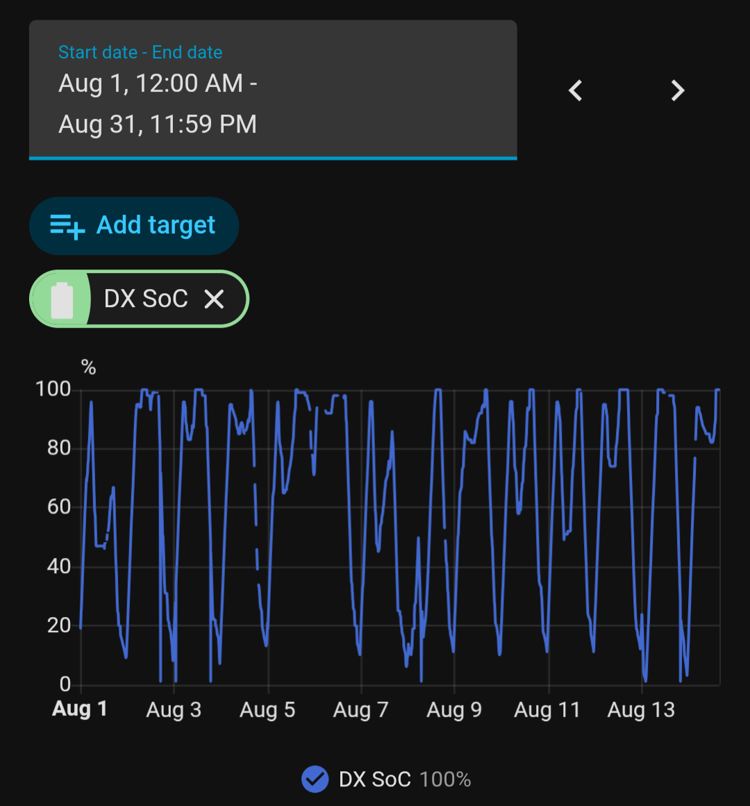

I’ve attached a GivTCP screenshot to help show the issue. (Can only attach one as a new user unfortunately)
The battery reached 100% during the calibration, but not outside of it. The same graph for the other battery shows it reaching 100% consistently.

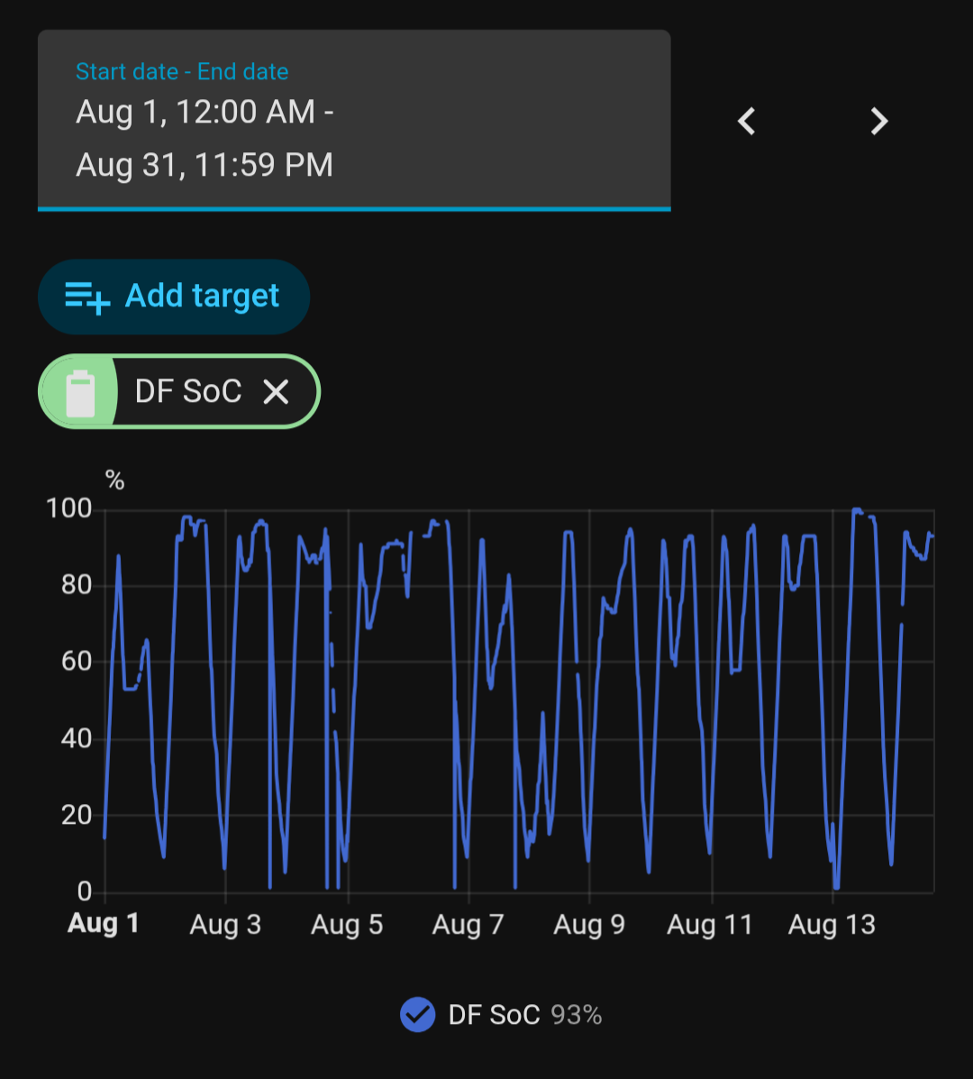

Extra screenshot I wasn’t able to attach in the post showing the other battery for the same time period:
