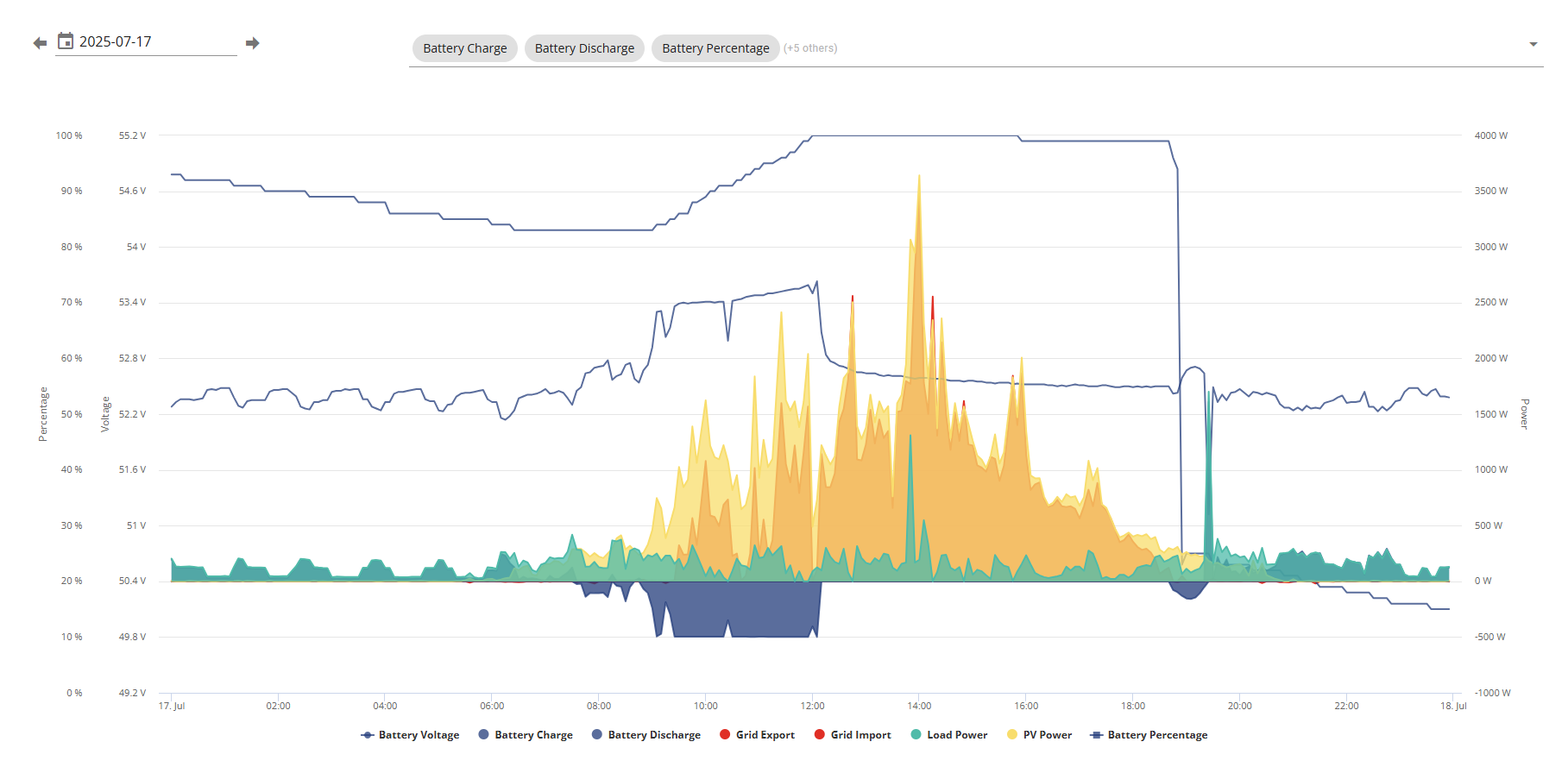

Displayed SOC dropped from 100% to 99% where it stayed despite surplus solar.
Next there was a near instantaneous displayed SOC drop from 99% to 23%.

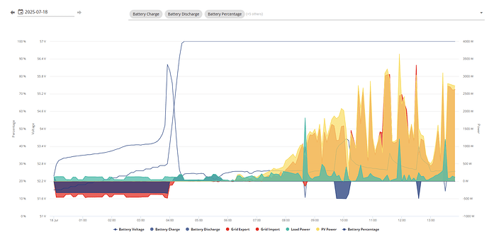

Overnight timed charge stopped the SOC dropping further but continued until the over voltage limit was hit (56.21V) causing the displayed SOC% to jump from 30% to 100%.

I’m still hoping for a fix to my overcharging / voltage fanning problem.

I had two massive displayed SOC% drops/corrections a couple of days apart. The first was on 3021 and the second on 3022. The good news is that 3022 is not necessarily the cause. Bad news is 3022 has not fixed it!
