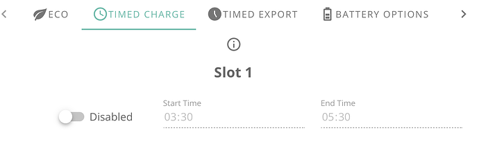

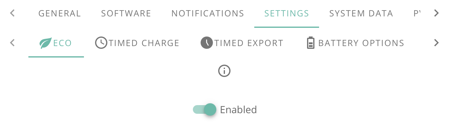

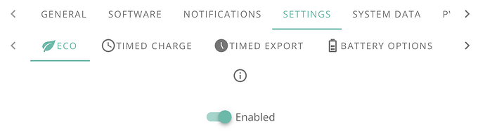

On the portal, go to Inverter/Settings
  1. Your default inverter setting should be ECO

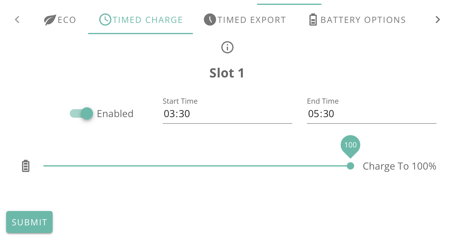

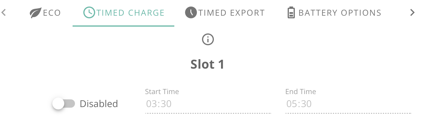

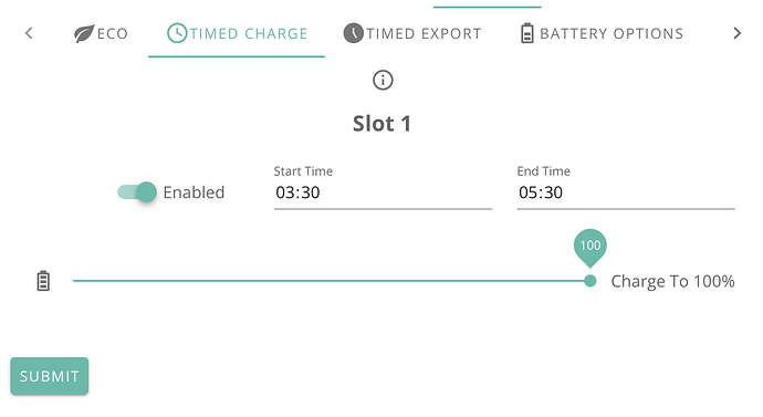

  2. Select Timed charge.
  3. Change Disabled to Enabled,
    Input the times you want for your timed charge (match to low tariff slots)
    Select Submit
  4. I would then go back to Eco but the timed charge should kick in to match the time you have input. When the time period is completed, the inverter should automatically go back to Eco
    This should be repeated each day.
… and that should be it.
