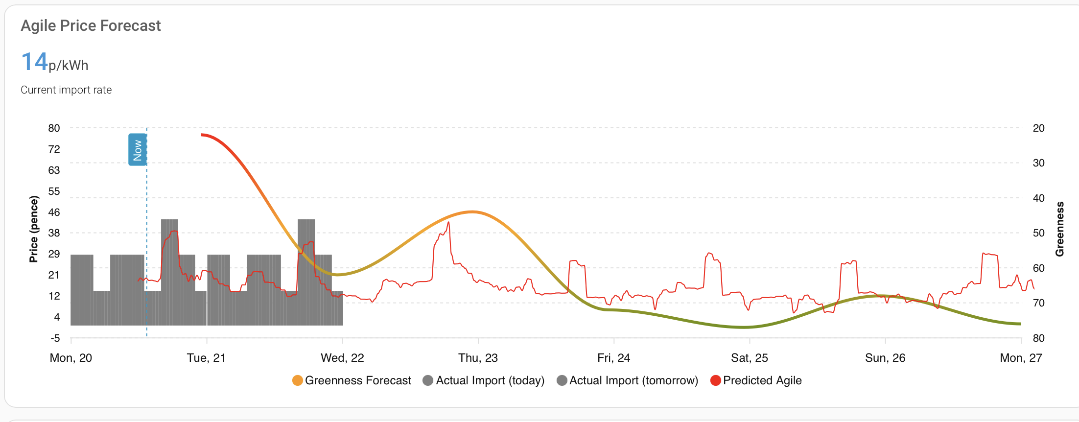

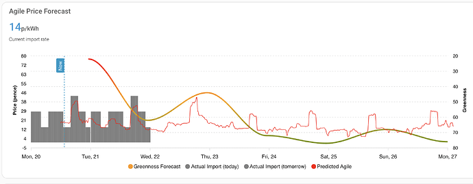

Keep an eye on Agile rates, the Agile price predictor is quite useful for this

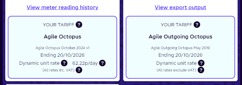

And I have just checked the portal - and am on Agile in and outbound

I wonder about your choice of Agile Outgoing. Most of the time Agile Outgoing pays less than the 15p Fixed outgoing rate, so generally its better to be on Fixed outgoing which can be paired with Agile Import fine (that’s what I was on before).
Having said that, in winter, I export very little, my heat pump consumes all I generate and for me 30-40kWh is also not untypical, so I figured the only time I would be exporting solar would be when its a DFS saving session when the outgoing agile rates would be high, so I was also on Agile outgoing for the deep winter period.
It was more profitable than fixed outgoing for those reasons, I just left it a bit long to go back to fixed and we were starting to export regularly in february as solar generation increased. So yes to agile outgoing but for me only in the real deep winter
