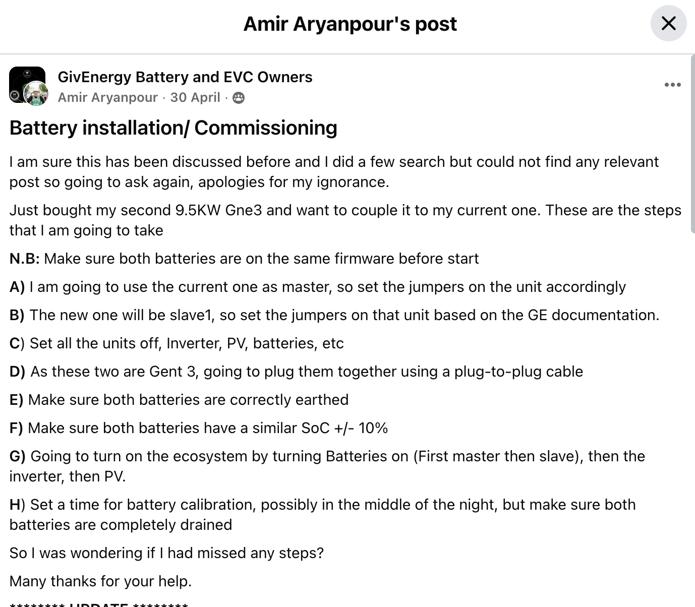

Hello Hampers. I am connecting my additional battery but my electrician assures me it will still need to be commissioned.. So, could you please tell me where I can find info. about the 12+ steps on the FB GE (?) groups.
He’s 100% wrong..

For anyone els coming along later, this is the FB group post. Redirecting...
