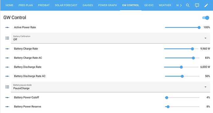

P.S. I forget to add what I have done (in Home Assistant). I found my batteries discharged to quickly when set to the full 6000w each, plus the slots I have for charging did not require the full 12000w (6000w each AIO). One other thing to note is the GE system looks at the different % settings and moves them up or down to suit. So I wanted import 10000w and export 6000w, my setting has ended up at 9960w & 6000w, decided by 2 for each AIO.
As I wanted some battery incase of a grid outage I have set a 8% reserve.
