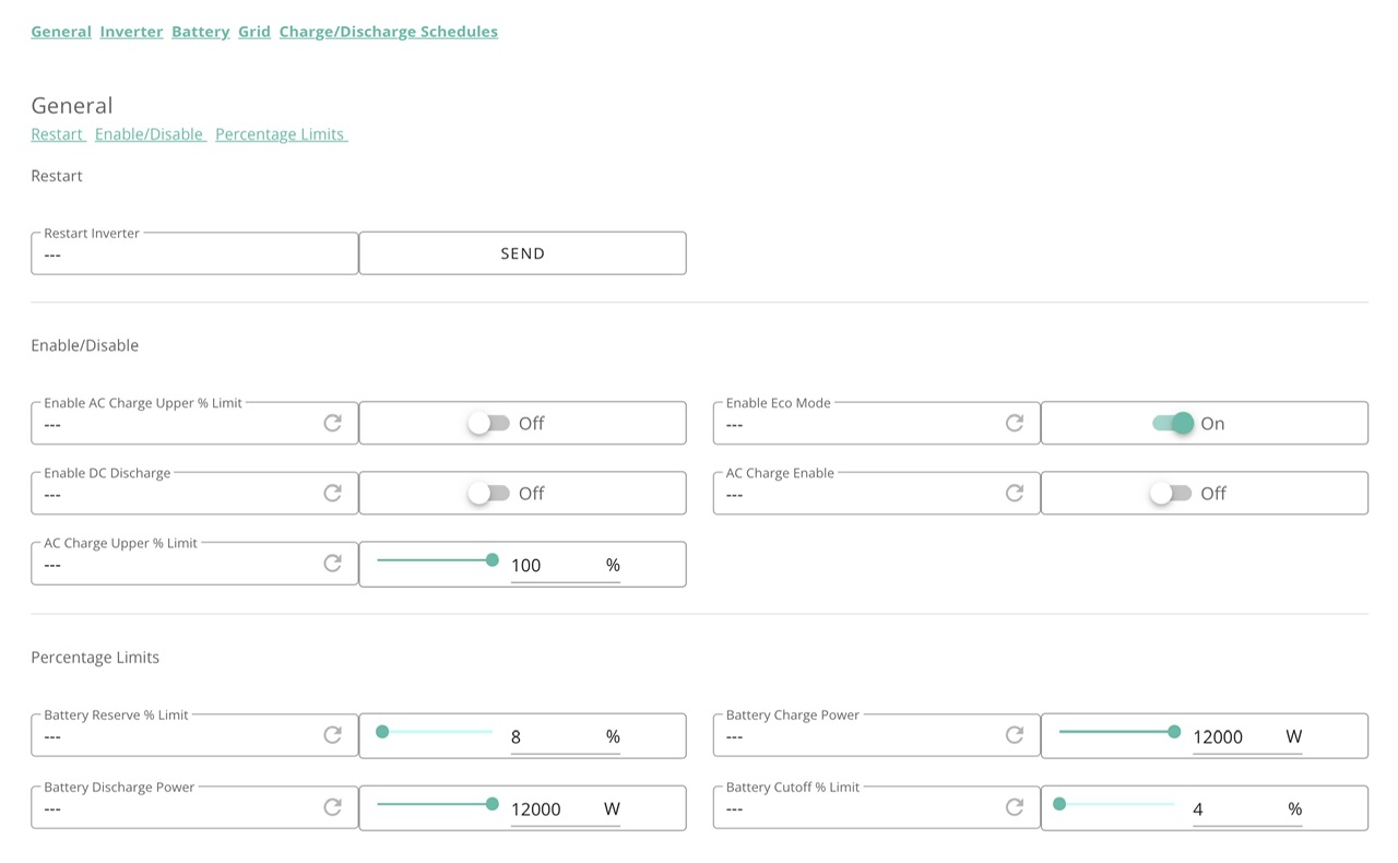

I found the battery cut off % limit as well, and this is set to 10%. My understanding is that this should be the limit at which everything stops.
So my question is why does the EPS not work in this way - reserving the 50%, activating the EPS in a power cut, and continuing to run until the cut off limit?
