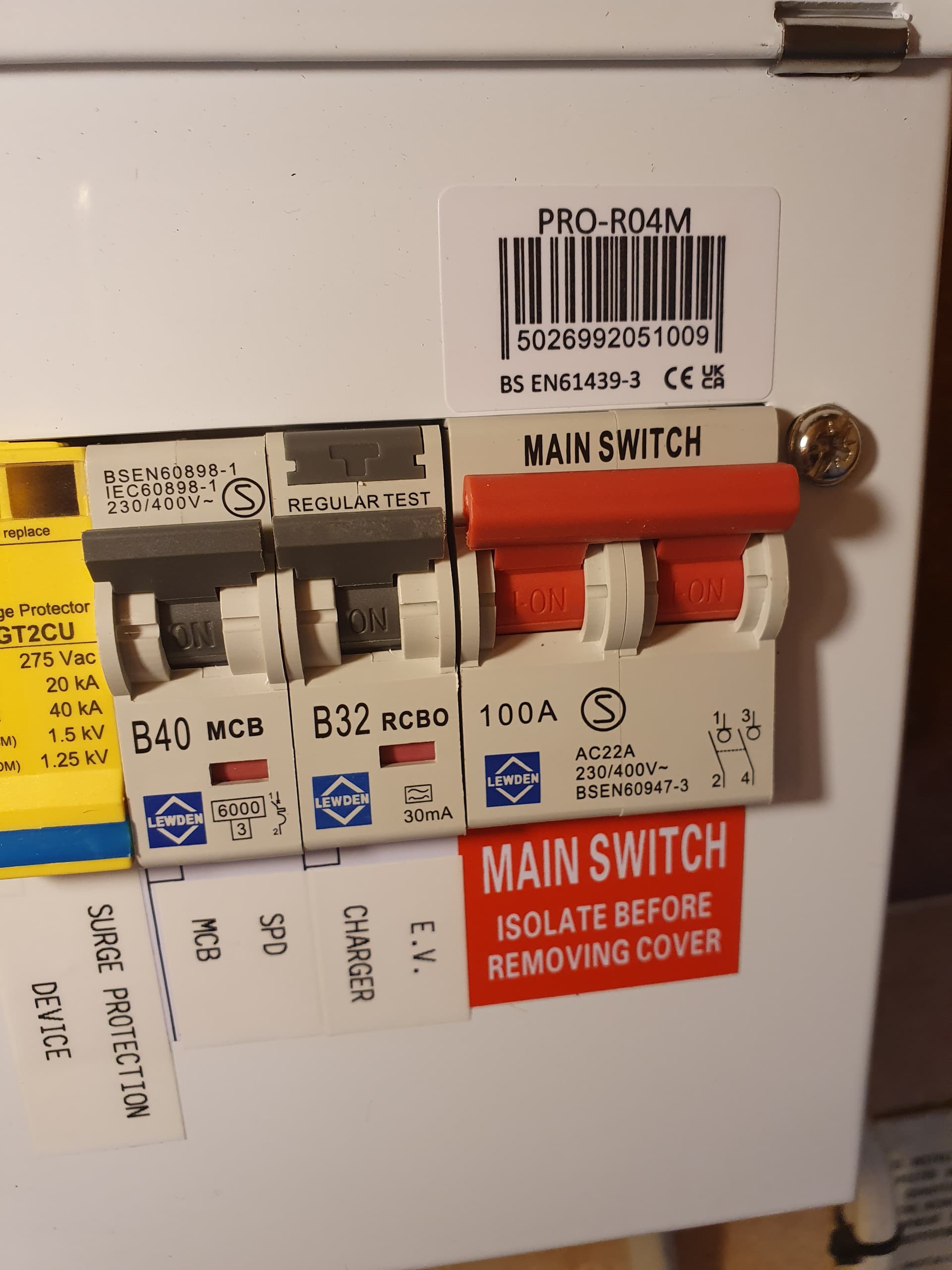

I’m including pics of EVC and fuse box.

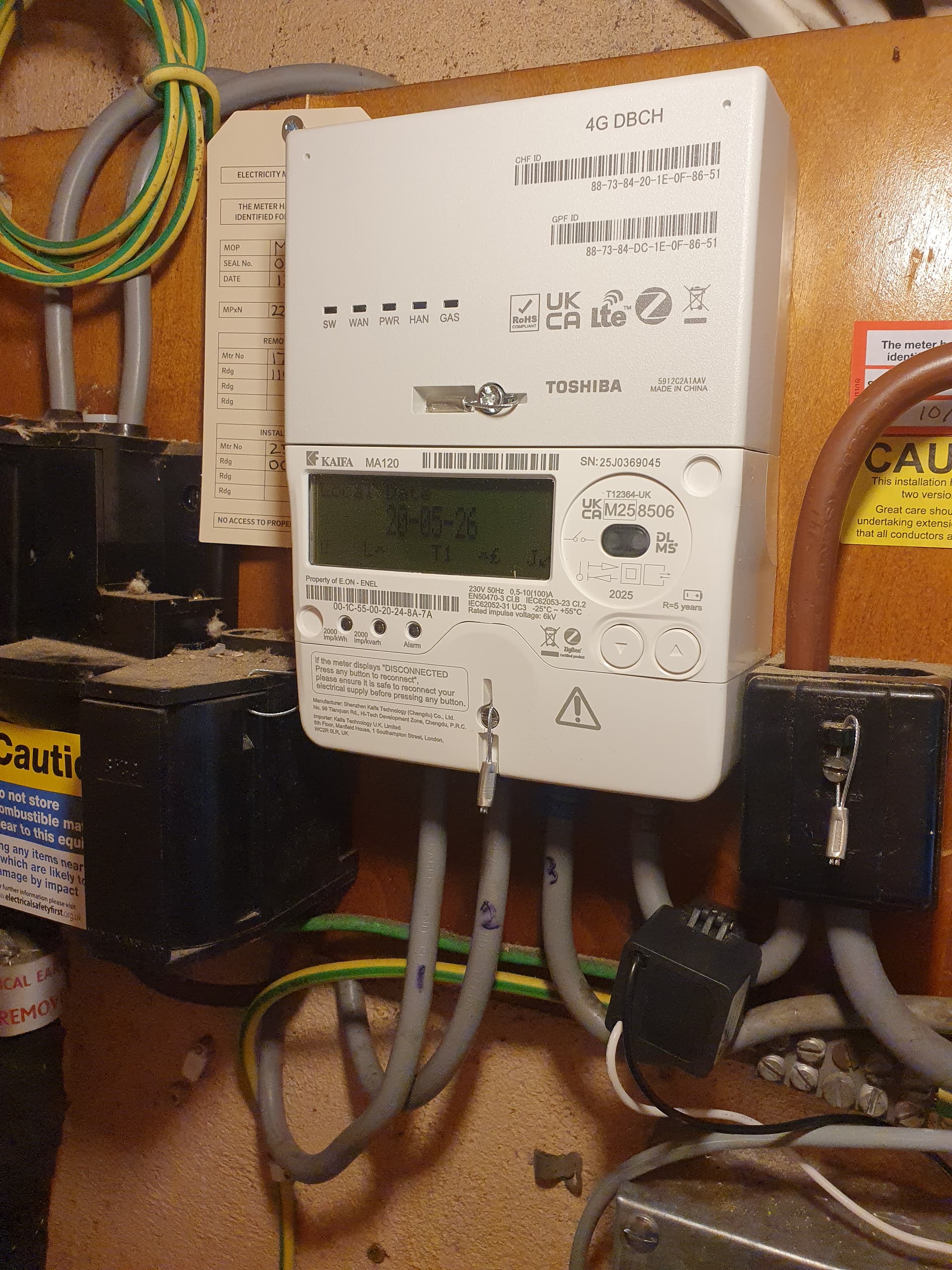

You said the problem came after a meter change so you need to go to the meter house. Your looking for the little meter and…
the CT clamp that goes aroung a big brown cable.
This shows new smart meter and I think the little clamp.

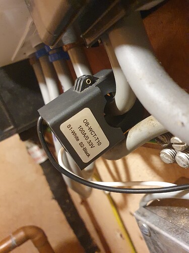

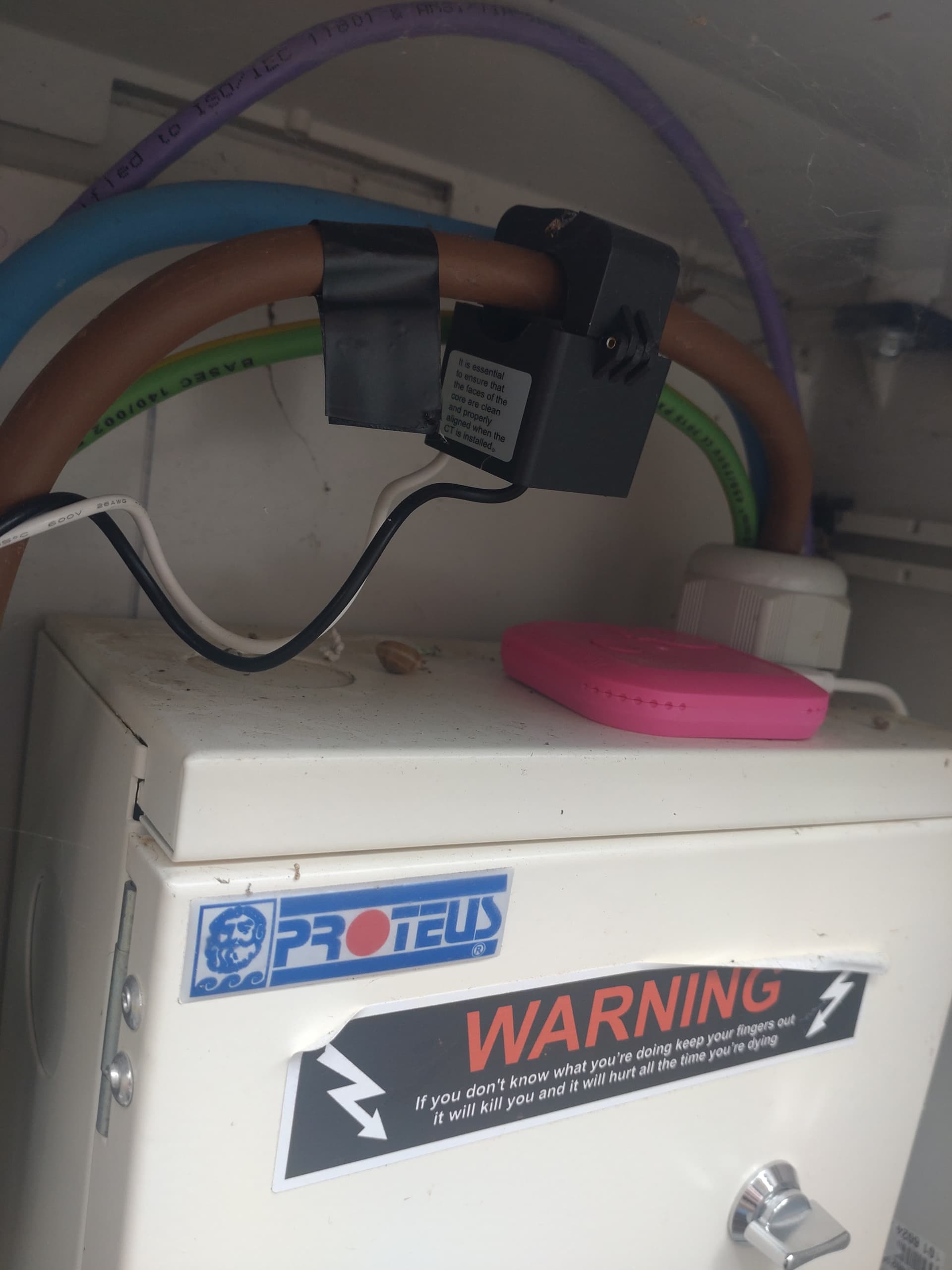

It’s on wire 4 which looke like the live. And it’s also pointing the right way. But it doesn’t look like it’s tight to the wire. Can you check it it has been clipped closed properly. Look how mine sits snuggly on the cable. If it’s not clipped closed, it won’t work.
Its not snug, it moves easily, but it looks like it only has one closed position.
OK. That’s the problem. It isn’t closed. You have to have both sides of the ferrite core touching. It looks like it’s going to be difficult to get it to shut there. So it depends on how you are using the EVC. If it’s not for anything to tricky like charging off excess PV, then you could move the CT to the right. I’m guessing the big brown wire to the right is going to the EVC. You could try moving the CT clamp to that wire. Make sure you keep it exactly the same way round i.e. facing the EVC with the black on the right. Try this and if the EVC works, you’ll know that was the fault.

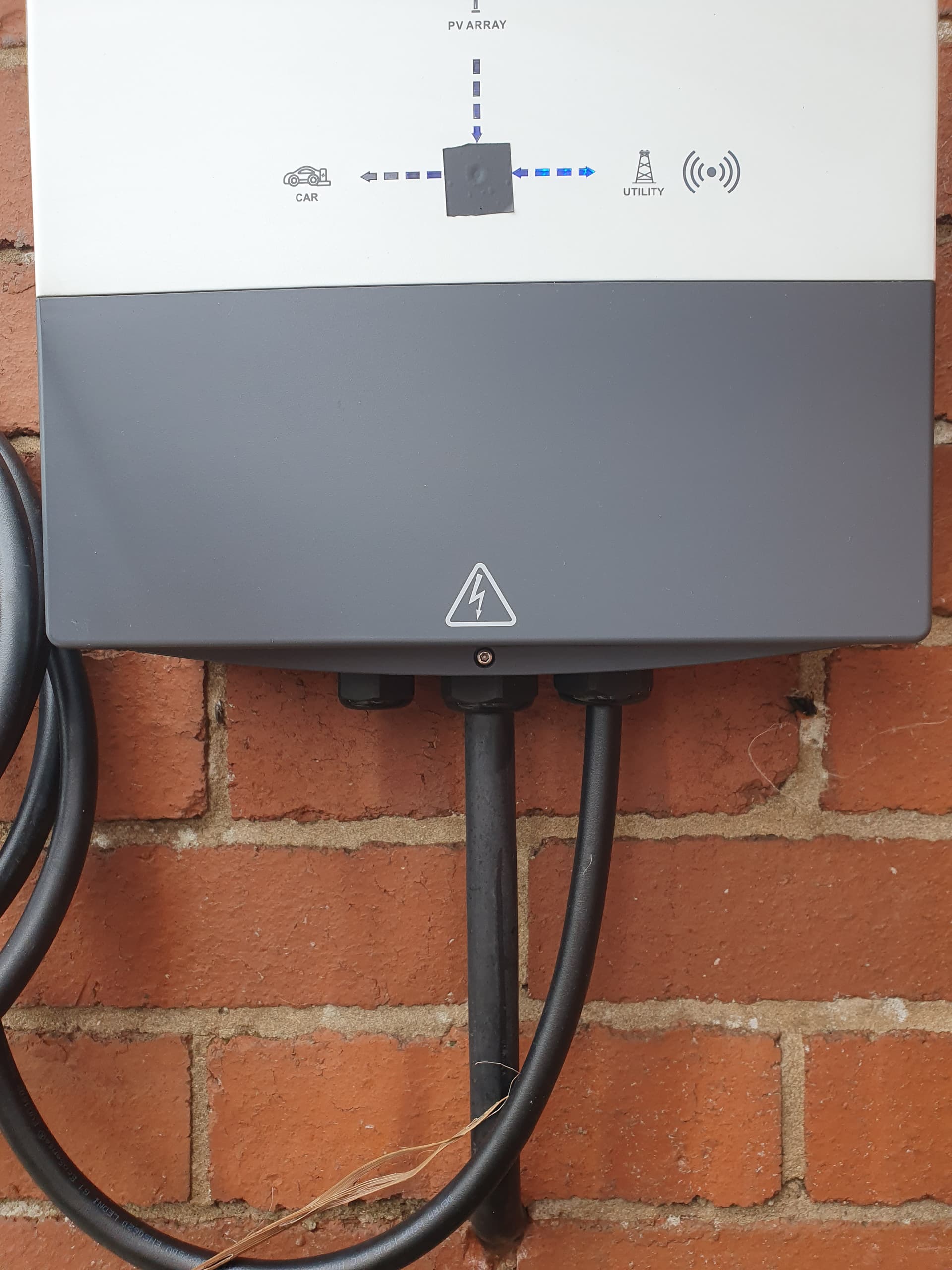

Bit concerned, no QR code, no sticker, have founf the installation instruction manual left by installer but no QR code anywhere to be seen… been trying to contact installer and so far no reply… Ive taken off the front lower cover but nothing in there. Could it be elsewhere? Can I open the unit up further?

The smart meter upgrade is good. It just looks like the “jaws” of the CT aren’t shut tight. Unless both sides of the ferrite core are touching it just won’t work. It might be clipped so it won’t fall off, but it’s not shut tight. Try rotating it and squeezing it closed. Maybe even putting something behind it to stop it from moving back when you close it?

Go to the app’s EV section, choose settings, then chose “change EV charger WiFi”
Then it was easy from there. Asking for serial number and password which WERE on the side of the charger, just didnt see it as quite close up to a wall.
It then asks for your house wifi details.
And the fuse Ampage on the EVC fuse box.
Then is just all updated and is back working. :partying_face:
