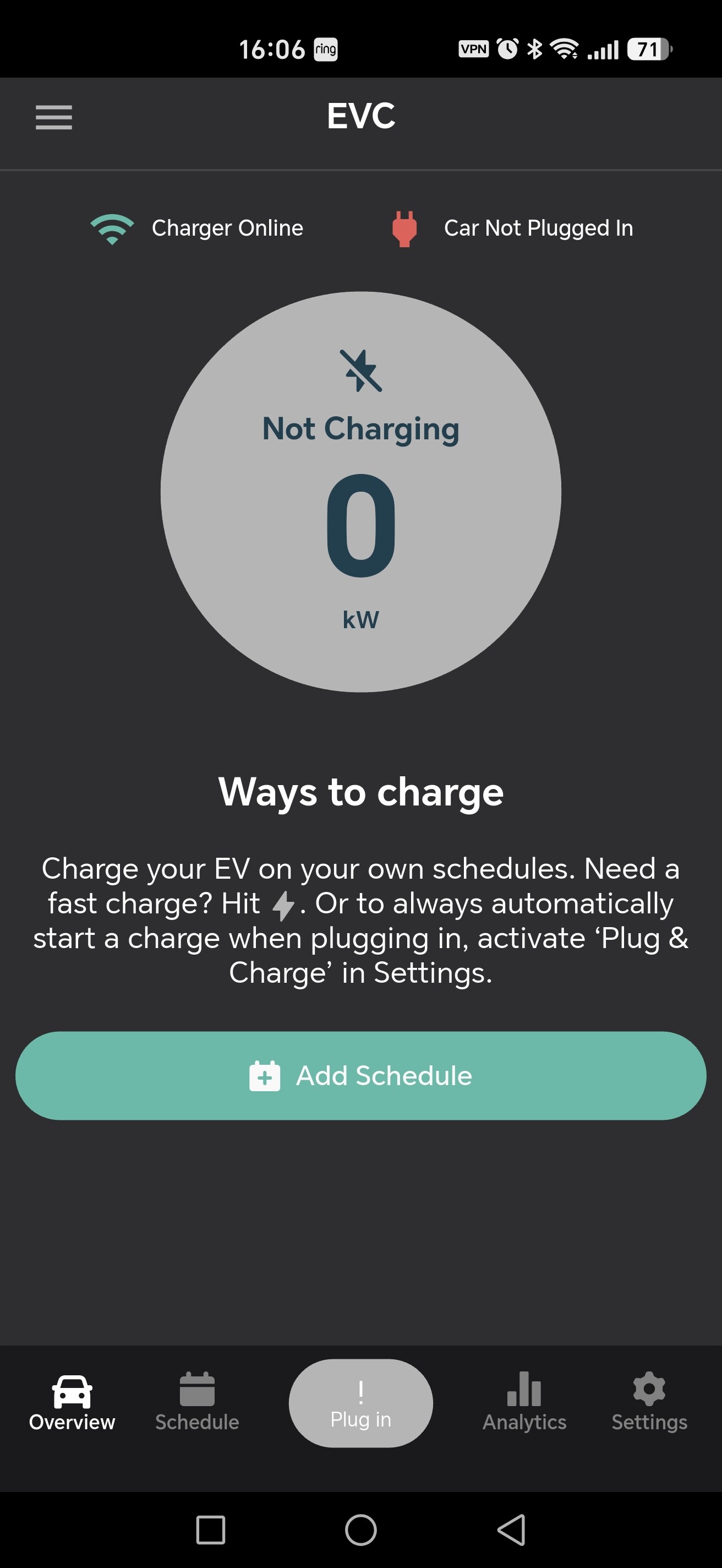

I’ve been having a play with my newly acquired EVC, it’s not fitted but I have it powered just to get it online, I can get on local control via GIV-OCPP / homeassitant.
I can’t add it to Givenergy though, the app just goes in a circle from the QR > processing > QR > processing.
I’ve been back into the web GUI, changed the server back to givenergy, had it wired directly to the inverter using the dedicated comms.
Final shot was trying to use the cloud dashboard, this is where I found the issue…the charger is registered to another account..
