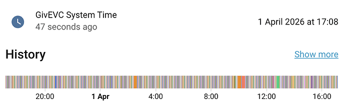

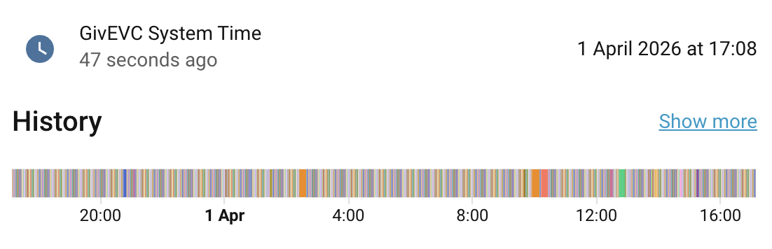

I have added the system time entity to track when it goes offline.
The EVC is on AC_GL1_1.12, we have been on and off taking to Giv about it since last March too, we’ll have a few weeks of stability and then the charger just goes offline.
