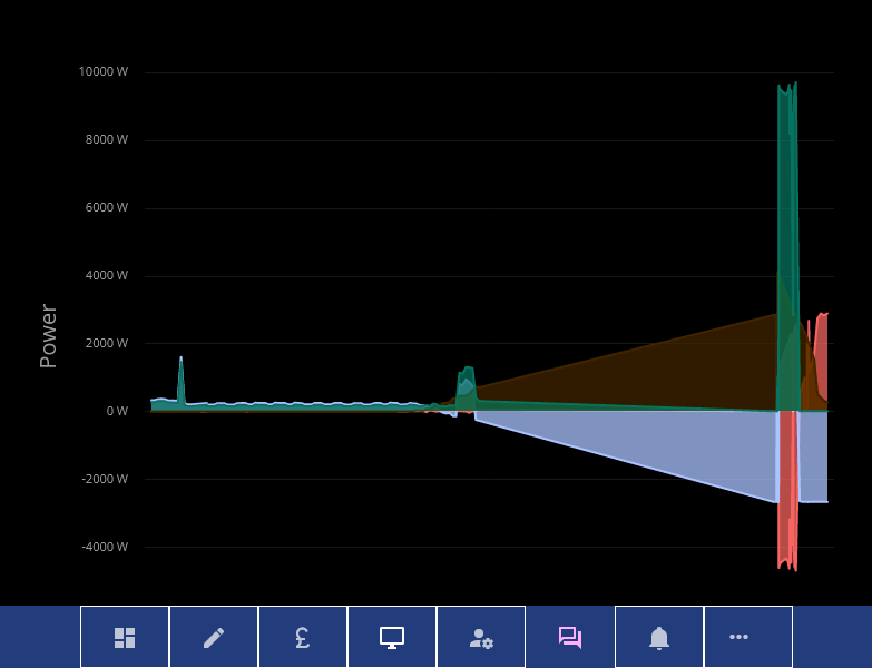

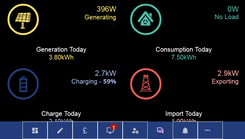

Hi, had an electrician (not my Giv installer doing some work for a heat pump. He upgraded the fusebox. Powering back on the GIV-HY5.0 Inverter is all wrong.
The house is showing as no load and the imports and exports seem to make no sense.
First it appeared to be importing 9kw (pic 2) so switched everything on an off. That seemed to calm it but the battery appeared to be charging from grid (uninstructed)
I wondered if the clamp was not connected right ?

Thanks was my instinct. When i put the microwave on the exports went up and vice versa!
