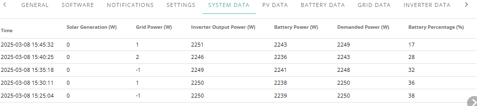

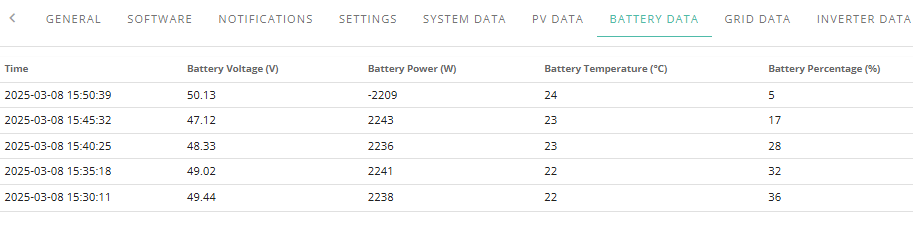

Running a calibration at 75% discharge power on an AC3 and noticed a double dip, rather than 4% on the 5 minute refresh an 11% happened. Currently on firmware 4008, anyone else seen a capacity issue with the gen 3’s?
Scratch that, it went from 28% to 5% in less then 10 minutes so worse than i thought
