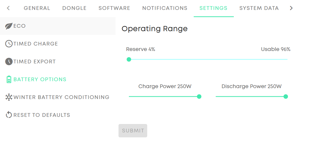

I’ve attached a screenshot of what I think are the relevant settings.
Reserve is set to 4%.
I cannot see settings that refer to AC charge enabled or battery pause. Where might they be?
Thanks again
Paul

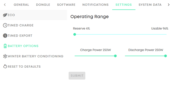

Sorry this is the screenshot I meant to send above (you can only send one image per post!)
Odd that the charge and discharge power are both (only) 250W, I’d expect 3600W
256W seems to be as high as you can set it

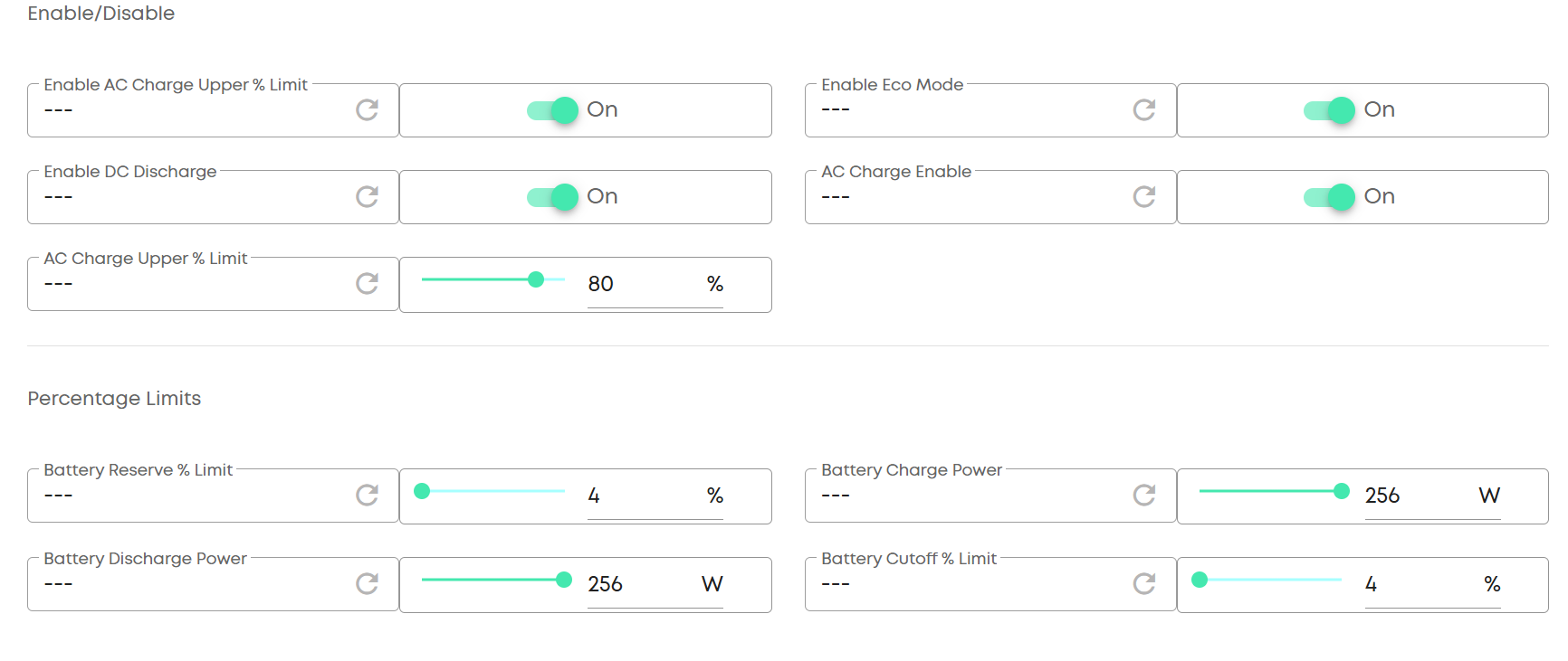

I’ve doe as suggested by @NormC - I cannot set my discharge and charge settings to above 256W (so that is weird).
Screen shot attached.
In other news - installer coming on Friday and has a booked called with GivEnergy to try and sort things out.
Any advice in the meantime would be gratefully received!
Paul
AC charge upper limit should be 100% not 80%, and you can turn ‘enable AC charge upper limit’ off so your inverter uses the full range available

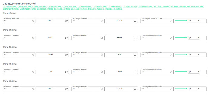

In the top left corner of the Remote Control page is a button ‘Jump To Logs’. This will take you to the bottom of the screen where you can view the ‘Remote Control History’.
Click on the ‘All-Time’ option to display all the commands that have been sent to the inverter. This may give you an insight of what has happened.
If you start from when the inverter was commissioned and come forward through the pages you should be able to see when the values for Battery Charge Power and Battery Discharge Power were changed and who by.
Look under the User heading and under the Via heading to see who made changes and how it was changed.

Hi again,
From what I can see the Battery Charge/Discharge power was set to 256W when I did a ‘Reset to Defaults’ (my first attempt at trying to sort things and based on some internet research). I did this on the 5th Oct.
Logs also show that server keeps setting and resetting charge and discharge times according to the Cosy tariff settings (I moved to the Cosy Tariff on the 10th Oct). It is changing these setting daily it seems - or is this just the automated command from the integrated tariff?)

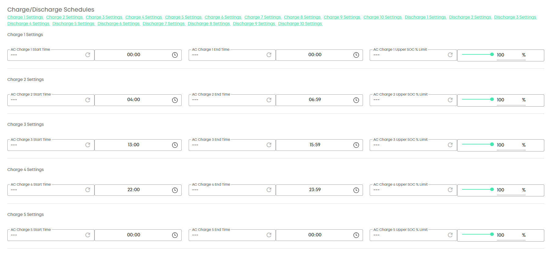

Are you using the Smart Tariff Card? If so the server will control your system to follow the tariff you are on.
I am also on Cosy but I do not use the Smart Tariff to control the system. If you look in the Remote Control section of the portal you should see that you can set 10 Charge and Discharge slots yourself.
I never put anything in slot 1. If anything sends messages to your inverter it will overwrite this slot. Such things as Winter Battery Conditioning will do this.
I can then control when I want the battery to charge just by turning on / off ‘AC Charge Enable’.
