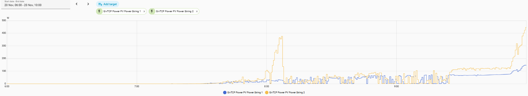

In the mornings I am seeing this via givtcp now:

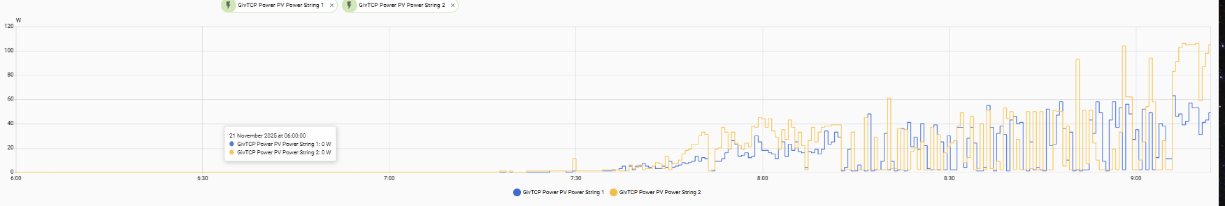

Yesterday was this:
Note this is for each string - almost like the mppt isnt able to pick the sweet spot?
