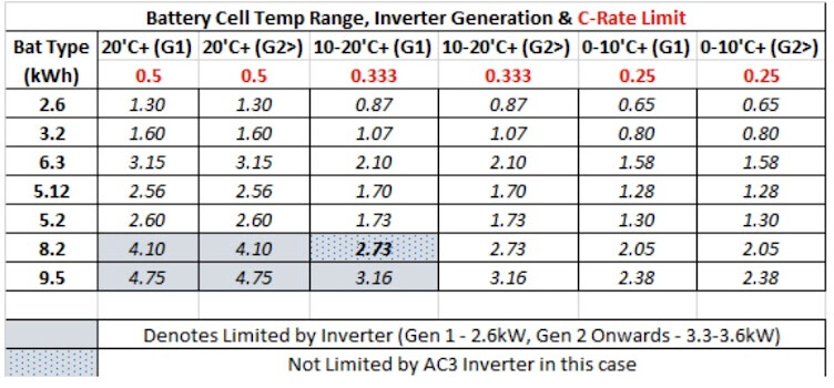

Your battery charge rate is affected by temperature, and if the CELL temperature is less than 20 degrees it will charge at about 1.7kWh as you’ve found.
This image was previously shared on the GivEnergy facebook group:
The slowdown is most pronounced on smaller batteries and higher charge rates.
If the temperature drops below 10 degrees the charge rate drops further, and at zero it stops charging completely.
There are some improvements to this de-rating apparently coming in future BMS 3018 version, but don’t know when this will be released. In the meantime, if possible you might consider wrapping the battery with insulation.
Once the battery temperature rises above 20 degrees it will return to full rate charging.
