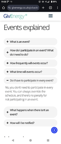

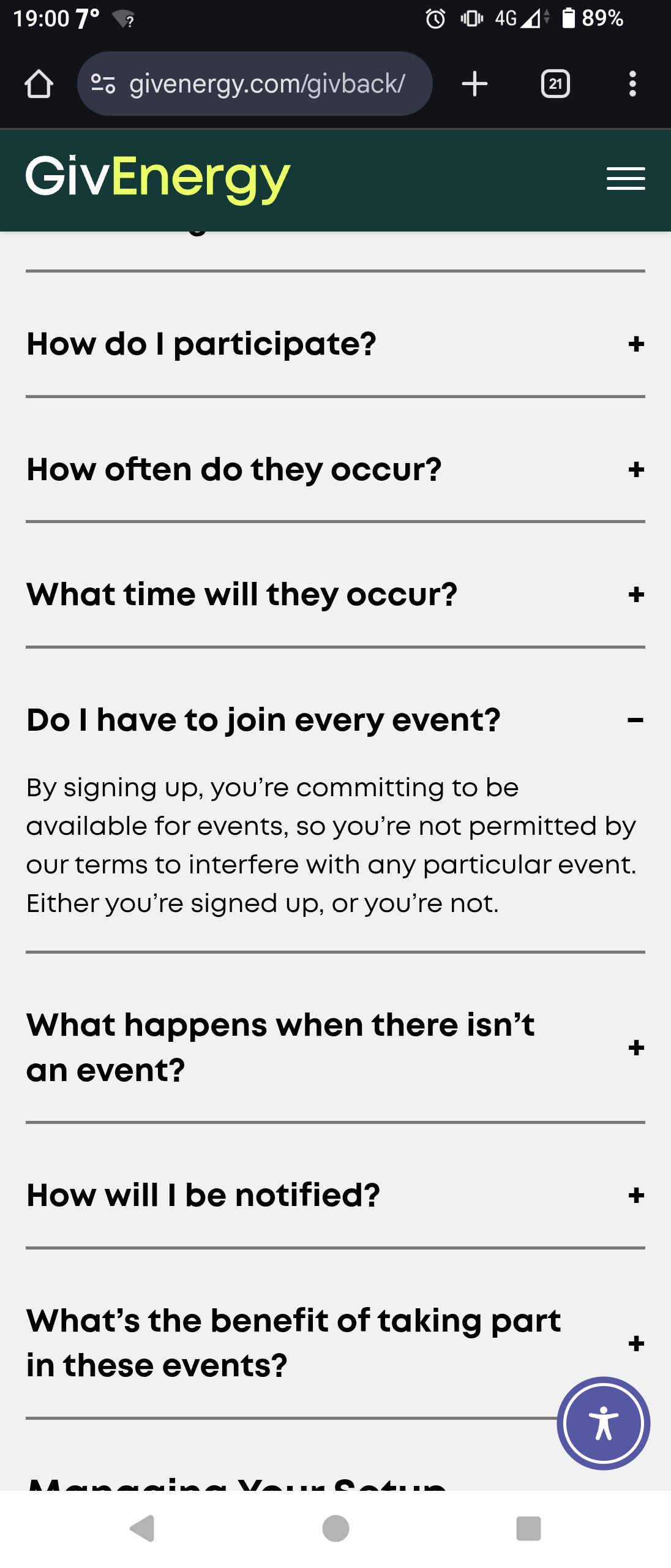

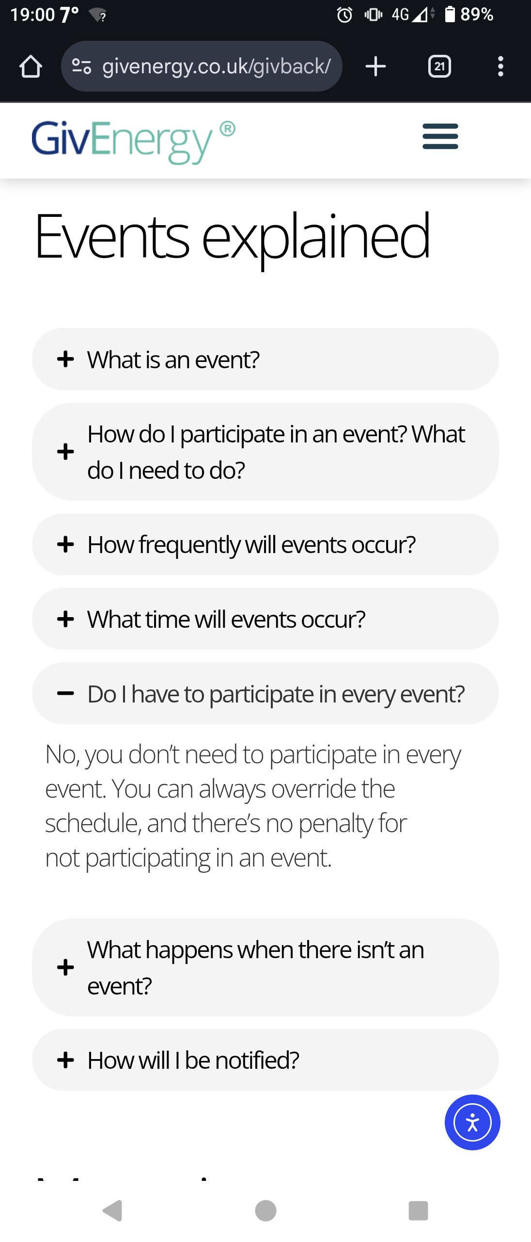

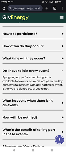

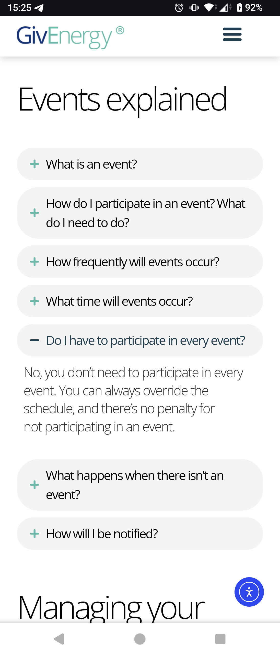

I was reading the Givenergy website, pictured below.
Which is entirely different from the T&C document in the new app, which I guess is the current version. I suppose it was too much to expect the Givenergy site to be accurate.

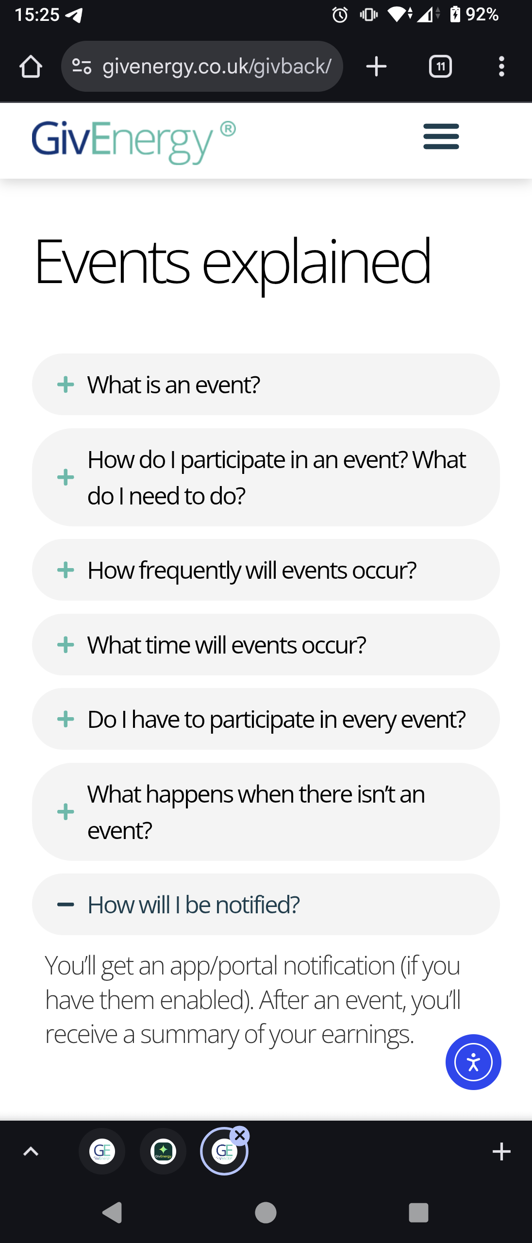

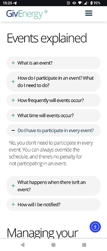

Please edit the FAQ, also published and available on your website, to reflect the above terms and conditions, the aforementioned website reflecting incorrect information including that screenshotted in my previous post above.
Do I have to participate in every event?
No, you don’t need to participate in every event. You can always override the schedule, and there’s no penalty for not participating in an event.
How will I be notified?
You’ll get an app/portal notification (if you have them enabled). After an event, you’ll receive a summary of your earnings.
What if I already have a charge schedule? Will I lose it?
Your charge schedule will automatically adjust for the day of the event, and then revert to your normal schedule immediately after the event. You can also adjust the schedule from the GivEnergy app if it doesn’t suit you.
Also FYI, your copy paste states " Any changes will be posted on our website. These Terms and Conditions were last updated in November 2024."
The GivBack app has terms and conditions last updated August 5th 2025, so you may also need to update that document

Yeah, last year they’d send a notification saying the times and the payment for the event, and the charge time would be set up but I could edit it afterwards.
This event had no notification and no price, so it’s very odd

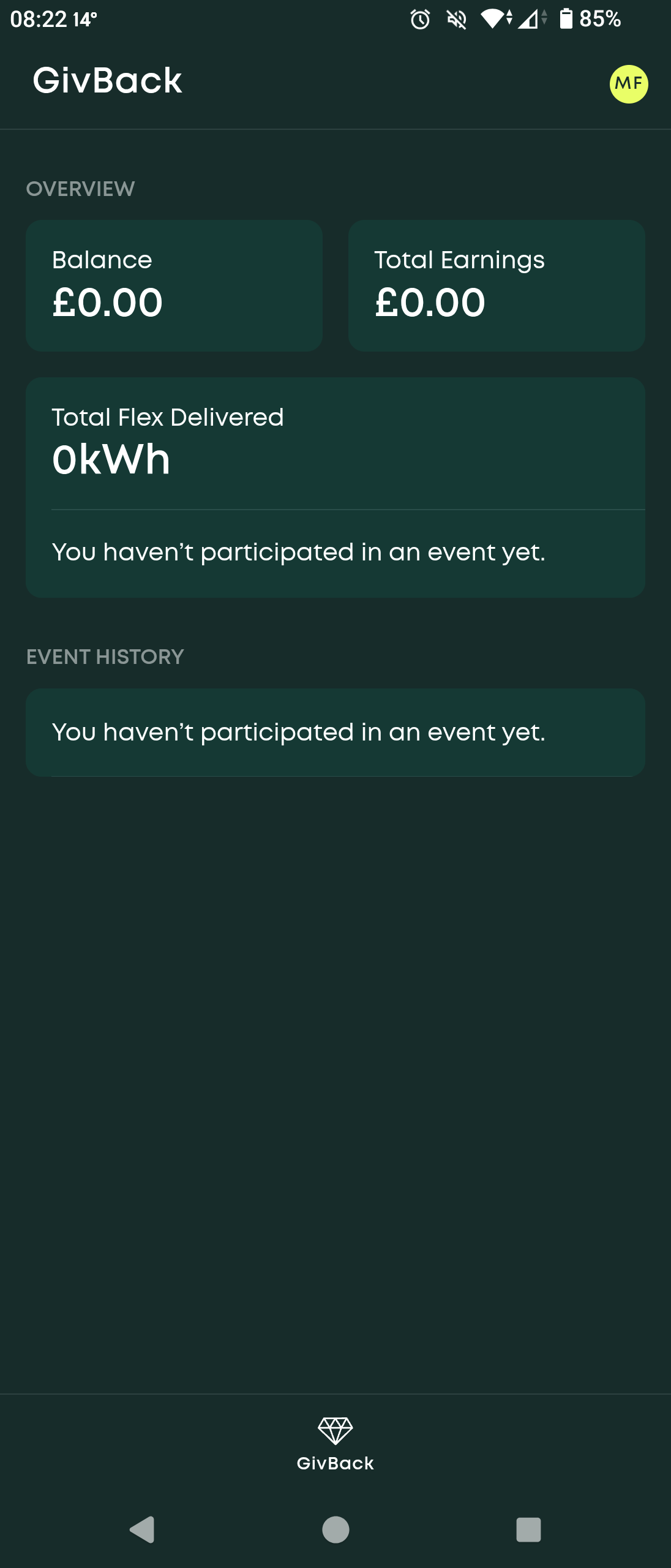

Just FYI, in case anyone else had the GivBack event without any info, my app has now updated stating that I earnt £1.01 for 3.37kWh, which equates to about 29.97p/kWh. Since British Gas charge 26.06p/kWh, this is a profit of 3.37p/kWh for me.

Just FYI because I’m used to finding these issues, the Givenergy.com website has different information on it to Givenergy.co.uk, see below:
This is just for posterity’s sake in case anyone from Giv sees and wants to fix it.
