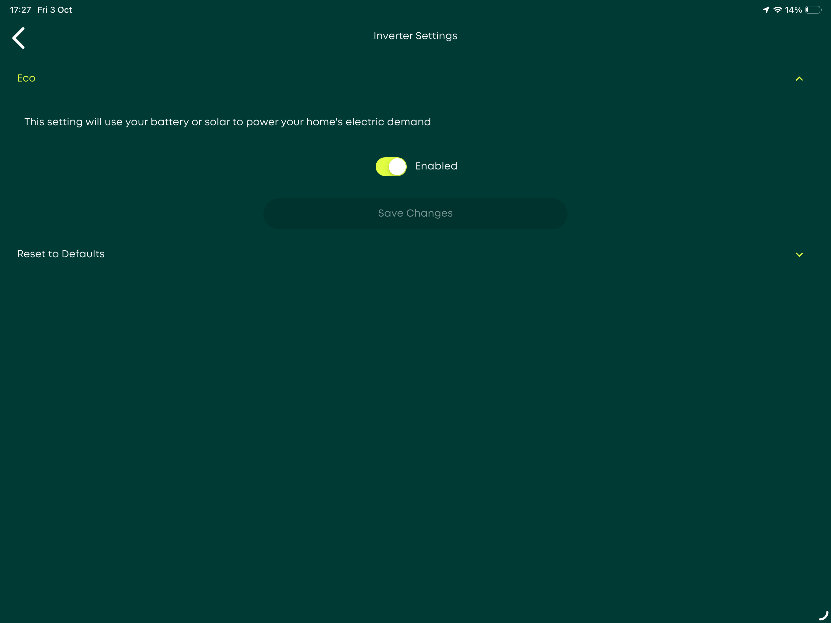

Hi, I would check the GE app.
Click on the cog top right, see if you have this setting turned on?
I think your problem is the discharge periods. The older inverters/BMS don’t automatically switch to Eco mode after a forced discharge, you have to do this manually.
I suspect the smart tariff widget isn’t doing this for you.
Can you remove the discharge periods and just leave the widget controlling your charge periods?
If not you’ll probably have to look at another automation solution
