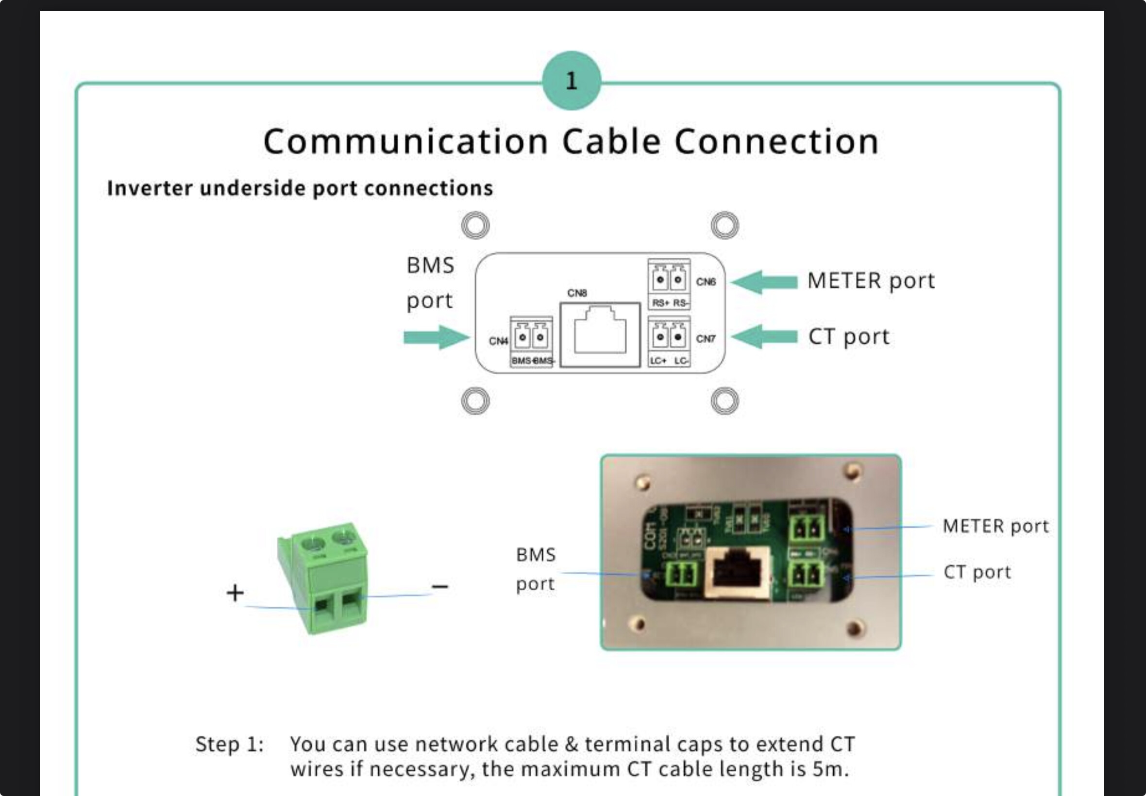

What inverter do you have and are you absolutely sure you have correctly connected the CT meter into the correct connection on the bottom of the inverter?
From the installation manual:
The CT clamp connection goes into the meter connection, not the CT one. I got it wrong myself once when the plug came out
It doesn’t sound like the CT needs to be replaced if it is correctly reading the same as your smart meter, its the cables from that to the inverter, or the plug in the wrong inverter socket

I am absolutely sure all the connections are correct. These were all checked at commissioning and the only thing I have done since then is to replace the comms cable between the Giv-Gem-120-CTM Meter because of the meter comms issue.
