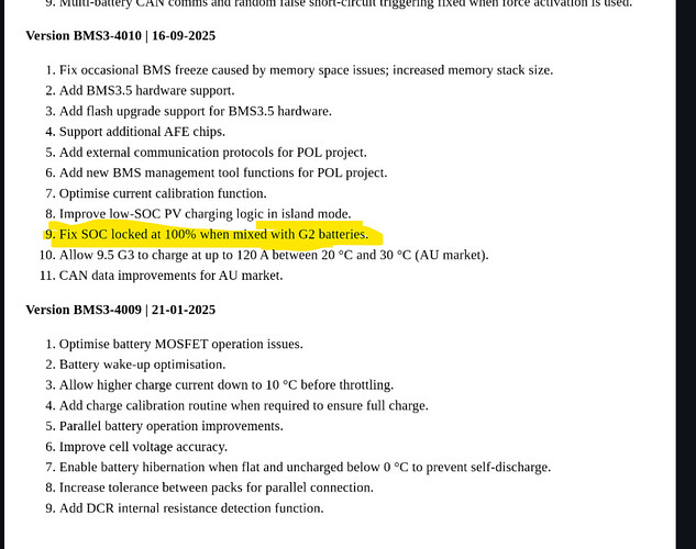

Do you have a list of all the Firmware levels for the inverter and batteries ?
There might be something in the release notes :slight_smile: GitHub - DJBenson/giv-firmware: Archive of GivEnergy firmware files as of 09/04/2026 · GitHub

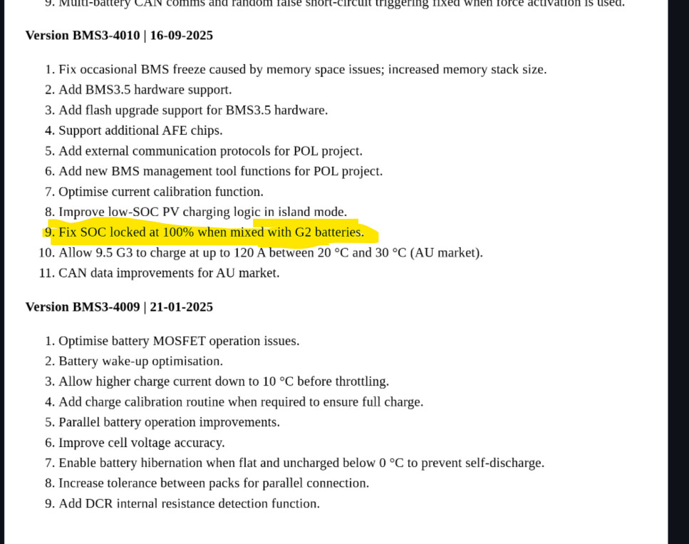

You might need the battery firmware update on the Gen 3 :
and I’d also update the Firmware to 3022 on the Gen2.
