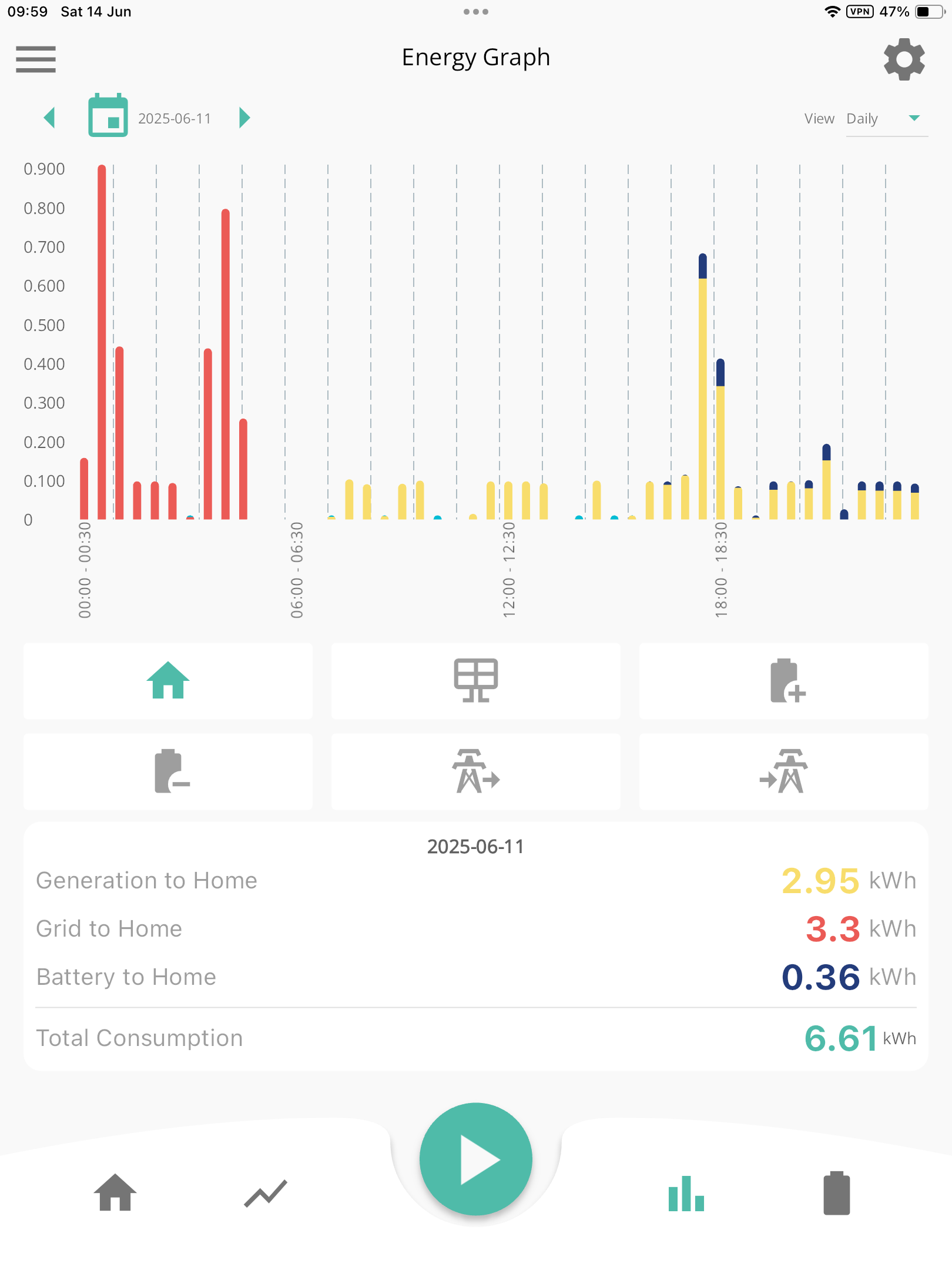

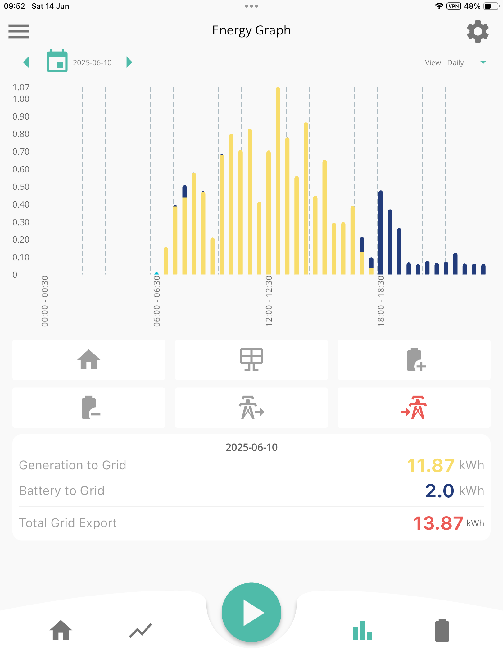

I have noticed that the daily reports emailed to me show solar generation which coincides with when I am cooking an evening meal , say between 7&8pm, when the power is being drawn from the battery . The reports also show battery to grid in the export total, on top of the solar to grid , not sure how my battery is exporting to the grid, any thoughts on both queries

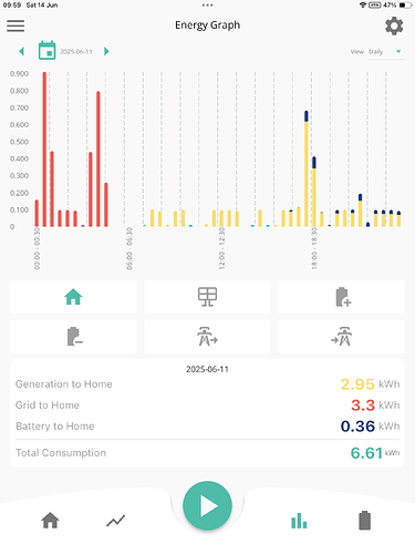

          Here is a typical consumption energy graph showing solar generation in the early evening when I am cooking & using the battery
          So it looks like, the CT clamp is on the wrong circuit or the wrong way round. I would check with your installer.
My neighbour also has GivEnergy products and his totals didn’t add up either.
One of his CT clamps was the wrong way round. I changed it to the right way round and now it works as it should.  Conclusion: Installer error!
