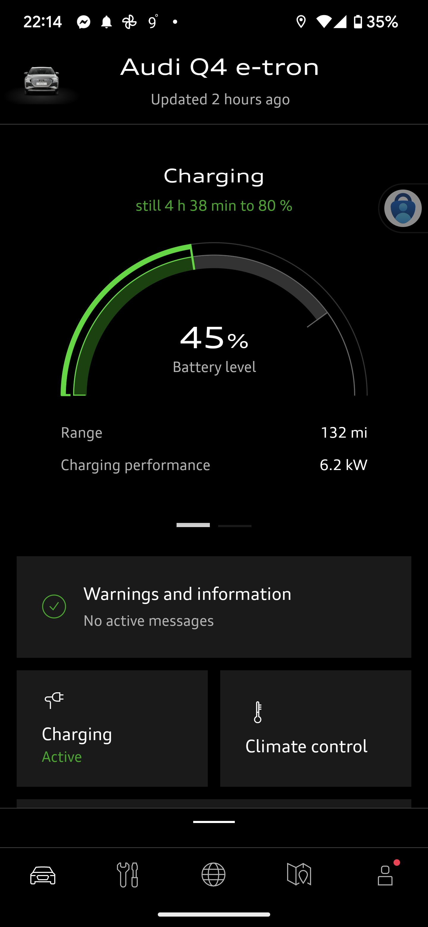

So Last Night I am sure my 2024 Q4 E-Tron with GE EV Charger Charged successfully with Octopus Intelligent Go. Apologies this will be a long post with pictures.
  1. I had enabled Local Control as in my post 5 days ago. This setting is not in the GE Mobile App - had to enable it on the GE Portal in the cloud.

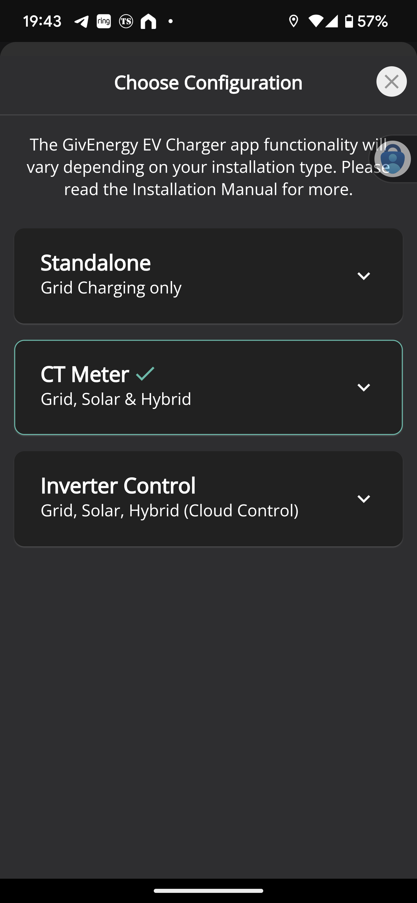

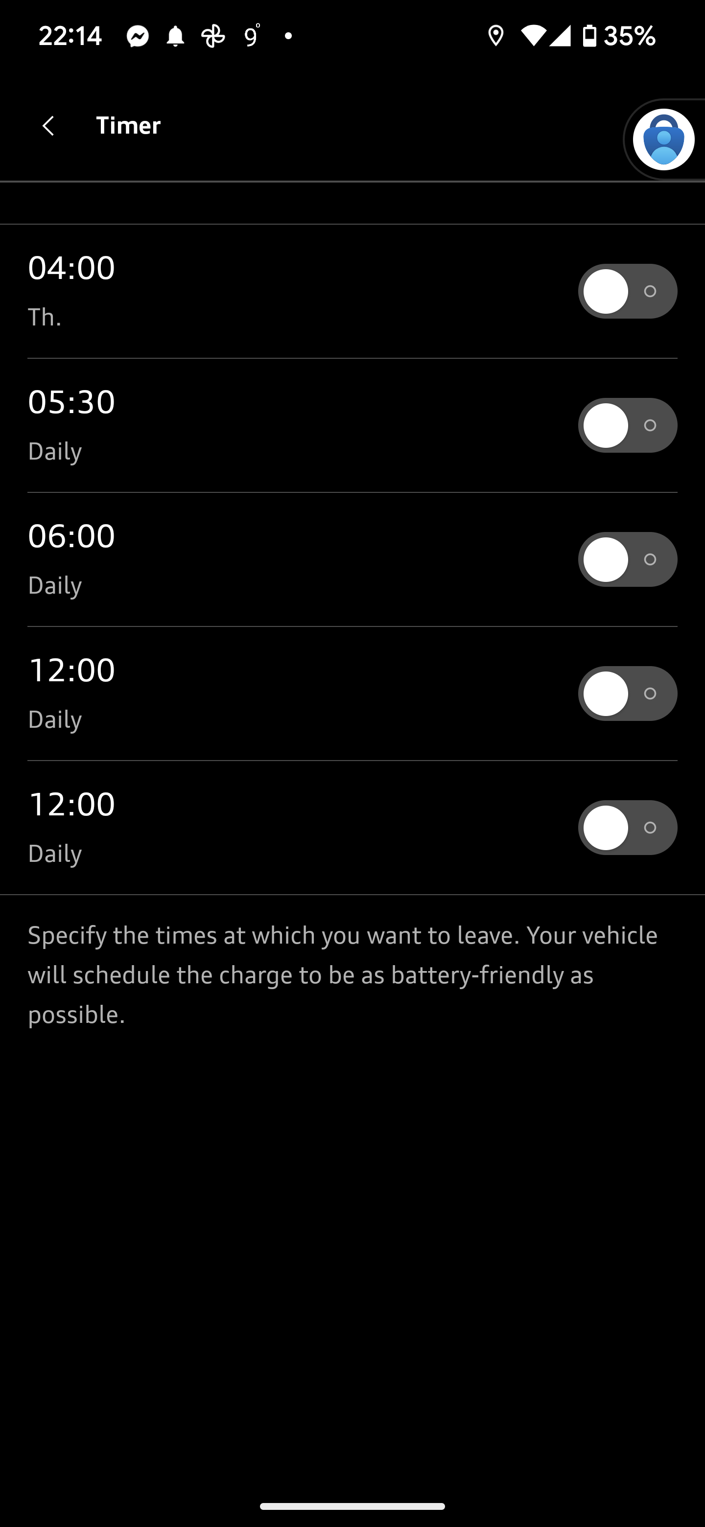

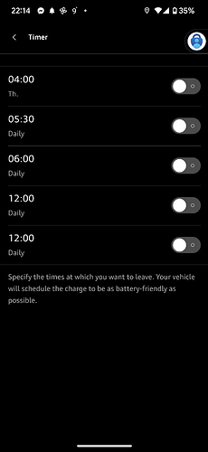

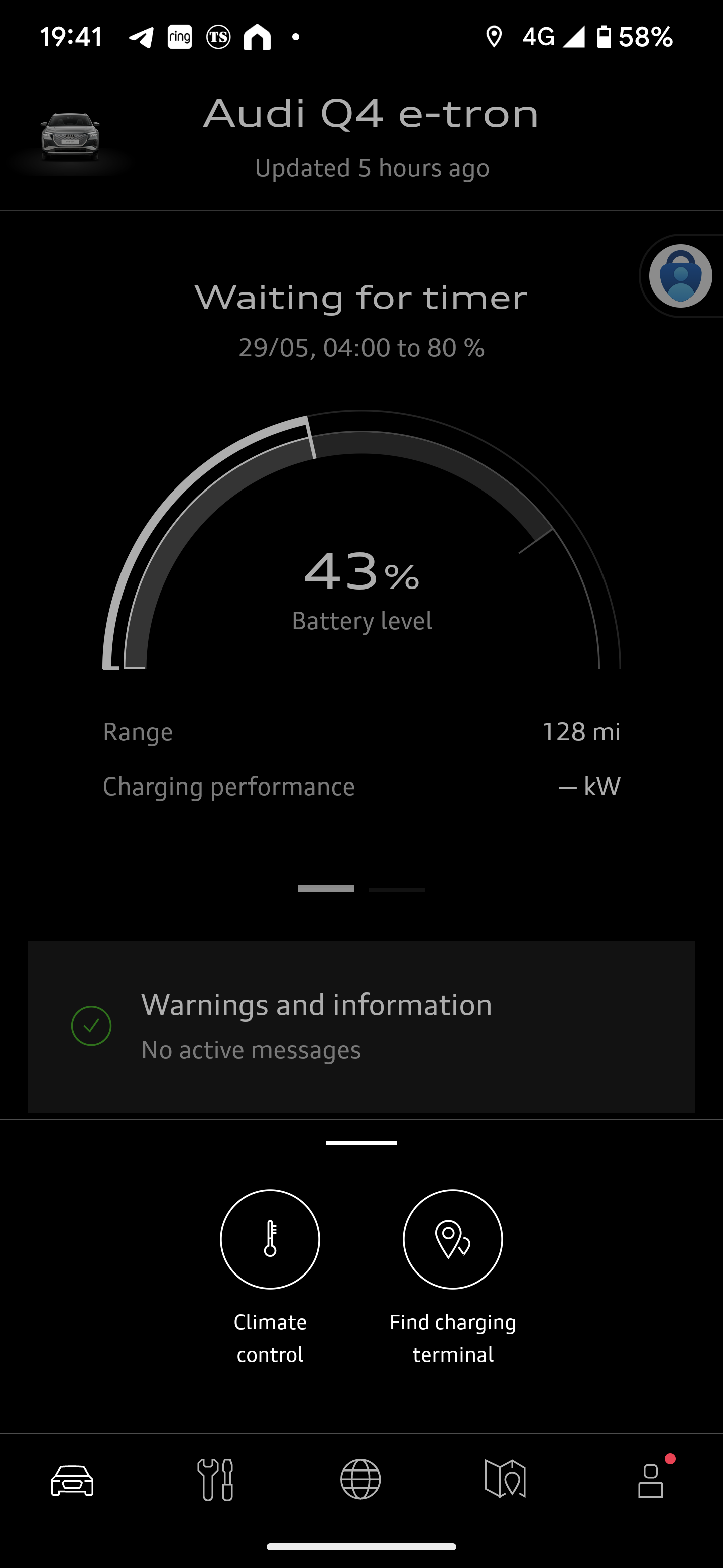

  2. The Car had no home location charging settings enabled, no timed charge enabled, only had the slider below in the MyAudi app set as per the last attempted Igo charge (I think Octopus software changes this setting). The GE charger no schedules set, plug and charge enabled, and Config was CT Meter (Grid, Solar & Hybrid)

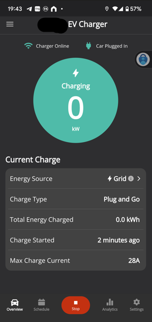

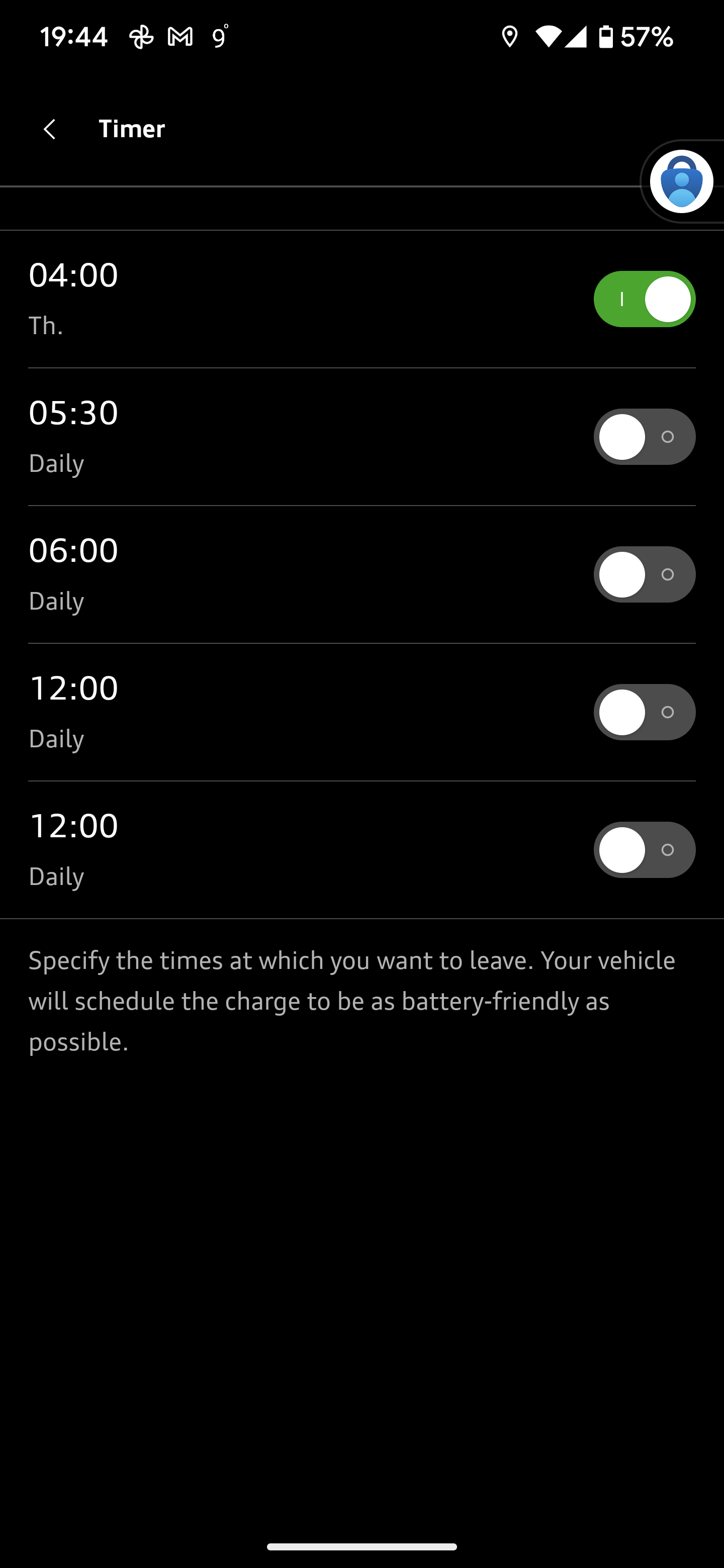

  3. I plugged in the car, and locked it, around 19.40 got white flashing light then green flashing light, no charging. The MyAudi app timer was set for Th 04.00

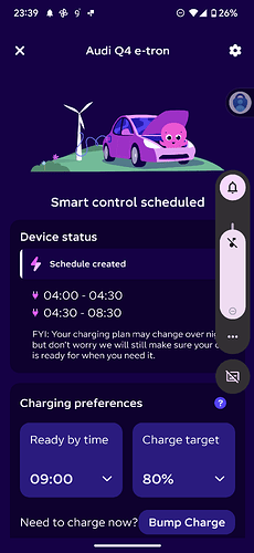

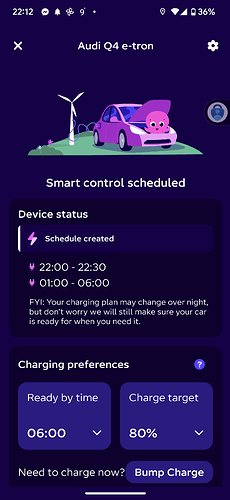

  4. At 19.47 Octopus App detected the car was plugged in, set schedules 21.30-22.00, 22.30-23.00, 01.30 to 06.00

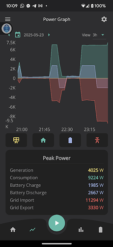

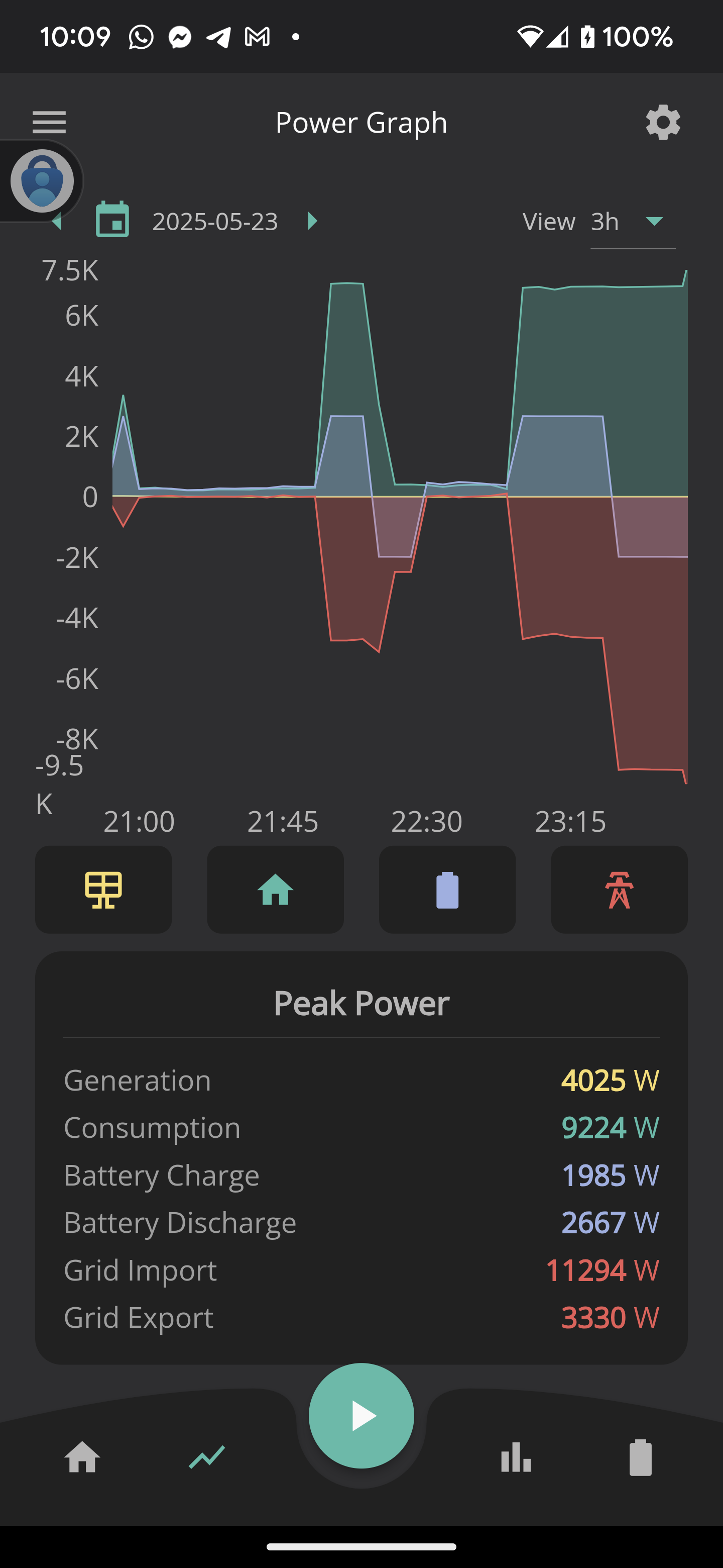

  5. At 21.30 the car started charging and stopped at 22.30 (was also taking from solar battery & grid) but I think this was due to another schedule change - see step 8

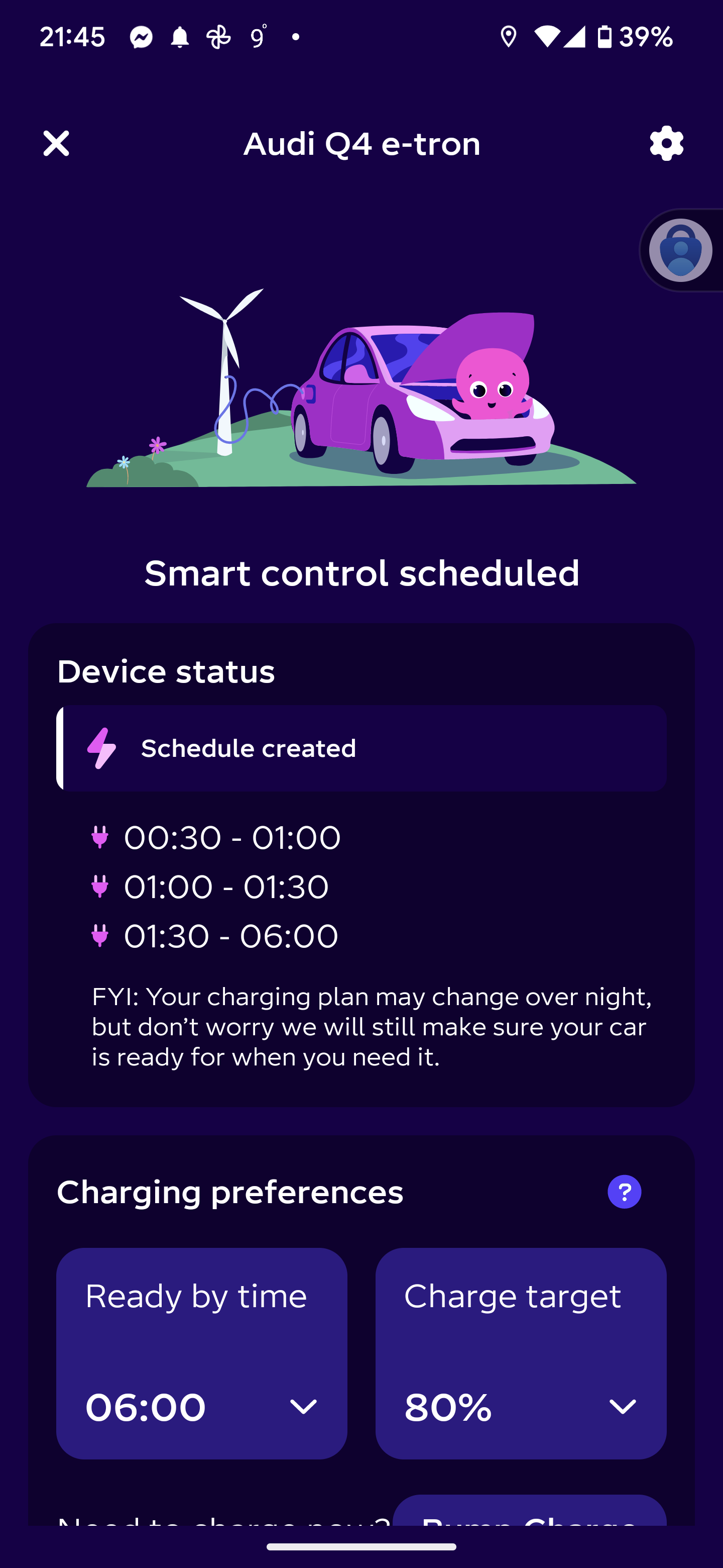

  6. At 21.45 I noticed the Octopus Schedule had changed to 00.30-01.00, 01.00-01.30, 01.30-06.00

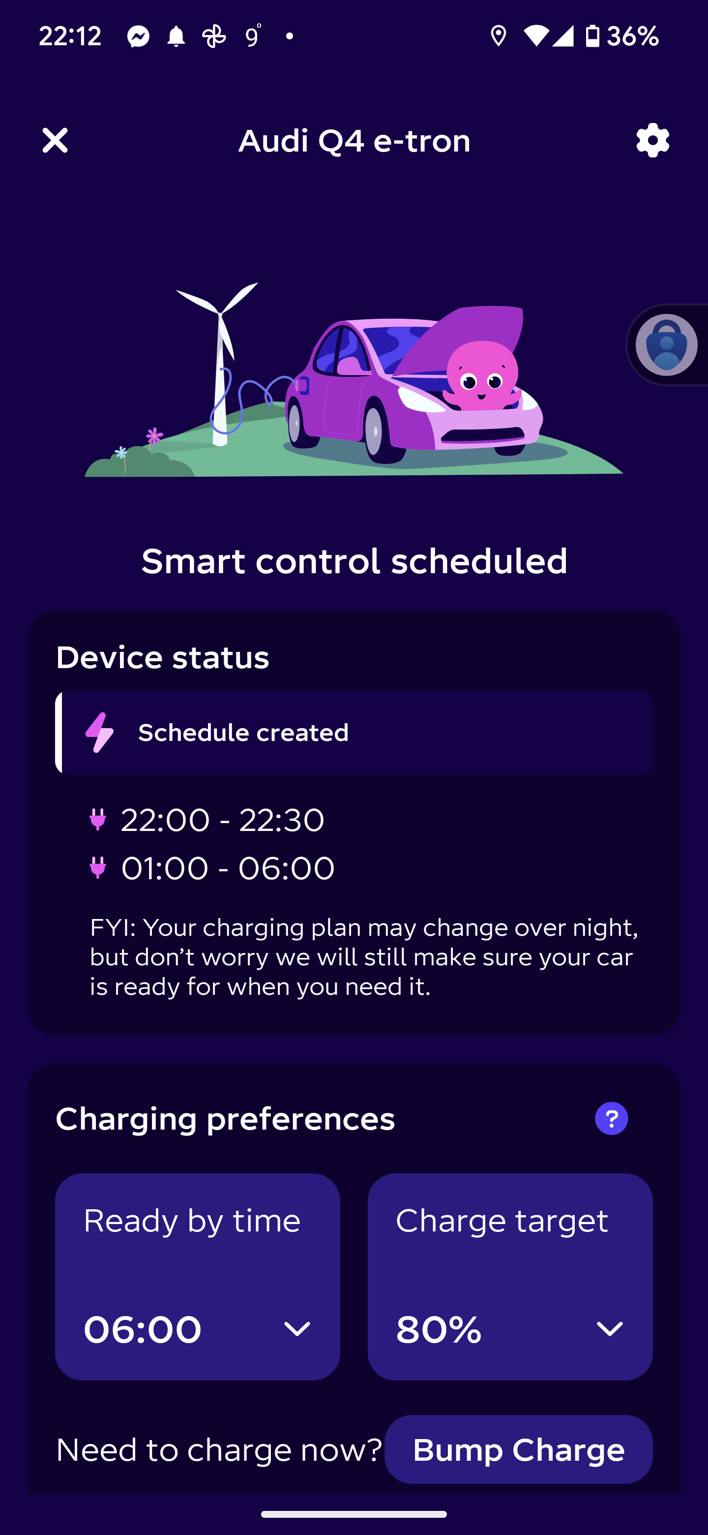

  7. At 22.12 The octopus schedule had changed again 22.00-22.30, 01.00-06.00

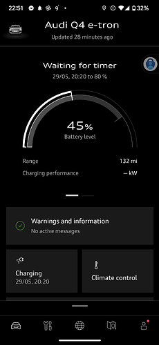

  8. At 22.14 I noticed the MYAudi app timer slider was off - this could only be changed by Octopus? The car stopped charging at 22.30

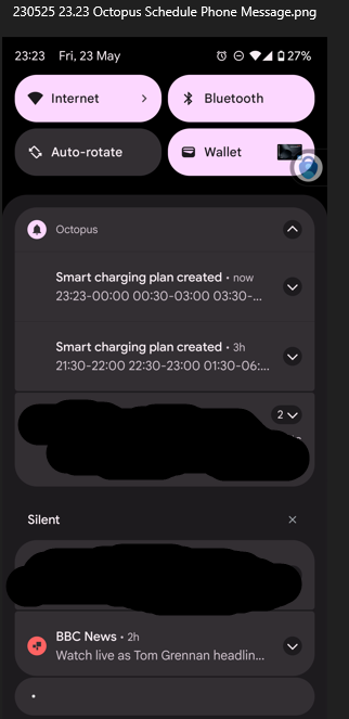

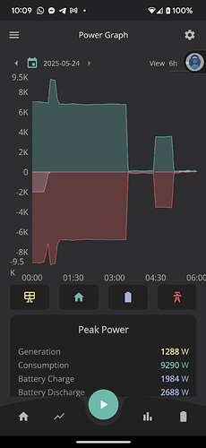

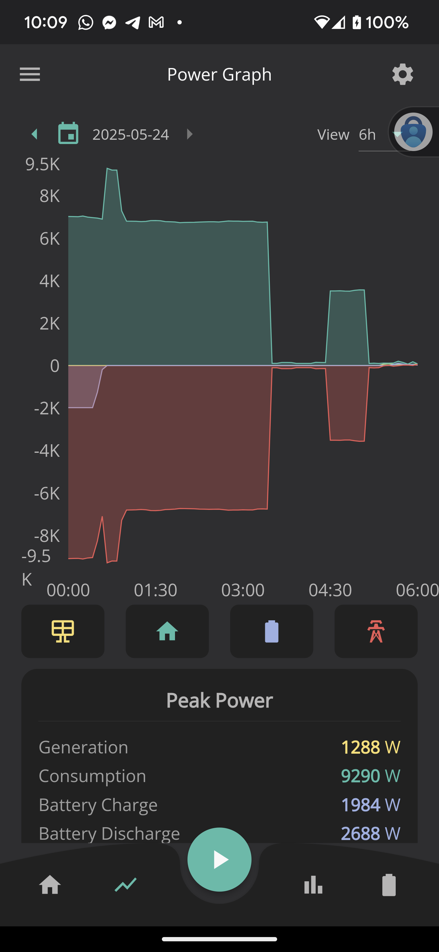

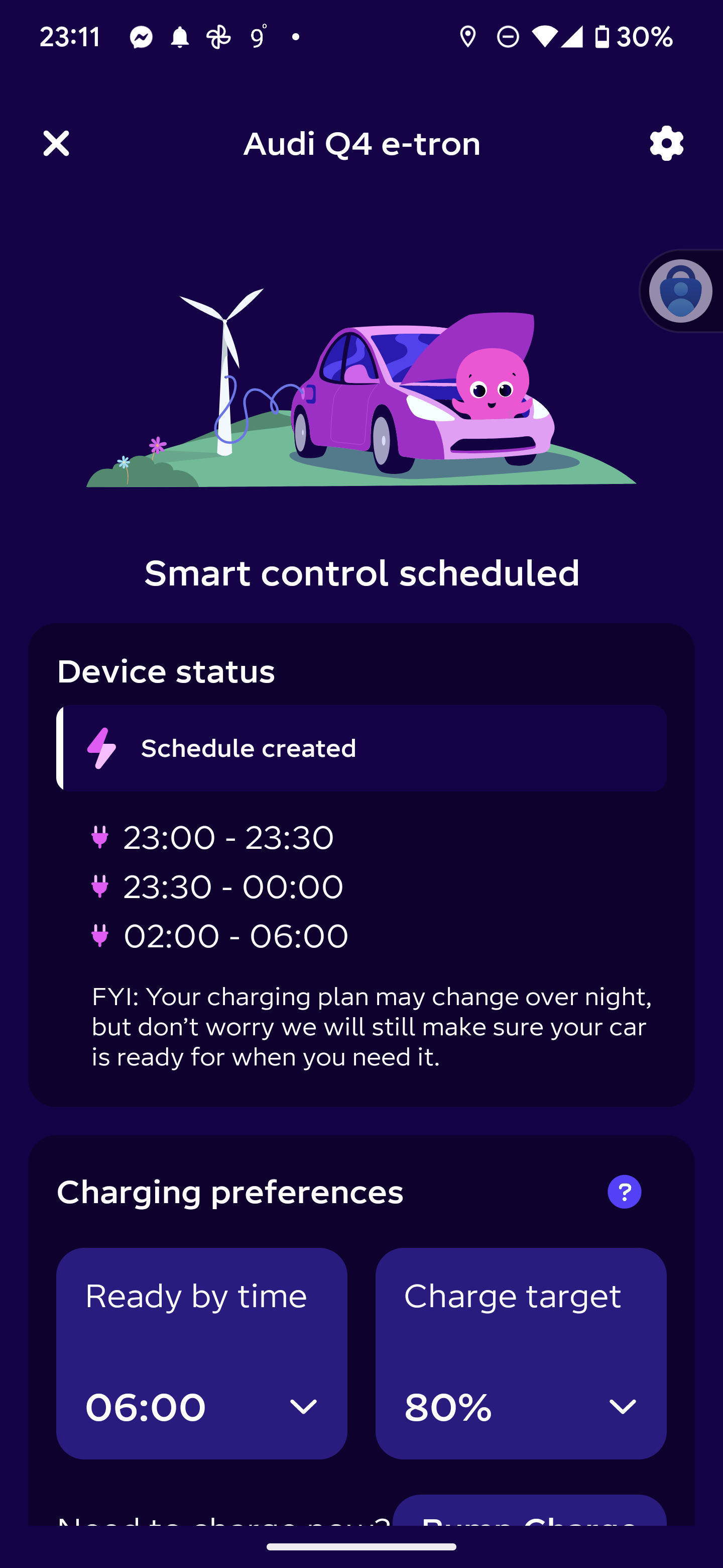

  9. At 23.11 the Octopus Schedule had changed again 23.00-23.30, 23.30-00.00, 02.00-06.00. The car did start charging again at 23.00 and on trend you can see this, but car continued to charge until about 03.00 with no breaks when it reached 80% target.

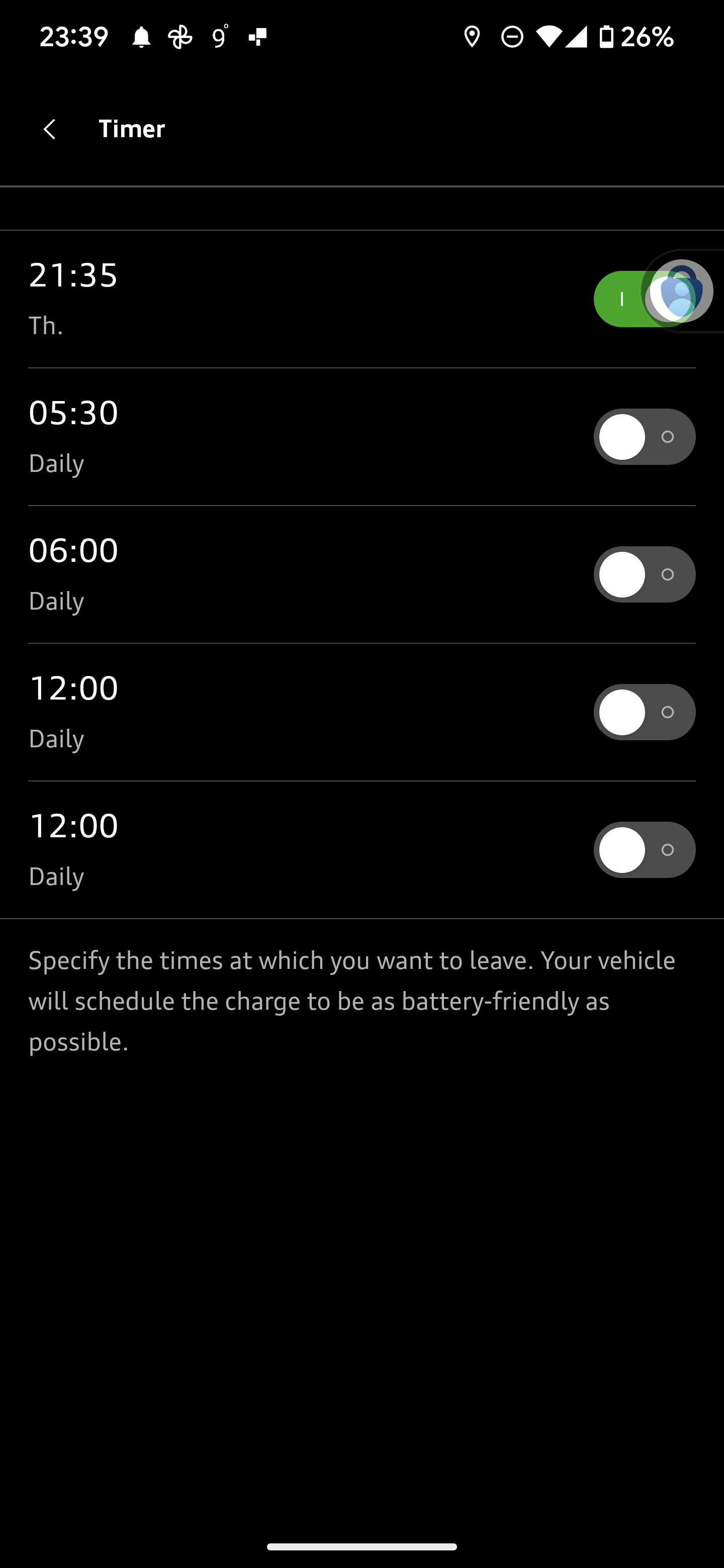

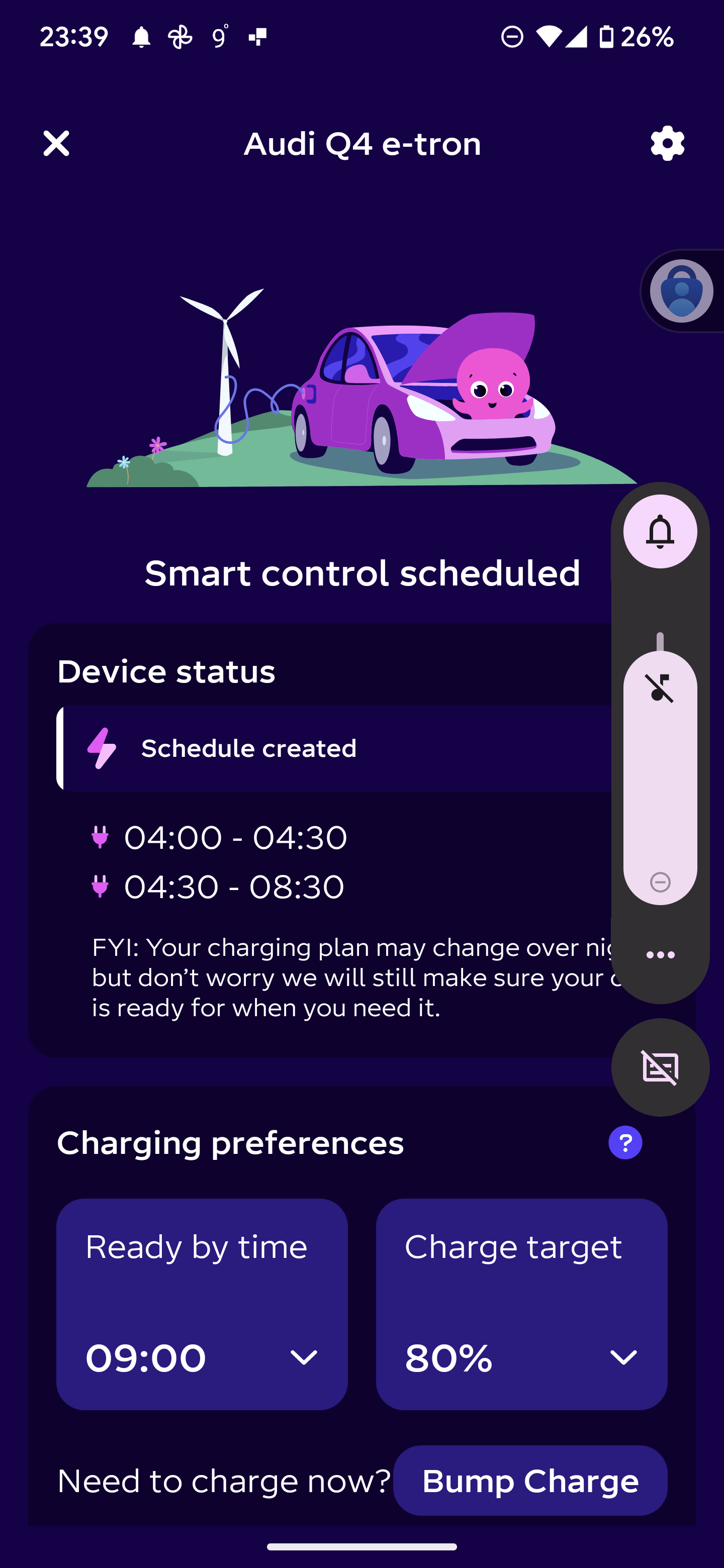

  10. At 23.23 my phone again showed a new charging schedule 23.23-00.00, 00.30-03.00 etc so was changing all the time, 23.39 looked at phone and schedule was 04.00-04.30, 04.30 to 08.30, noticed at this time MyAUdi app timer was changed to 21.35 Thu

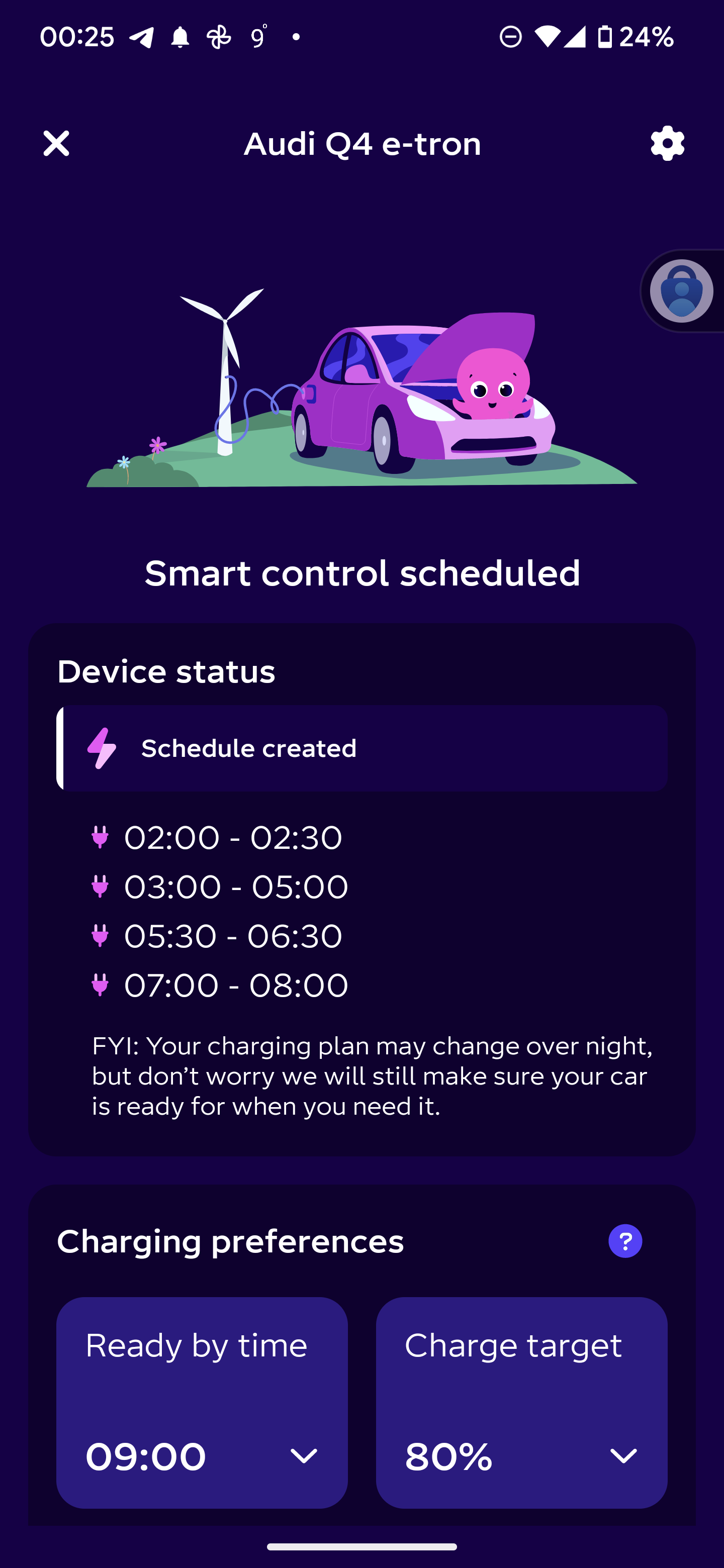

  11. At 00.25 as I headed to bed, Octopus schedule had changed again, 02.00-02.30, 03.00-05.00, 05.30-06.30, 07.00-08.00

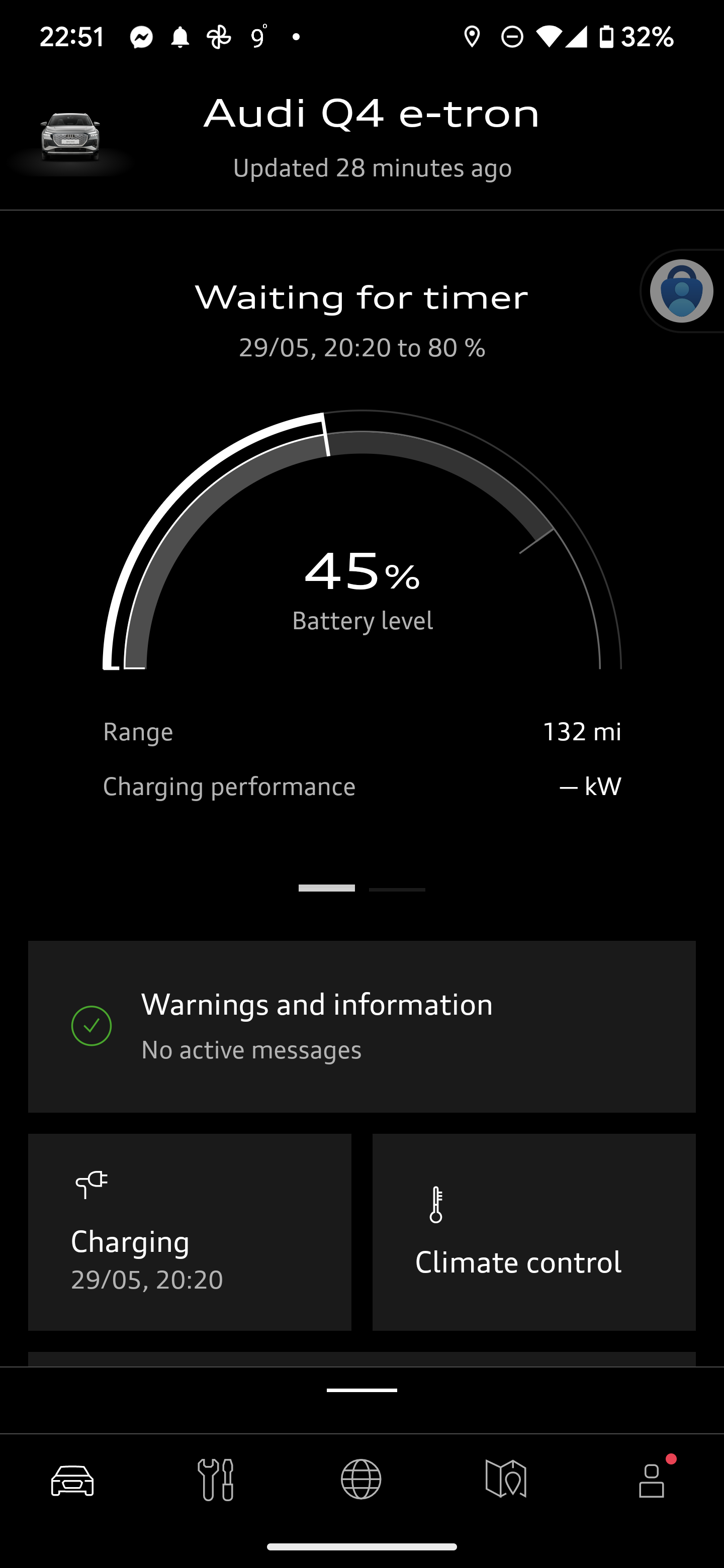

    Lots of screenshots below - have to upload 5 at a time
    More screenshots - hope this post looks alright
    More Screenshots

Next charge I will try Grid only setting to see if it does not drain solar battery - y battery is set to charge at 23.30 to 05.30 the fixed cheap period.
