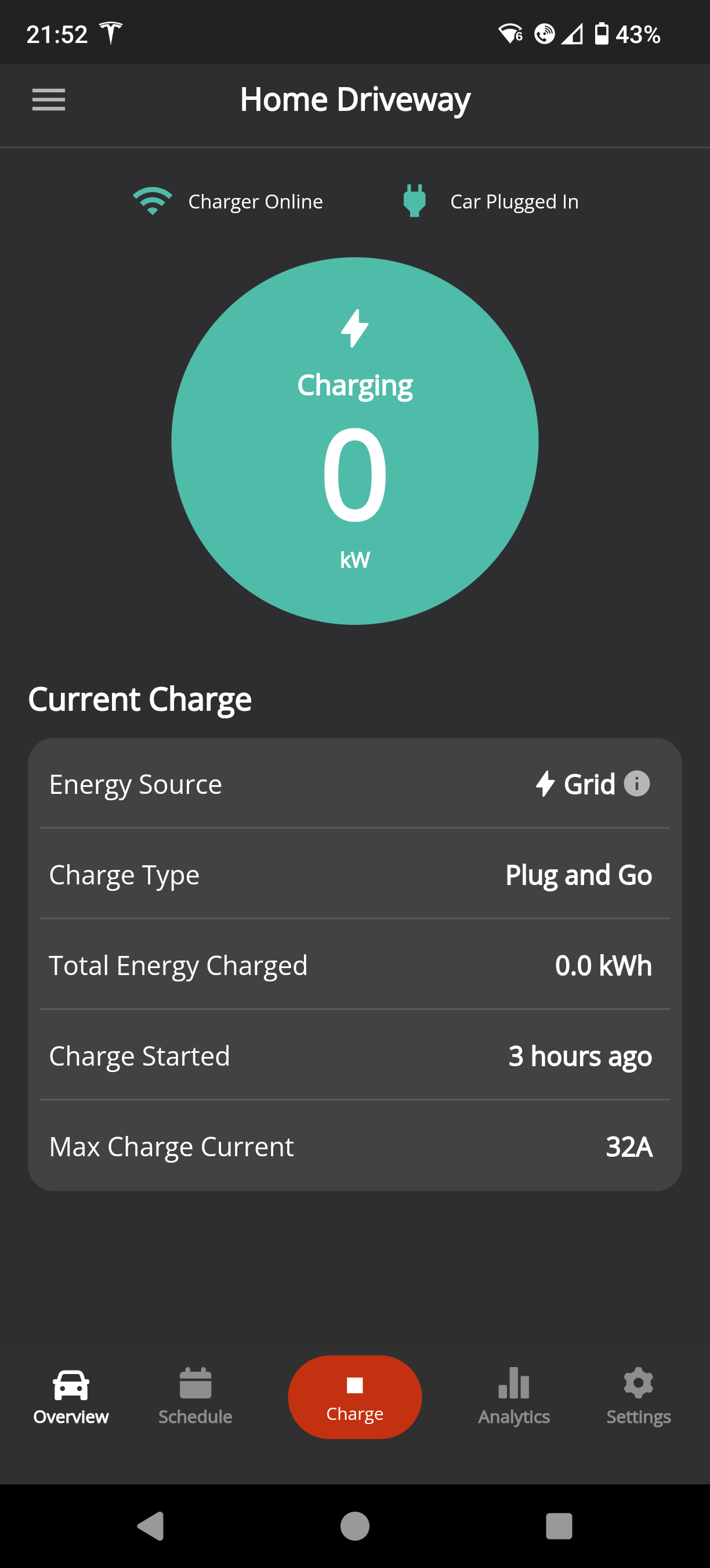

Plug in car, get white flashing light the get red technical error. But this is before Octopus “preparing your juice” message comes up in Octopus app. Once Octopus app sees car is plugged in, unlock car and remove and replace cable and charge light starts flashing green and car starts charging at scheduled time.
However on the 3 times I have tried this, always get a message from Octopus app saying unable to control your device, and Octopus cannot stop and start charging as per the smart schedule, which appears shortly after the smart charging enabled status. The car simply keeps charging until target level is reached. Downside here is if charging starting way before 23.30 I have had periods charging at full price instead of off-peak.

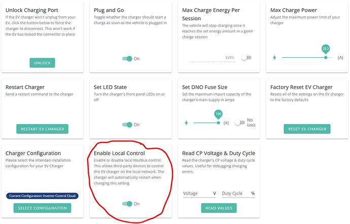

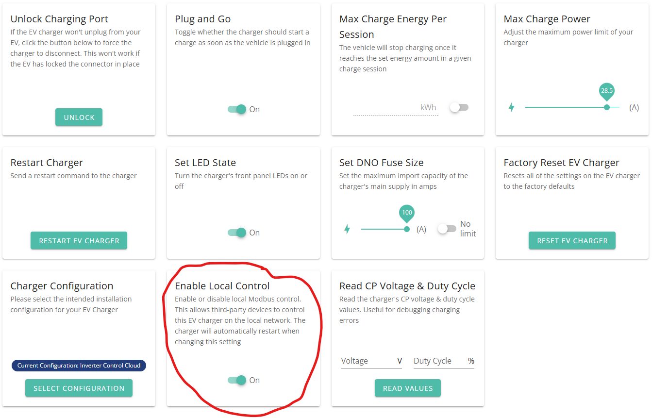

Now - I have only been using the mobile phone app to control the EV charger. Last night i the hunt to see if there were any EV charger error messages (as mu charger sometimes shows offline like others) I found a button not on the mobile app, under Other settings.
When this is changed you need to reboot the charger - although it says it does this automatically - but I keep getting timeouts when trying from my PC in house.
Next time I smart charge I intend to try it with this button set to On. This enables third party devices to control the EV charger on the local network. Will be a few days until I need charge. Will post back results.
You say it’s not in the mobile app, but where did you find those settings? My givenergy.cloud doesn’t even show my EV Charger at all, but the interface you screenshotted looks like it could be in there?

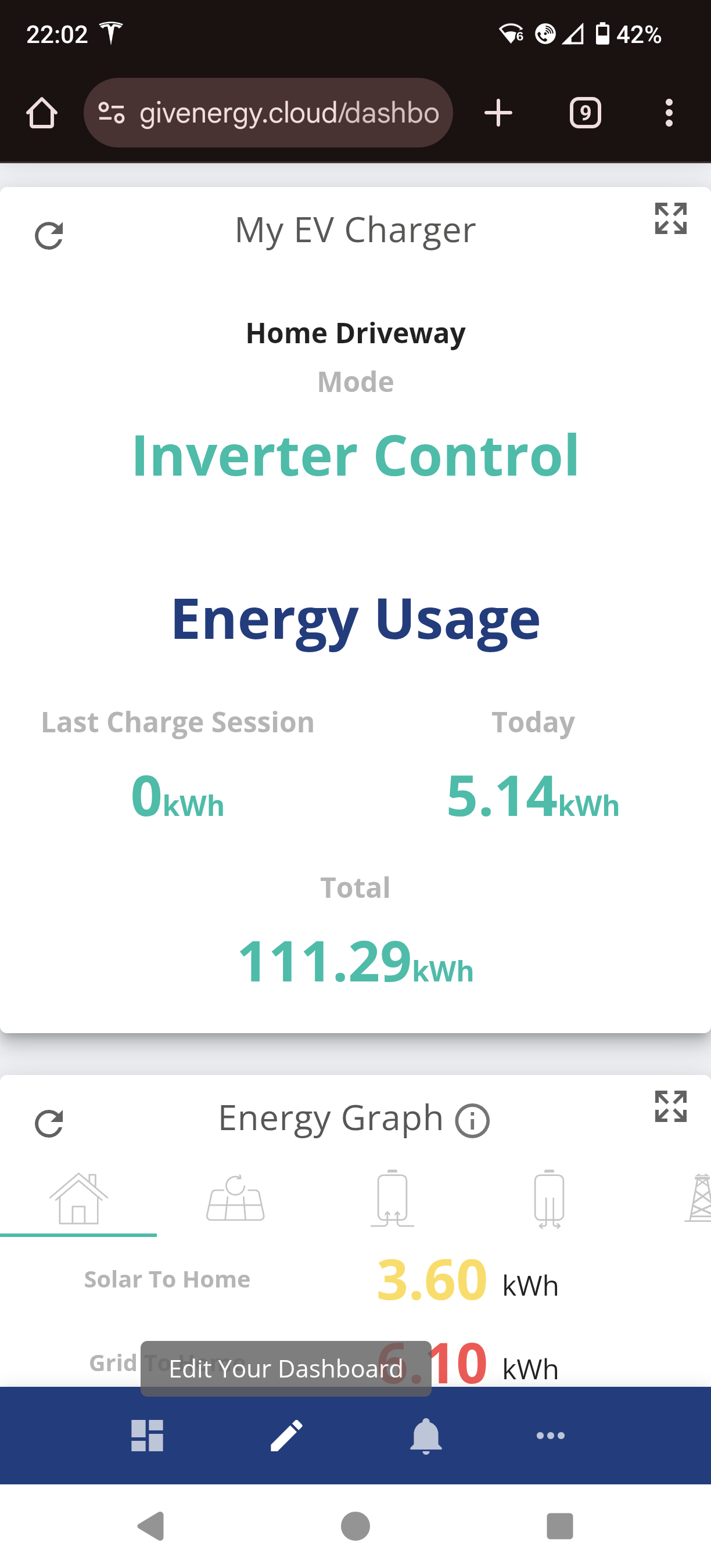

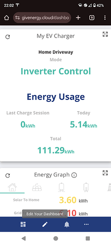

Hey bootc. It took me a while to find these settings but if you go on the web dashboard you have an EV charger dashboard card you can click the 4 arrows in the top right to expand this card and see these settings.
You might need to edit your dashboard and add the card if you can’t see it.
Thanks! Wow, I would have never found that.
