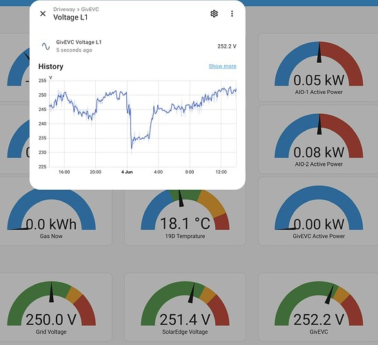

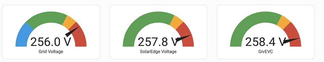

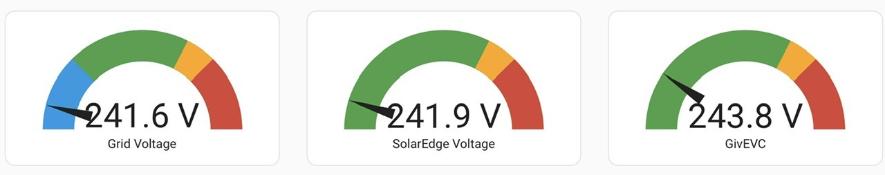

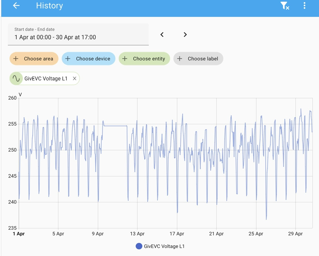

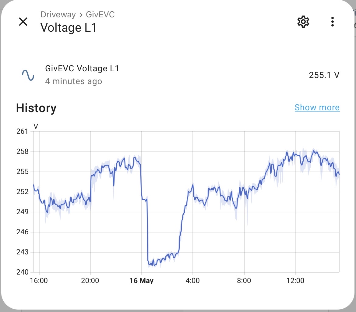

Just had a look and this is what it is now, I will keep an eye on it for a few days.
THanks for updatating Dave. I am getting the same error regularly. Installer says it’s DNO’s job, as I am going over that 253 value.

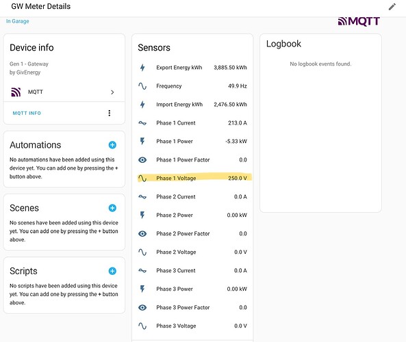

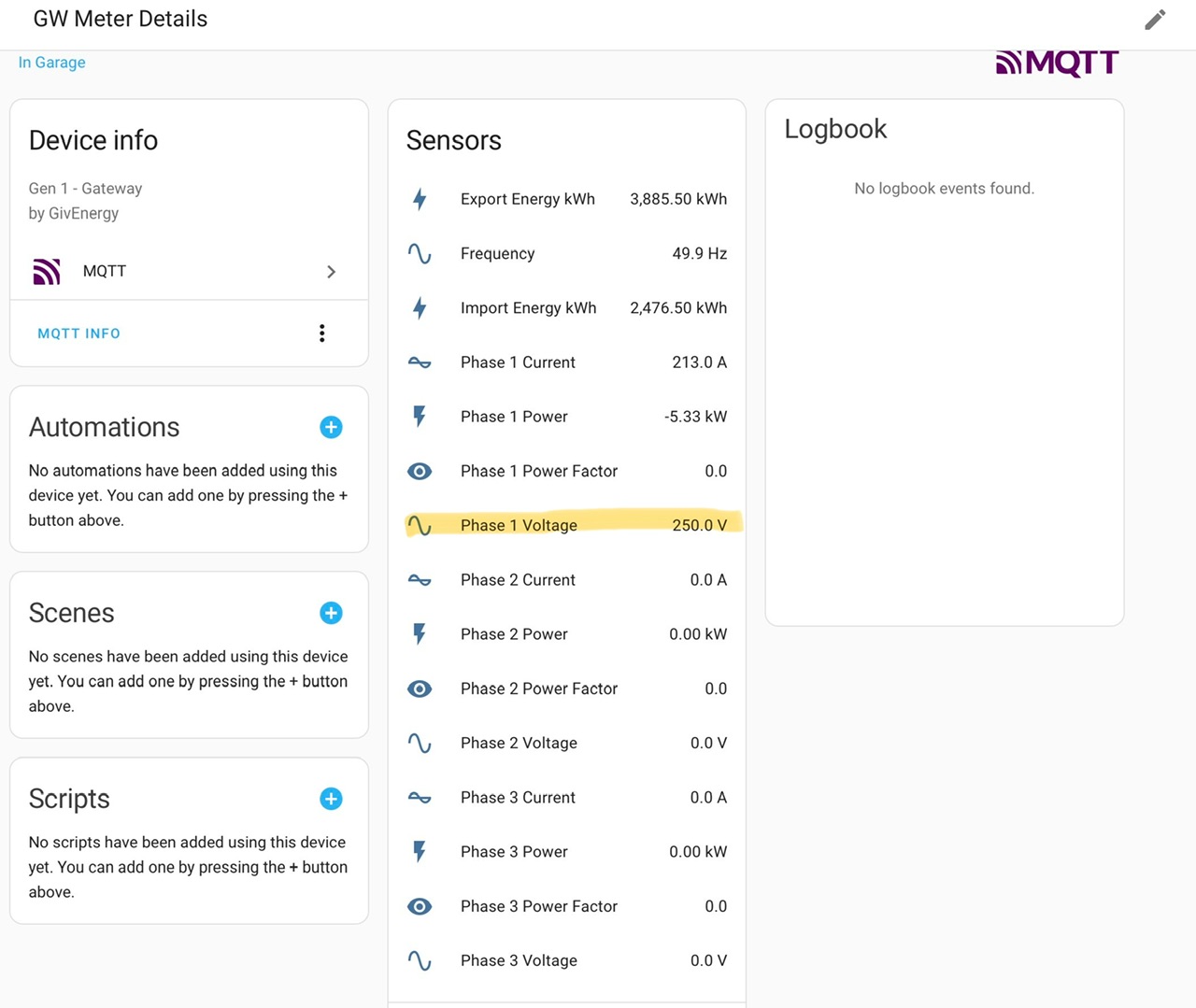

How are you monitoring the voltages that you’ve screenshotted?
Hi yah,

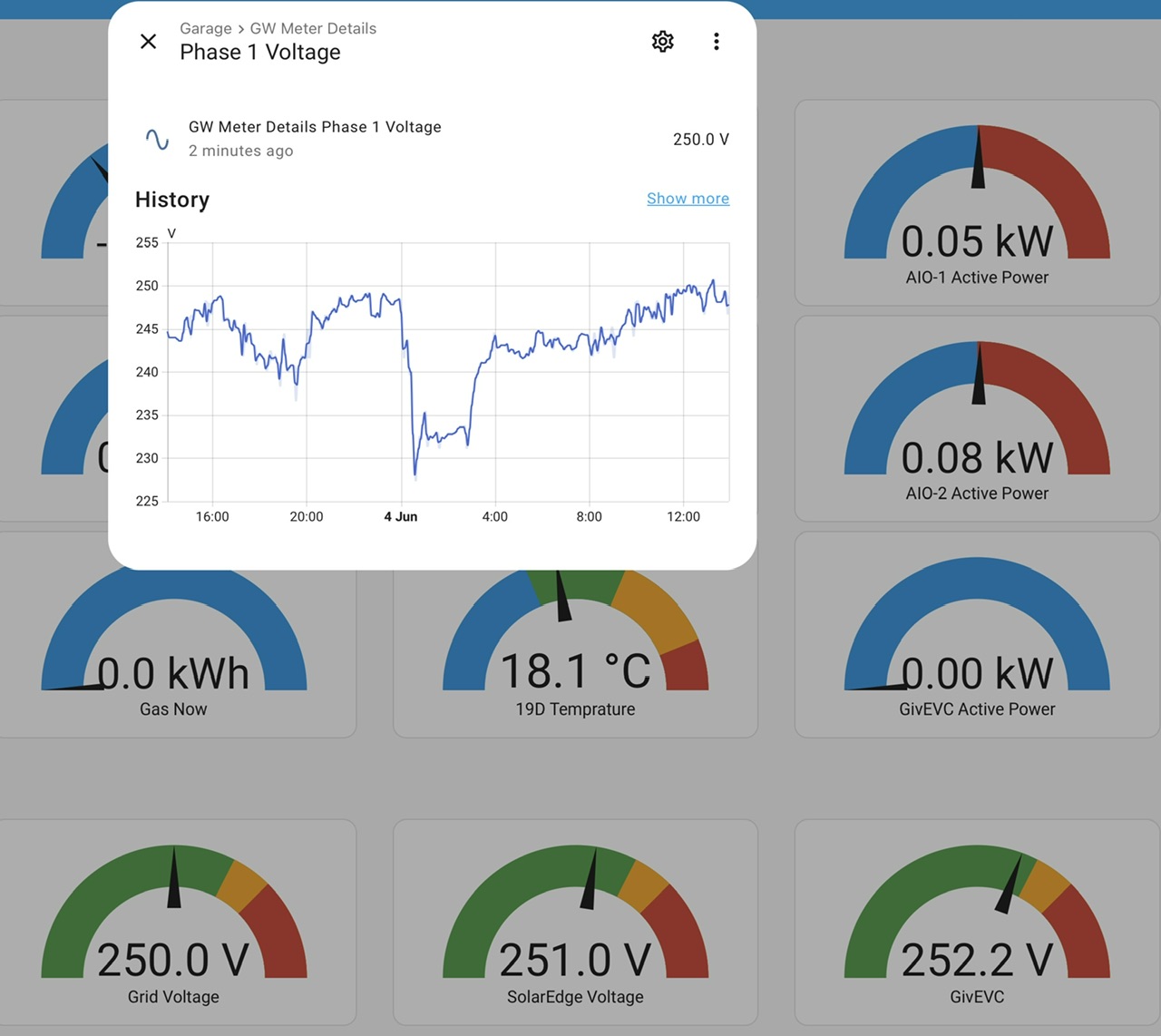

I have a Gateway and 2 x AIO’s. The GW has CT clamps, so using these readings in MQTT.

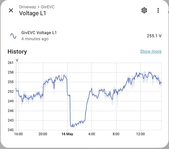

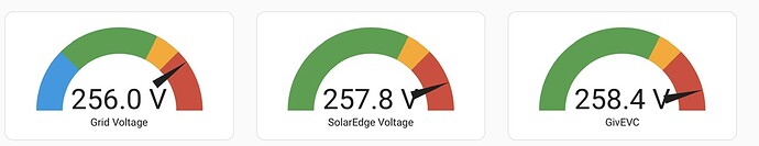

You will need some evidence like mine above (I used the graphs and sensors from HA). The engineer did the tests from the local sub station and could read my meter remotely to see it was to high on sunny days.
