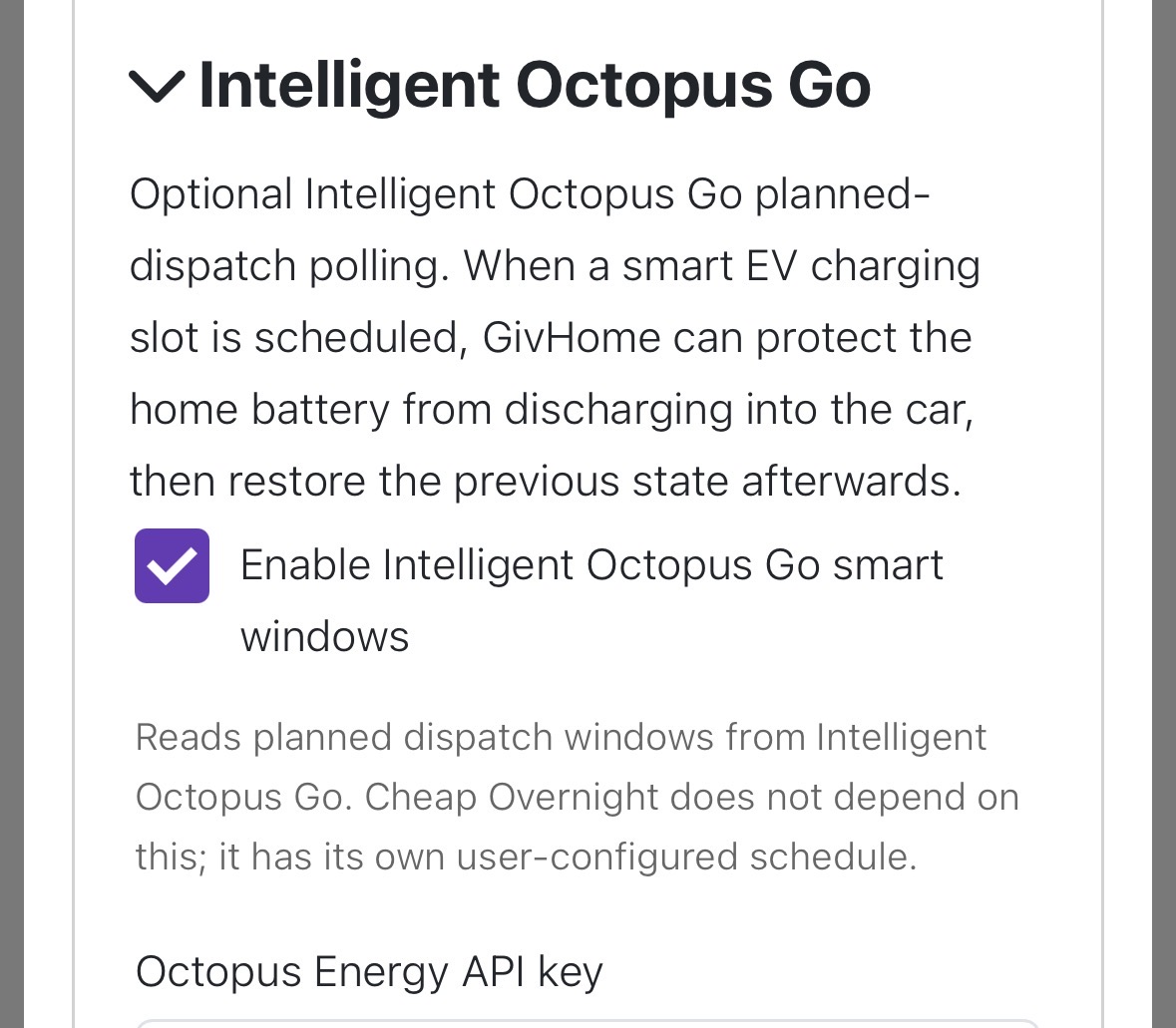

If you are prepared to split your Pi (assuming that is where you are running HA?) the Homebridge variant of GivHome was designed to solve this problem for Intelligent Octopus Go tariff (the most popular EV tariff by some margin).
Put simply when the EV is plugged in Octopus sees the car and dispatches charging slots. Homebridge-GivHome reacts to those slots automatically pausing your GivEnergy battery discharge.. your EV and home benefit from the cheap grid energy.
Whilst it is designed f to provide Tiles in Apple Home, there is nothing to prevent you from using the tool headlessly for your single requirement
