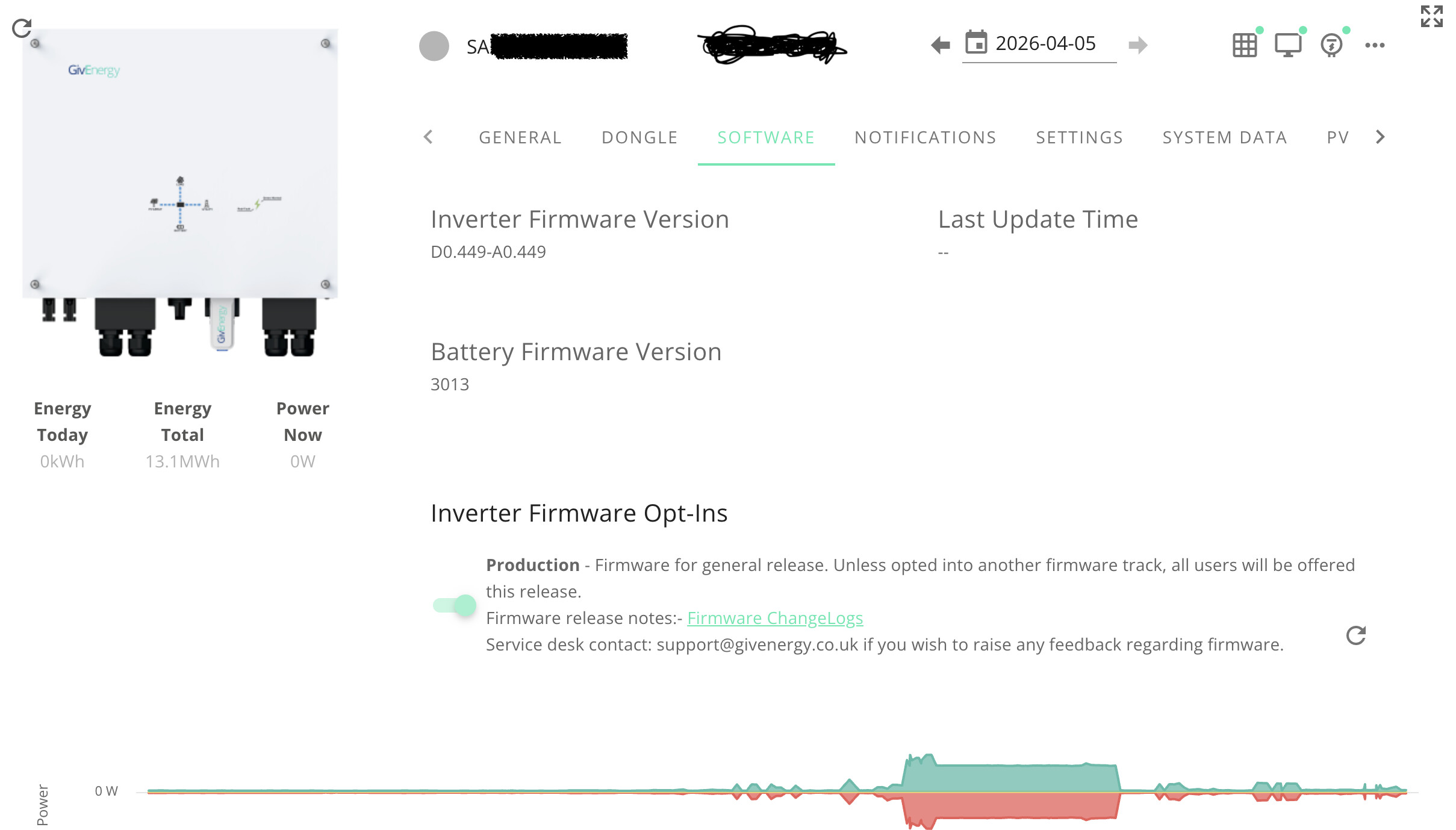

I’m hoping someone here can help, as I’m currently getting nowhere with support.
System details:
  • Inverter Serial No.: SAxxxx
  • Inverter: GIV-HY3.6
  • Inverter Firmware: D0.449-A0.449
  • Battery Serial No.: BExxxx
  • Battery Firmware: 3013

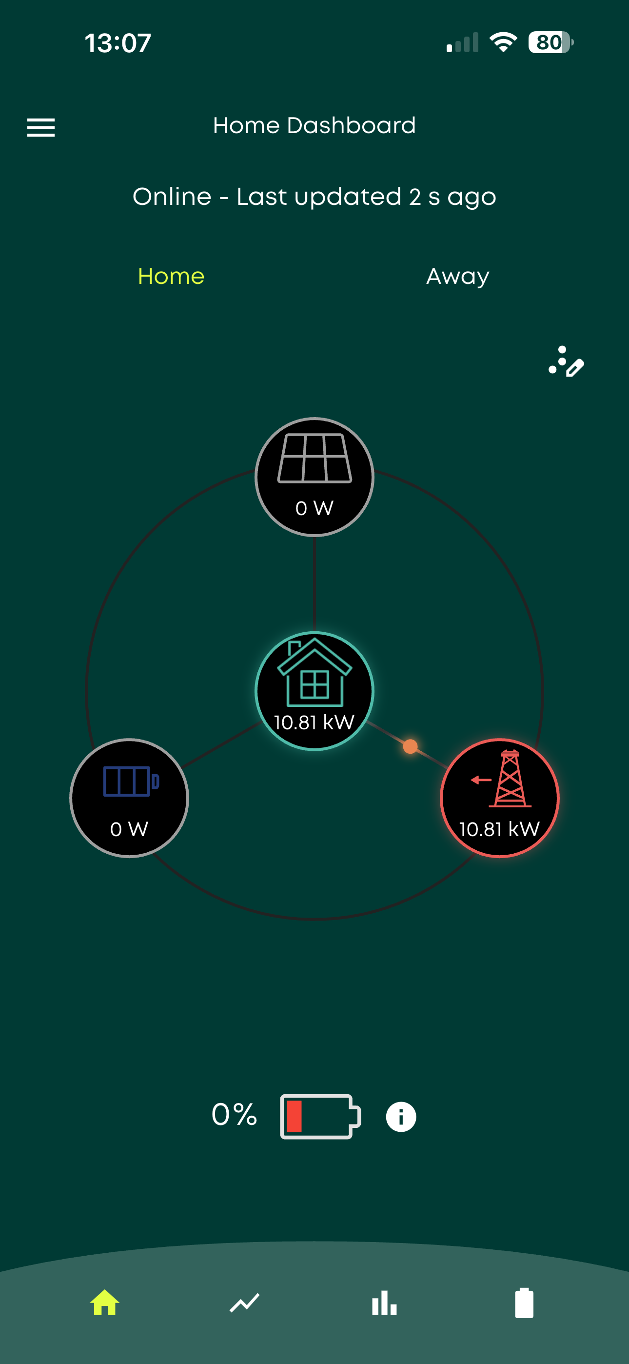

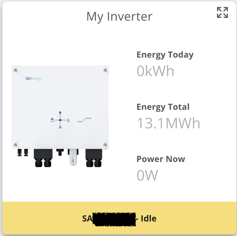

Issue:
  • Battery is stuck at 0%
  • No generation showing from solar panels
  • House is drawing 100% from the grid
  • Inverter showing as idle!
What I’ve tried so far:
  • I’ve tried to update the firmware from the portal many times, but at the end of it, I get a notification
  • "The firmware update running on SAxxx has failed. You can start it again on the inverter card."
  • Checked app/dashboard (no useful errors shown)
  • Contacted support (no response yet)
  • Restarted system (no change)

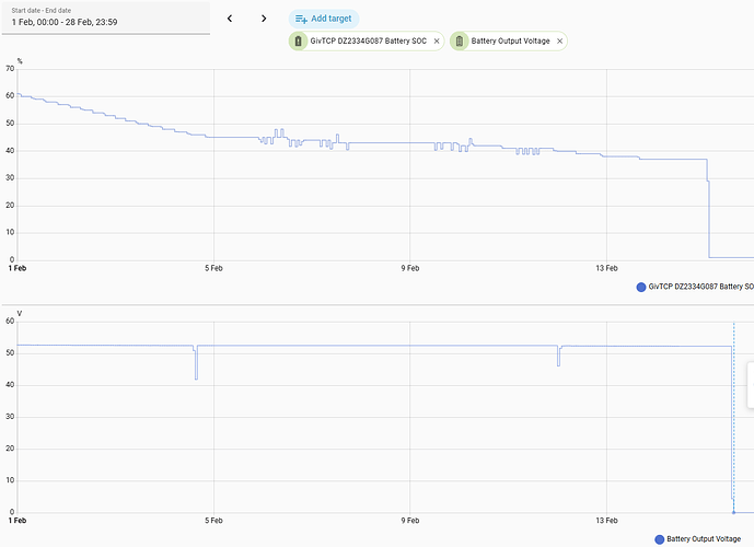

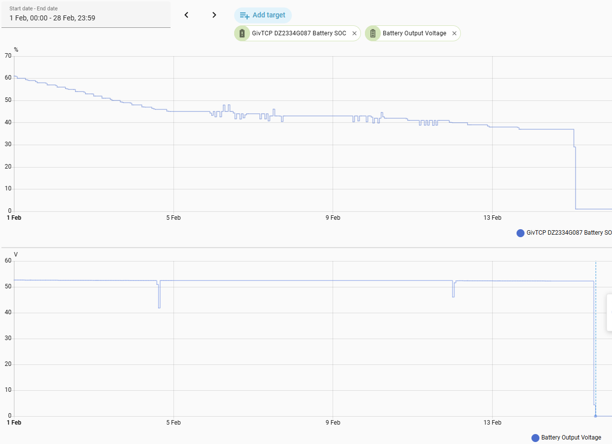

I’ve just turned my battery on briefly as it’s been tuurned off since mid Feb waiting on a new inverter and I didn’t want it to parasitically drain.
It dropped from 37% to 1% in an instant after dropping from 62% to 37% over 4 weeks.
Voltage still claims to be 52.6V
