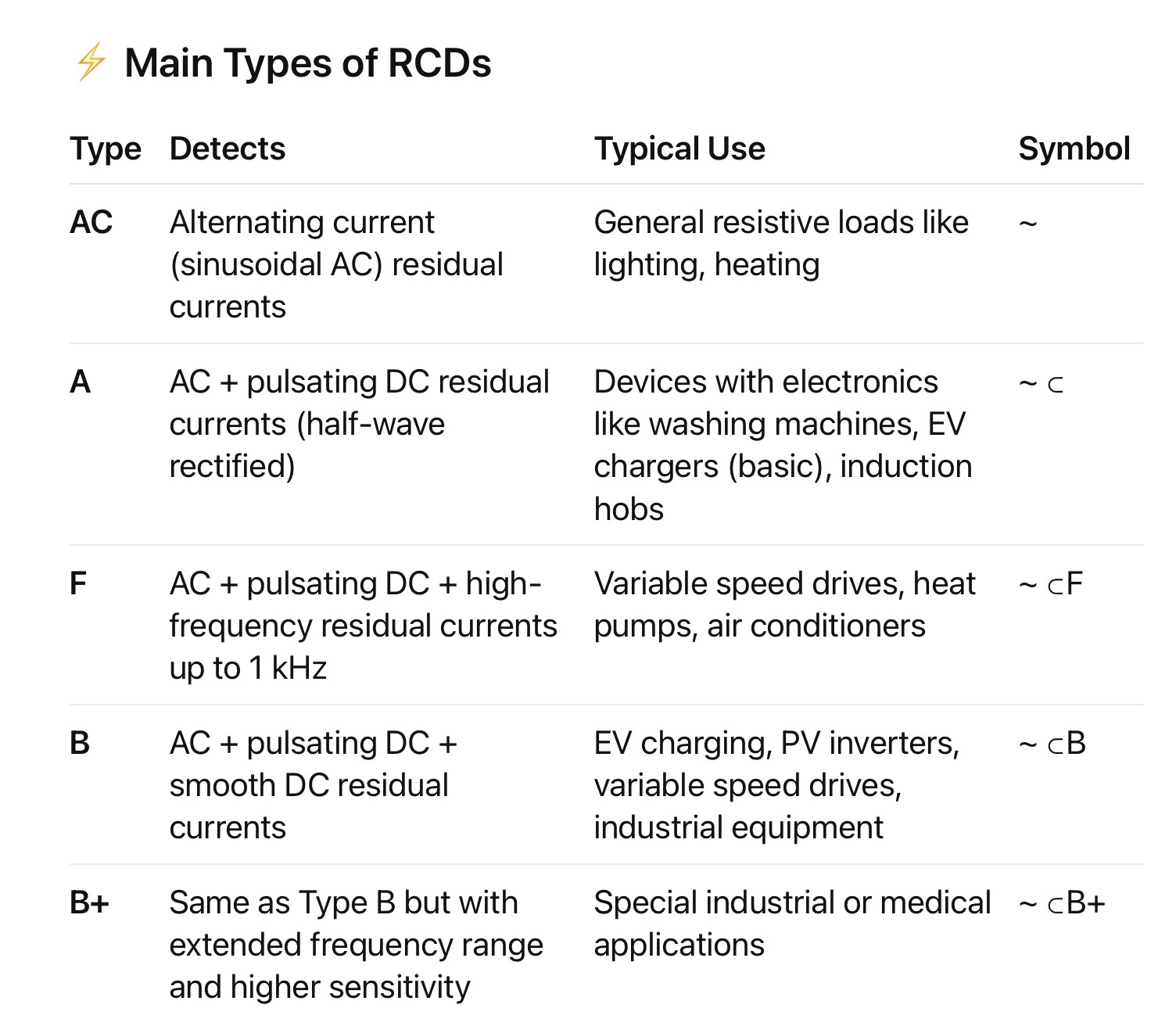

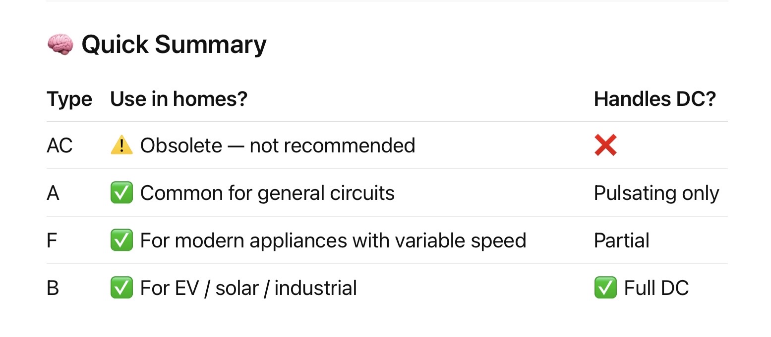

Hi yah, lots of people have had issues with RCD’s myself including. I asked my installer and he said he only uses RCBO’s now type A. It maybe worth looking at changing the RCD that looks after the PV and just change that one?
I would also do some research on the type of RCD’s you have?

I had MCB’s in my fusebox controlled with an RCD and would get occasional trips as well.
I have had the entire fusebox replaced and the MCB’s swapped for Crabtree Starbreaker Type A RCBO’s. Not had a single false trip since then
