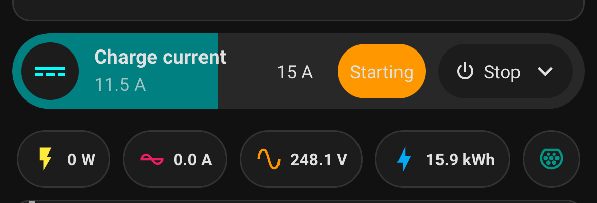

I then have to power restart the EVC to recover from this error (restarting the addon also doesn’t clear the error). I’m not sure if this has something to do with the command queue size perhaps? I have a slider that would update the current limit real-time, and the 3rd command seem to fail.
  1. GivTPC only deals with integer currents, while through the GivEnergy app I can set the charge current with 0.5 accuracy.
  2. Setting “plug and go” through GivTPC get overwritten by the cloud app’s current settings
Is this something you can help me with, @MarkC? Let me know if you need more info
