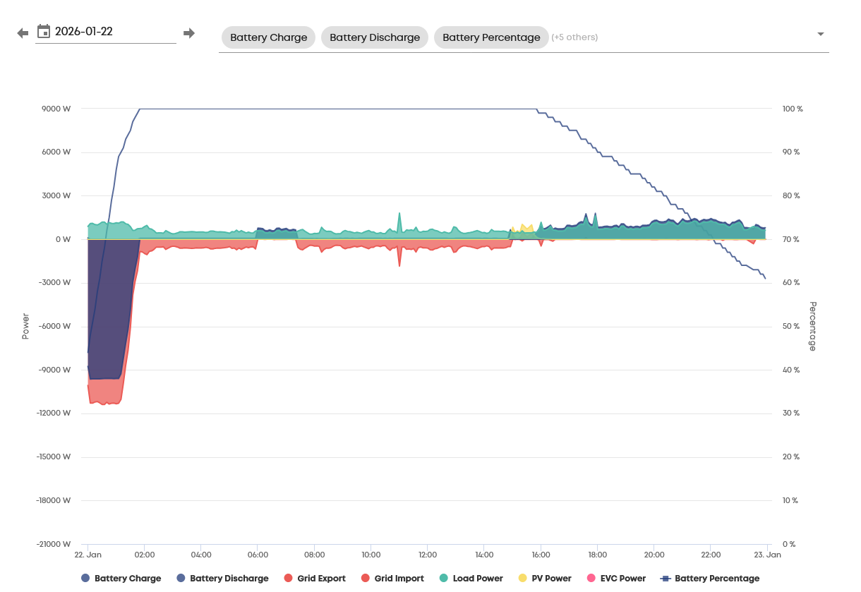

Grid energy used yesterday 22/01/26 when battery was FULL and in Eco mode.
Grid power used between 0745am and 16:30pm then reverted to battery.

Battery was completely FULL charged overnight.

L1 Voltage FaultS ON 16-19-21/01/26 BUT NO FAULTS ON 22/01/26 when the inverter stopped providing battery power when batteries were full.

Problem was that the system remained in Grid Power for a long time over 10 hours before resetting on 22/01/2026 with no system fault or error.
Shouldnt resyncing be automatic not leving system full outage for most of the day.

I have now had 7 x L1 Voltage Faults reported, but Fault Message does not contain vital information on what actually is triggering these faults. They are becoming a daily event with randon timings. One of these caused a full battery outage for over 9 hours, with no associated system message, just an initial voltage fault.
