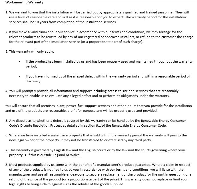

Do you have a handover pack from your installer? You could check to see how long they support your system is mentioned in the pack.
In mine the installer will support the system for two years. This is backed by an insurance, in case they go out of business. It also states I should contact them in the first instance, if there are any equipment failures and they will handle the warranty claims within the first five years.
This is all I can find in the handover pack that may be applicable, and an IWA insurance cert in case the installing company fails
