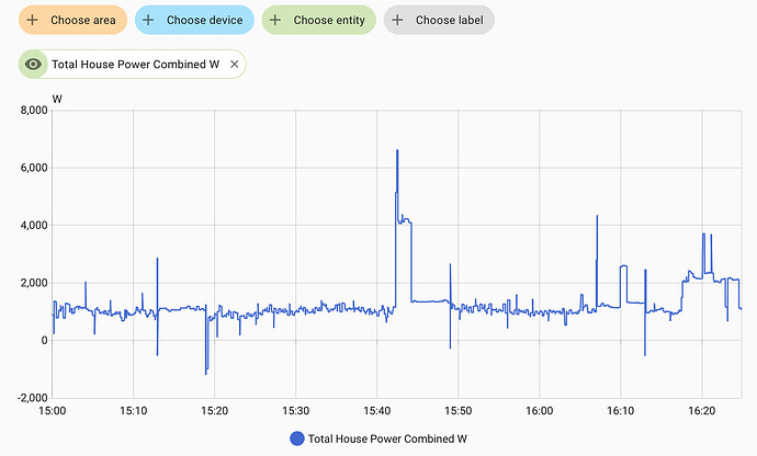

That’s ok if a 5 minutes resolution is all that is required. The OP asked for a sensor that always shows the correct actual load. The sensor I suggested does this (including logging of power surges and dips). See the attached data captured a few minutes ago for example. Your suggestion would completely miss the 7kW surge (cooker).
If it will only be used for hourly data figures, then I agree that some form of data resolution limiting could be applied as per your suggestion. Horses for courses.
