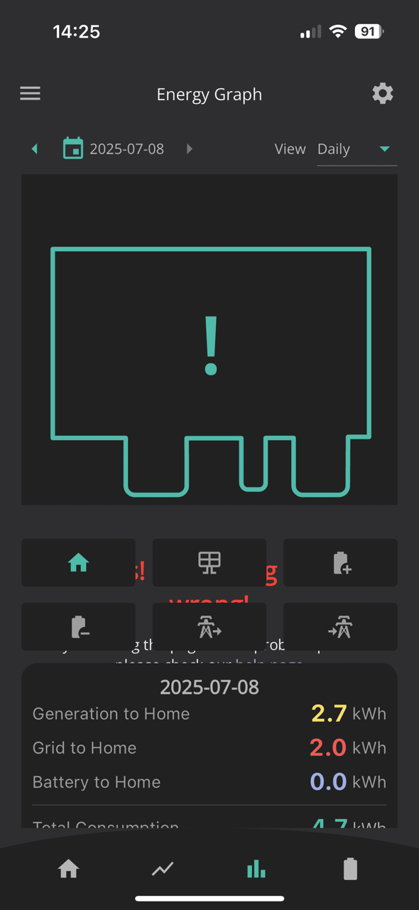

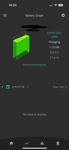

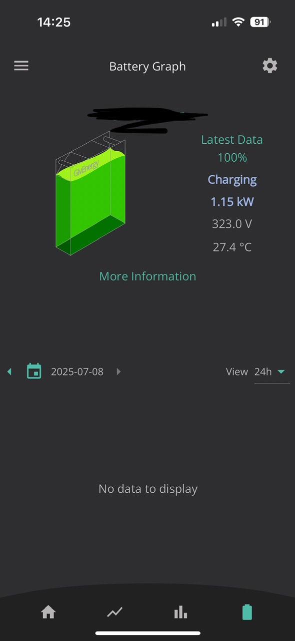

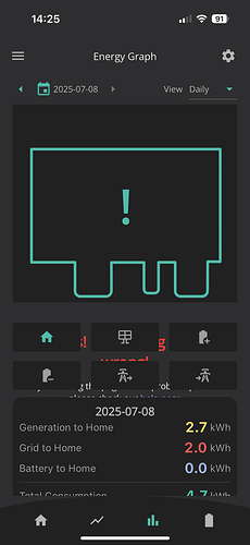

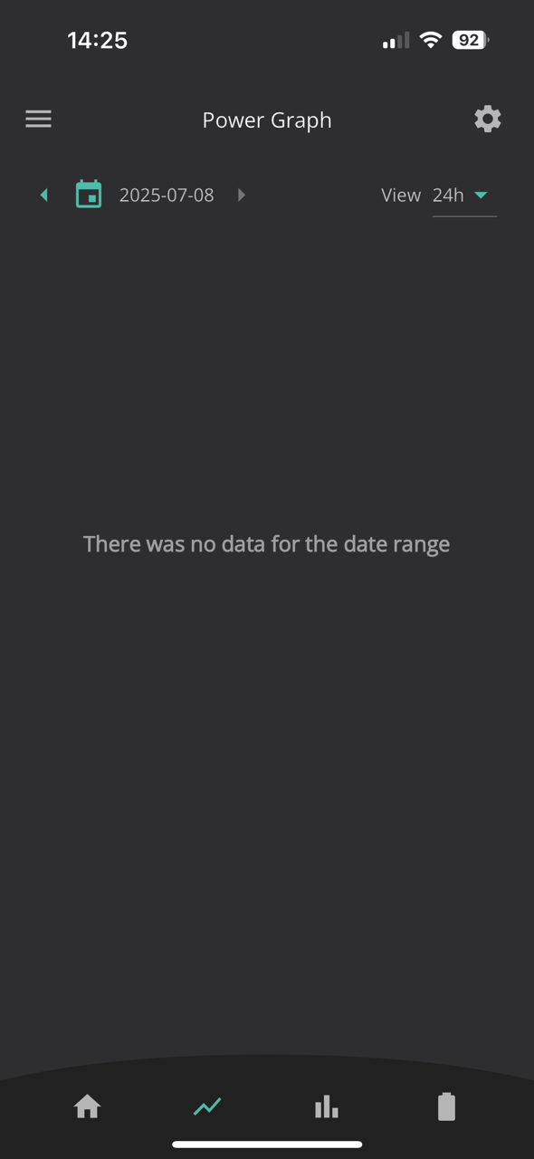

Home dashboard on android and iphone apps has stopped working overnight. I am able to see data on giv energy cloud dashboard. Server glitch?

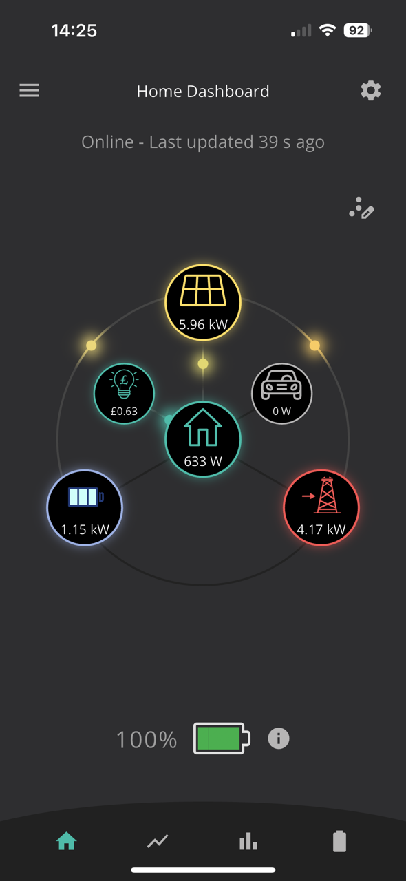

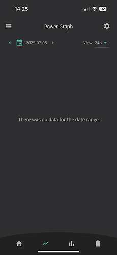

Hi all, this has happened again with the latest update? Anyone else getti/ng the same?
I have 2 x AIO so maybe just an issue with that configuration?
I have 2 AIO’s and a Gateway and have never had the Home - Away option that others show on here. My App look exactly the same as yours.
