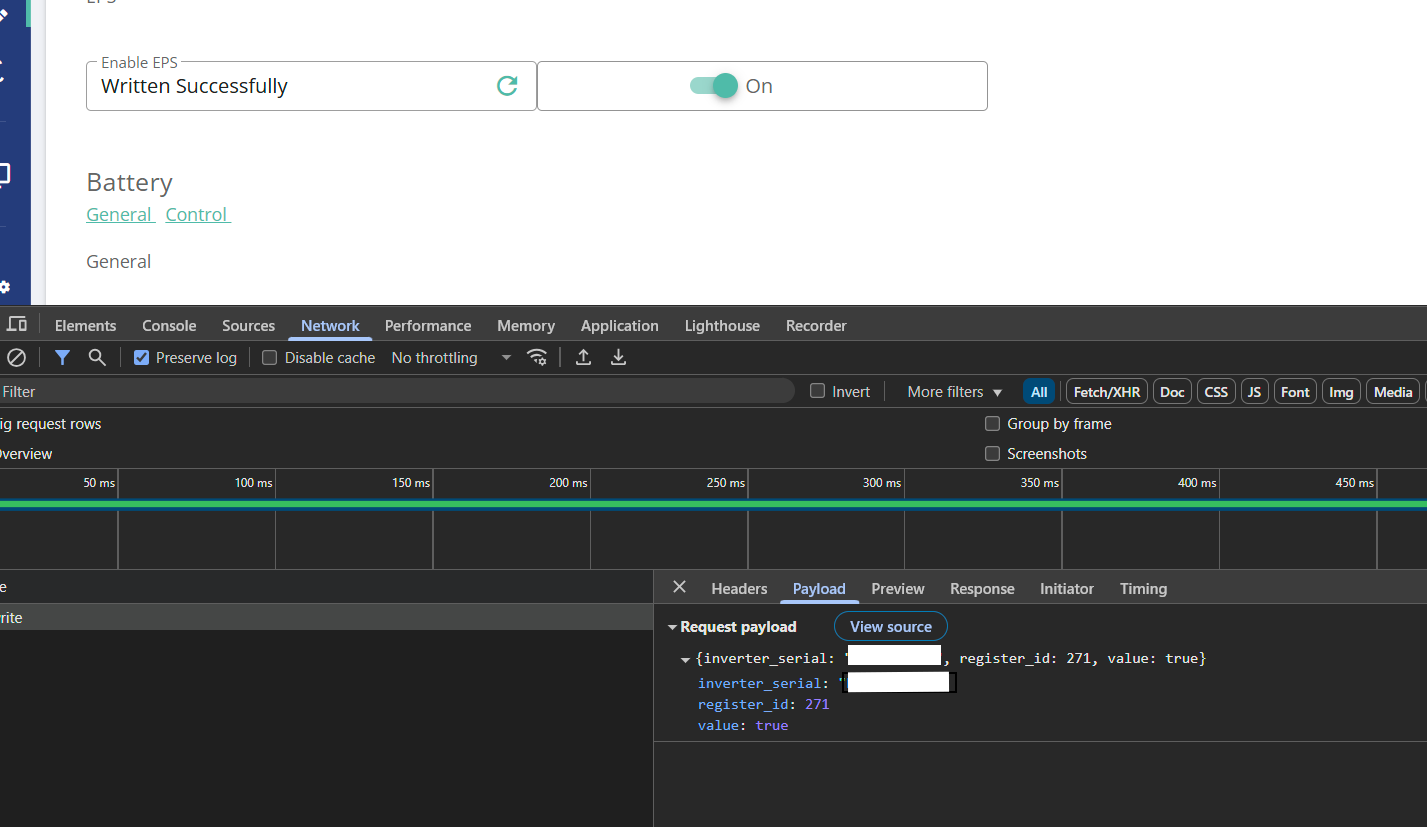

I’m sure they are listed somewhere, but if you can’t find them in the API documentation, you can go to givenergy.cloud/remote-control with developer console in your browser open, perform the actions and see the output.
Does this help?
Thanks @rjn368 and @TX200 - these didn’t directly solve my problem but helped me join a few other dots to get the solution :slightly_smiling_face:
