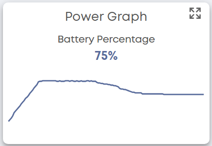

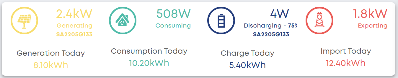

Currently exporting generation even though battery is at 75%:

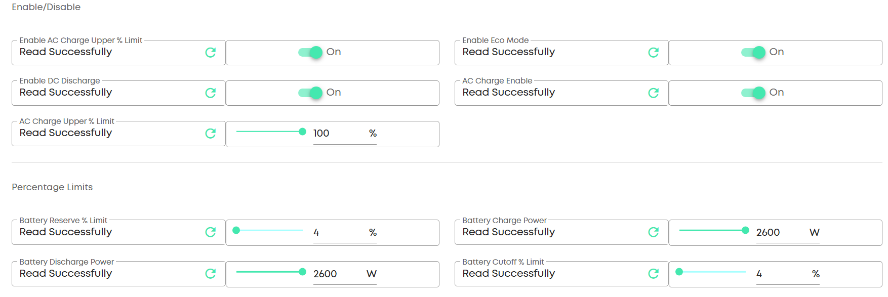

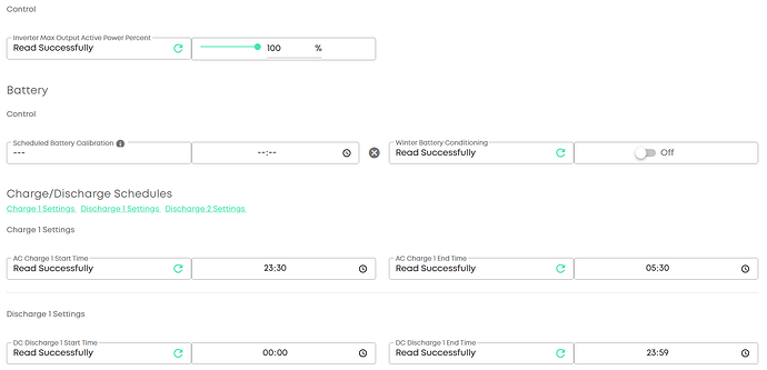

Inverter settings:

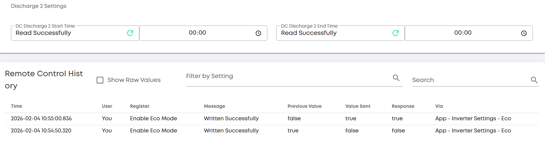

Log where I turned Eco on and off earlier.

You have Enable DC Discharge = On, combined with Discharge 1 Start/Stop Times = 0000 to 2359.
On mine the Enable DC Discharge = Off, which then ignores the Start/Stop Times, and just operates in ECO Mode outside the AC Charge times.

you also don’t need ‘enable AC charge limit’ turning on, although as the limit is 100% that won’t cause a problem, but you can turn it off
if your battery is in an area where it can get too cold then worth turning winter battery conditioning on
